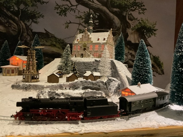

Hey All,
After promising my better half for years that I would build a little xmas layout, I'm finally doing it!. I had a small 2'x2' board I'd built as a woodworking practice thing a while ago and decided to use that.
Its just a small Kato loop that I intend to either use my Koln tram on or a short steam loco and coaches.  What we really wanted was a small market to remind us of our visit to Koln and other markets in the UK, she gave me a big hint last year with a set of stalls from DM-Toys, and followed up this year with a xmas windmill thing.

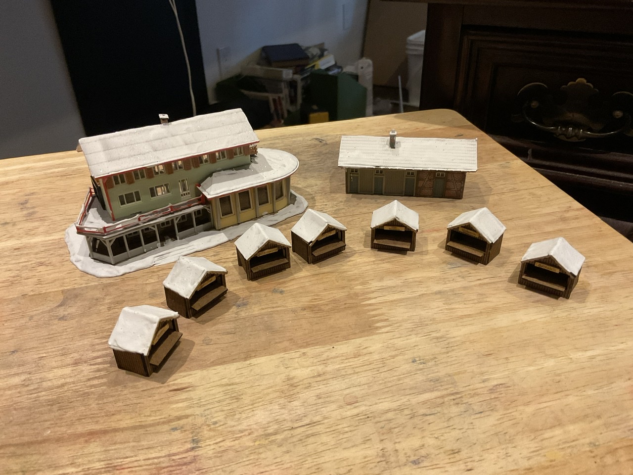

I've made quite a bit of progress, and last night I tried making snow with Dave Frary's 'snow goop' recipe and I have to say it works great!.  Its equal parts Titanium white acrylic, modelling paste and gloss medium with a drop of Cerulean blue.  Mix until its like Mayonaisse then splotch it on.  I've done some buildings and then sprinkled on a little glitter.  I'm going to do the rest of the layout hopefully later today once the white basecoat dries.  Here's progress so far
Base Layout (in progress)
Market and buildings

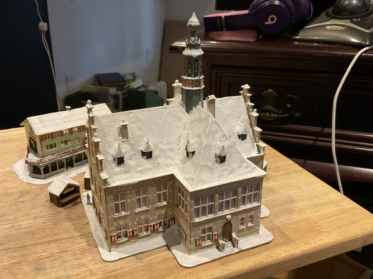

Main Building
Looking good so far. Maybe a bit more snow on the rooves? Loft insulation these days means colder tiles etc.

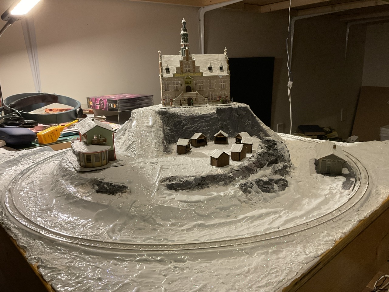

Small update..
I've added snow goop and glitter to everything,  it needs to dry for a few days but i've popped down the structures just to see what its going to look like.  Still have to drill holes for lights, do the lighting itself, trees, figures and details, but this should give you some idea

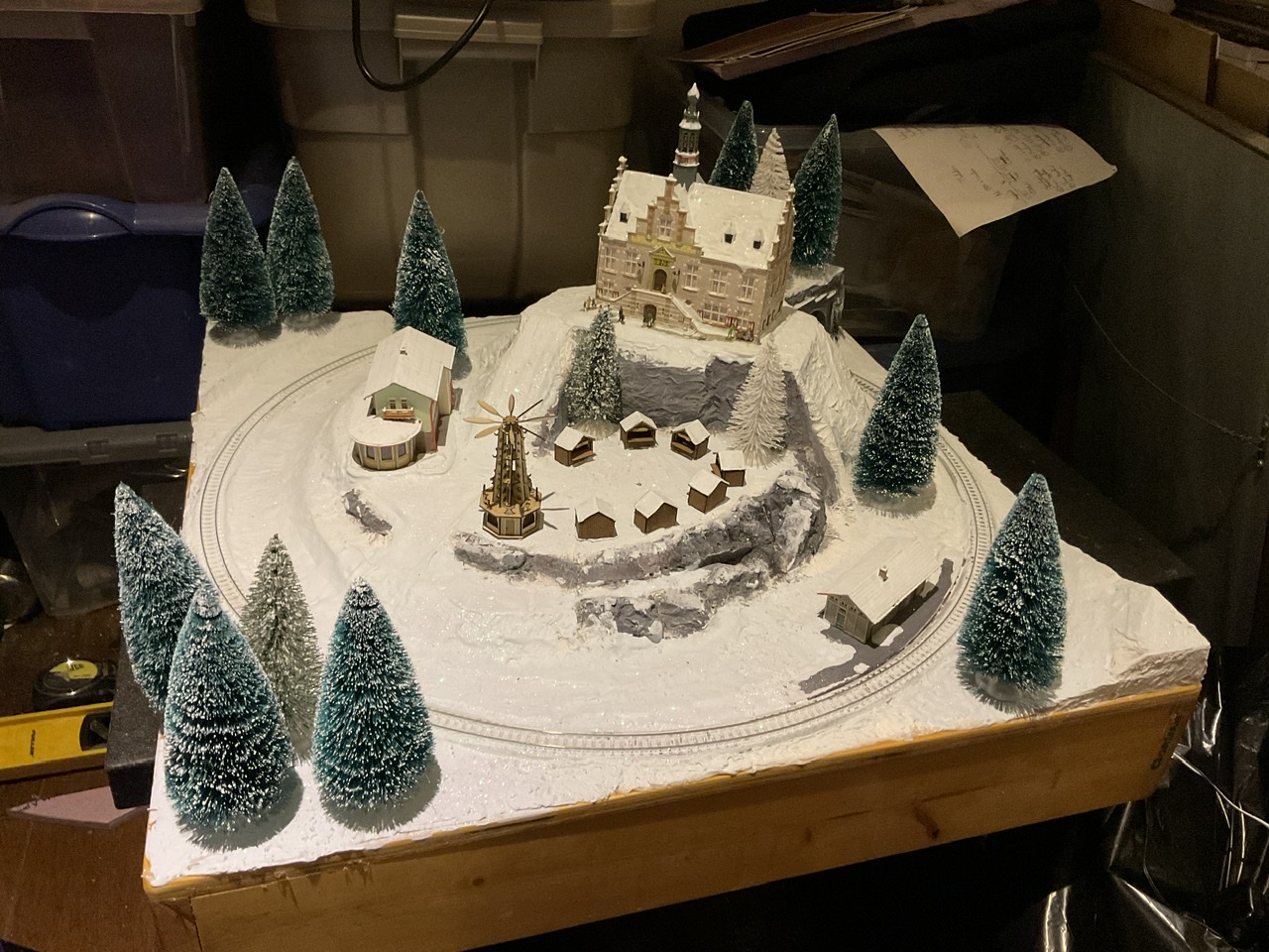

Well,
I've spent a few days wiring up LEDs and hunting for some dollar store trees and I'm now waiting for some glue to dry, then I'll be ready to put the little people on and finish wiring up the lights

grumbeast
So HAPPY!

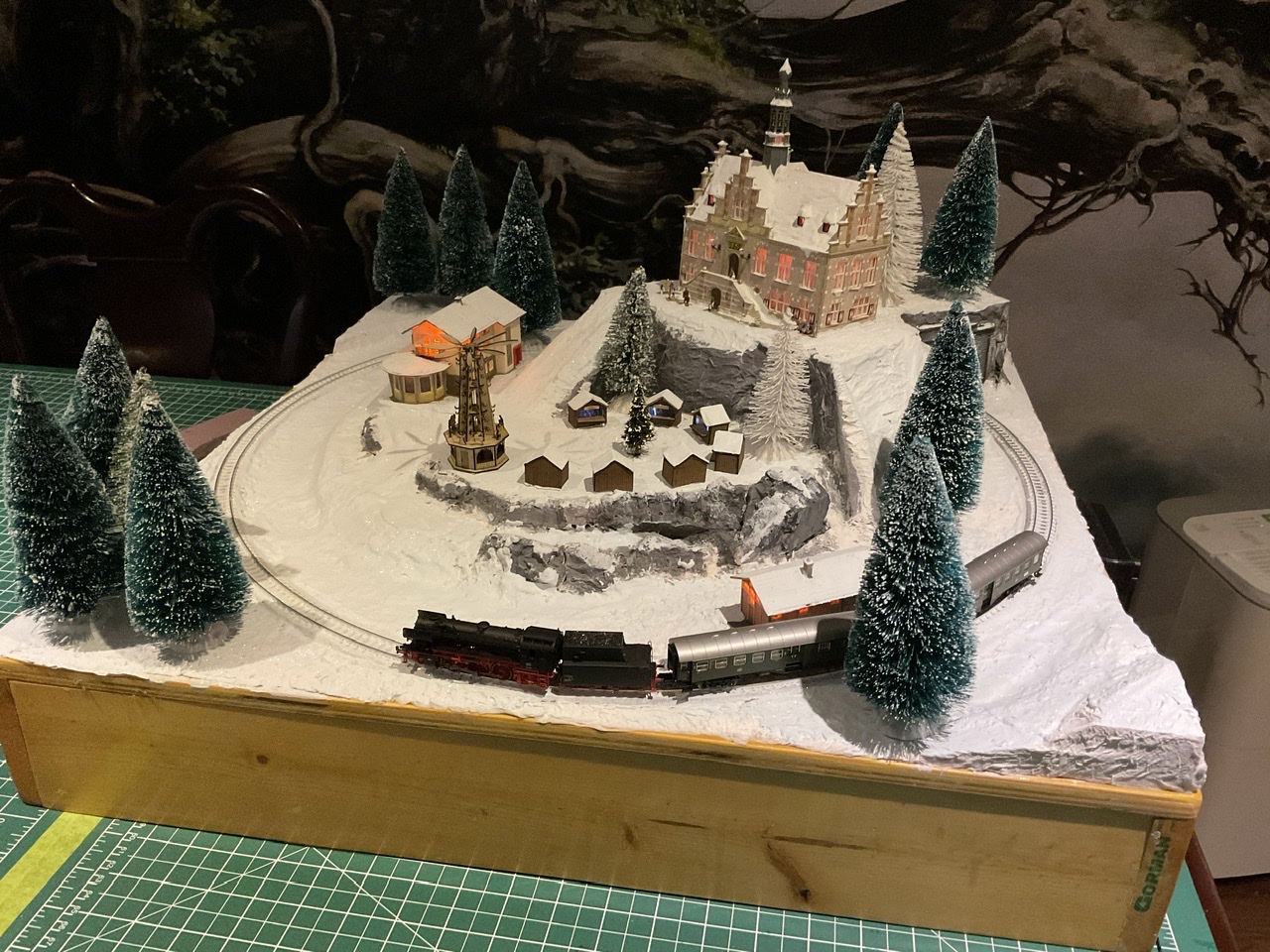

Lights are done and Trains are running!!! I'm at the stage now of adding a few people, vehicles and details.
This is very much a learning layout and I have learned a lot about lighting (first time using LEDs and Fibre Optics (need to shield those LEDs better and I need a better way to diffuse the fibre optics)
Dave Frary's snow recipe is awesome and worked very well.
Anyhow I thought I'd share a couple of progress pics.  Once I've added a few more details I'll make a little movie with some loco's from a few different countries
grumbeast
I posted this elsewhere too but thought I should also add it here.. so here it is!  The finished (for now!) winter christmas market layout!
Hope ya'll like it.. I had a lot of fun with the snow and have also now learned how to use LEDs and fibre optic cables
So a great learning experience
