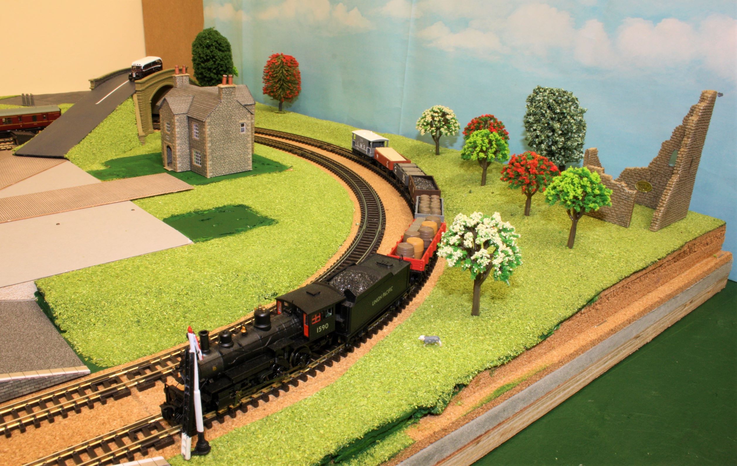

Train Waiting
Something like this, perhaps...
Sorry that the 'Ten Wheeler' is 'Uncle Pete' rather than the 'Standard Railroad of the World'.  As John and Nick suggest, the easiest approach is a single vehicle with a Buck-Eye coupling on one end and an 'Arnold-style' on the other.
In the case of this gondola, it was for a different reason.  Another of my UP locomotives is rather old and has an 'Arnold-style' coupling fitted.  I arranged a couple of freight cars as converter vehicles to allow the old locomotive to couple on to any freight train.  For the photograph, I turned the gondola round so it allows the 1590, a 'Buck-Eye'-fitted locomotive, to pull a train of British wagons with 'Arnold-style' couplings.
Perhaps you could do something similar.
Best wishes.

Hey that little train looks great!  Thanks for sharing the photo. It does make sense to simply swap out one coupler and run the rest of the cars as is.  In just 3 replies I have a great place to start and am convinced that it's not an idiotic idea.
