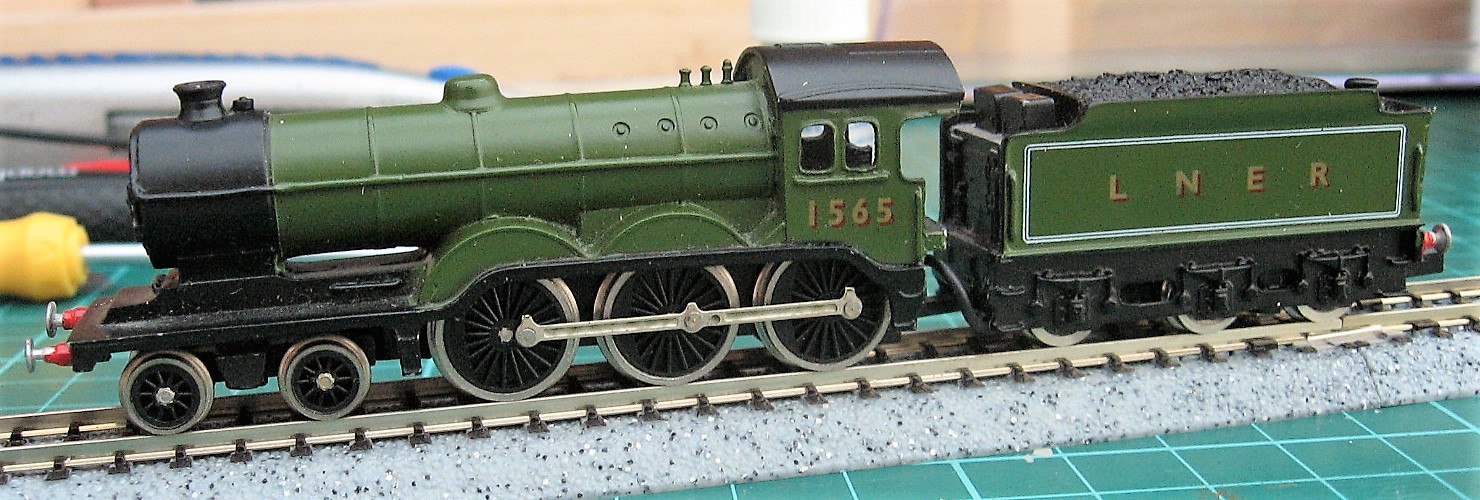

I have just the one, a B12 because the old Triang model was my favourite as a young lad.  This one was a very cheap ebay bargain sold as a non-runner (and 10 seconds to re-secure the connecting wire cured that  :D  )
I think the only thing I'd really like to see improved ex-factory is better buffers, eg. turned brass rather than cast lumps?

Easy enough to do, cut of the cast ones, file buffer beam if necessary, then drill hole for the brass ones, touch up paint.

Yeah but to my mind it's something that lets the models down and makes them look like an old whitemetal kit. Fitting them as standard would just lift the models that little bit.
