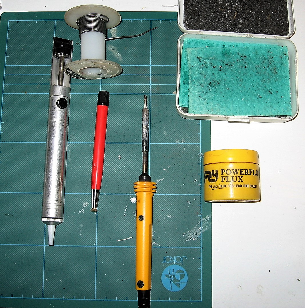

Soldering stations are great for bench work on electronics etc.  but for general soldering around the layout I'd suggest an Antex or Weller iron of around 20-25 watts power, with a couple of alternative sized bits including a small 2mm and a larger bit.   My weapon of choice for the last few decades has been a trusty Antex 18 watt job.
Use standard electrician's tin/lead solder with a flux core (not plumber's solder) and avoid the lead-free stuff as it's it's not fun to work with. Have a tub of flux paste available (though you won't usually need it for electrical joints, a tiny amount is good for things like soldering rail to screws or copper strip at board joints etc.).  Use something like a brass or fibreglass cleaning pen to clean the work before you solder.   Have a damp sponge available to clean the tip regularly in between making joints.
Get a decent weighted stand to hold the iron in between joints. Avoid the frustrating cheap lightweight stands which fall over or move all over the place!
Oh, and a solder sucker is a useful tool for when you need to remove solder from a joint!
