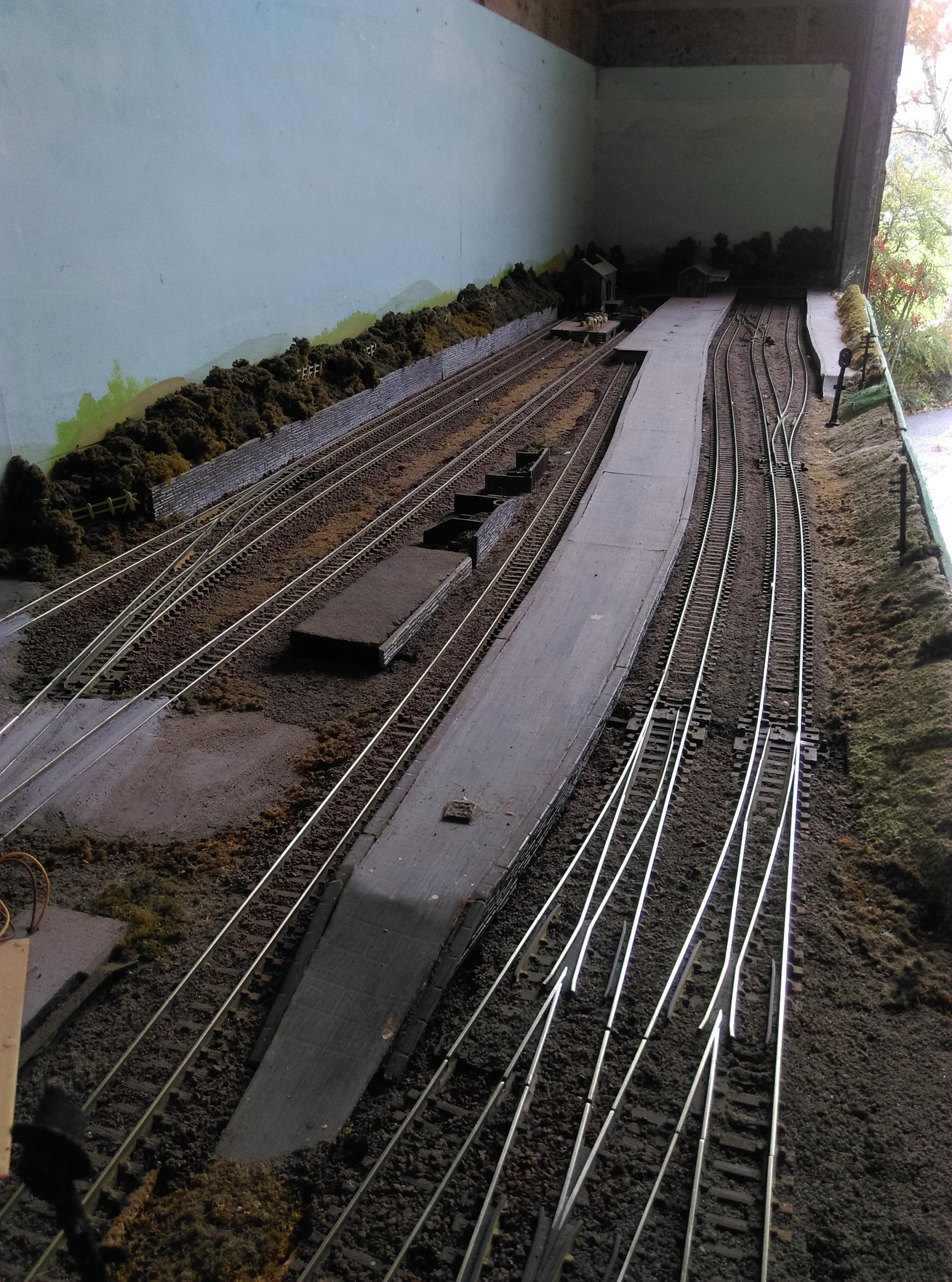

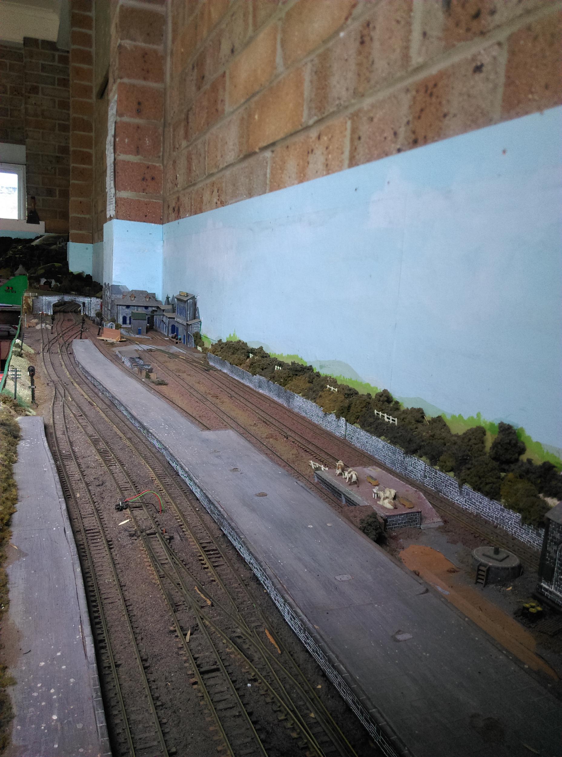

What folk have said is correct - platforms are surprisingly long things. I have a terminus station on my layout which I must admit I've never measured, but I'd estimate around 1.2m.
You've got me curious now.... I'll put a tape measure to it when I get home!  :thumbsup:
#10
OK, just did. 1.3m on a slight reverse curve. It will hold eight Mk1 coaches and a tender locomotive or a large diesel.
Sorry for the dilapidation, but old layout currently undergoing restoration.
