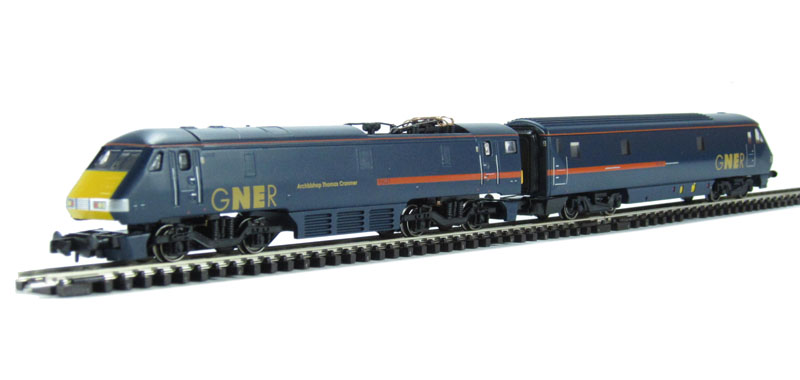

The Graham Farish class 91 RTR is a crass model, it isn't well assembled, the printing could be improved and, like the 90, the buffer beam really ought to be attached to the body not the bogie. The model is neither DCC ready nor does it have lights however, with a bit of modifying, it can be made to look up to date! Now there is another thread on here that speaks about crowdfunding a 91+Mk4+DVT rake but frankly that is highly unlikely. With the development of the 90 in OO gauge by bachmann perhaps they'll make a 91 after the 90 sees the shrink ray but I doubt it, the "Archbishop Thomas Cranmer" set simply took too long to sell, unlike the mk4s.

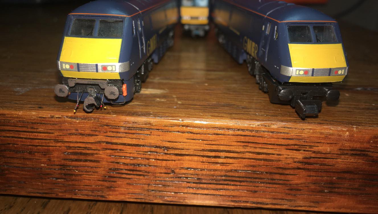

This image shows the 91's dismal front end out of the box:

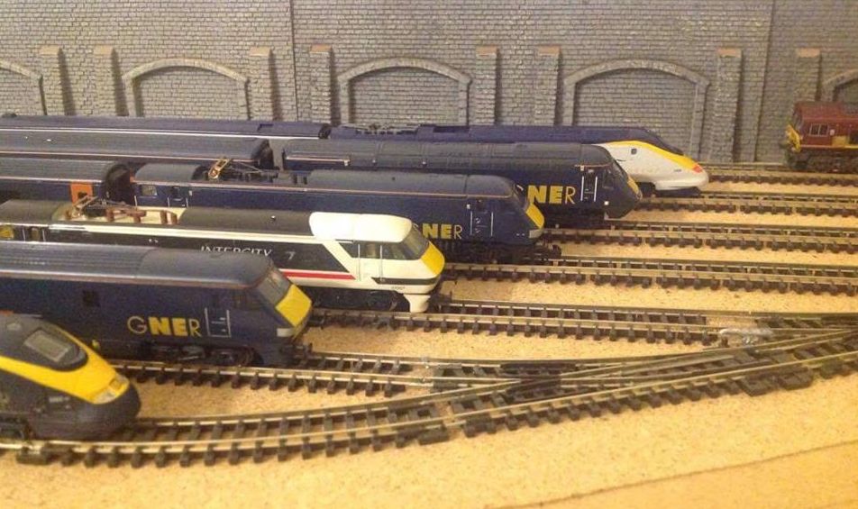

And here it is, next to my detailed version: A good enough improvement I think
Criticism of the GNER 91 seems harsh in my opinion when compared to the swallow 91 from the nineties but I think the swallow worked better due to the white bogie as opposed to the black one on the GNER liveried models. Please see below:

Quote from: G_N_E_R on January 21, 2018, 04:06:53 PM
Seen that image on Hatton's web site. It does seem to be a particularly badly made or badly posed example, as if the whole bogie/buffer beam  moulding has dropped/come unclipped somewhere?

ntpntpntp;
It looks to be the track thats not flat on the board, thats how I recreated quite such a result!

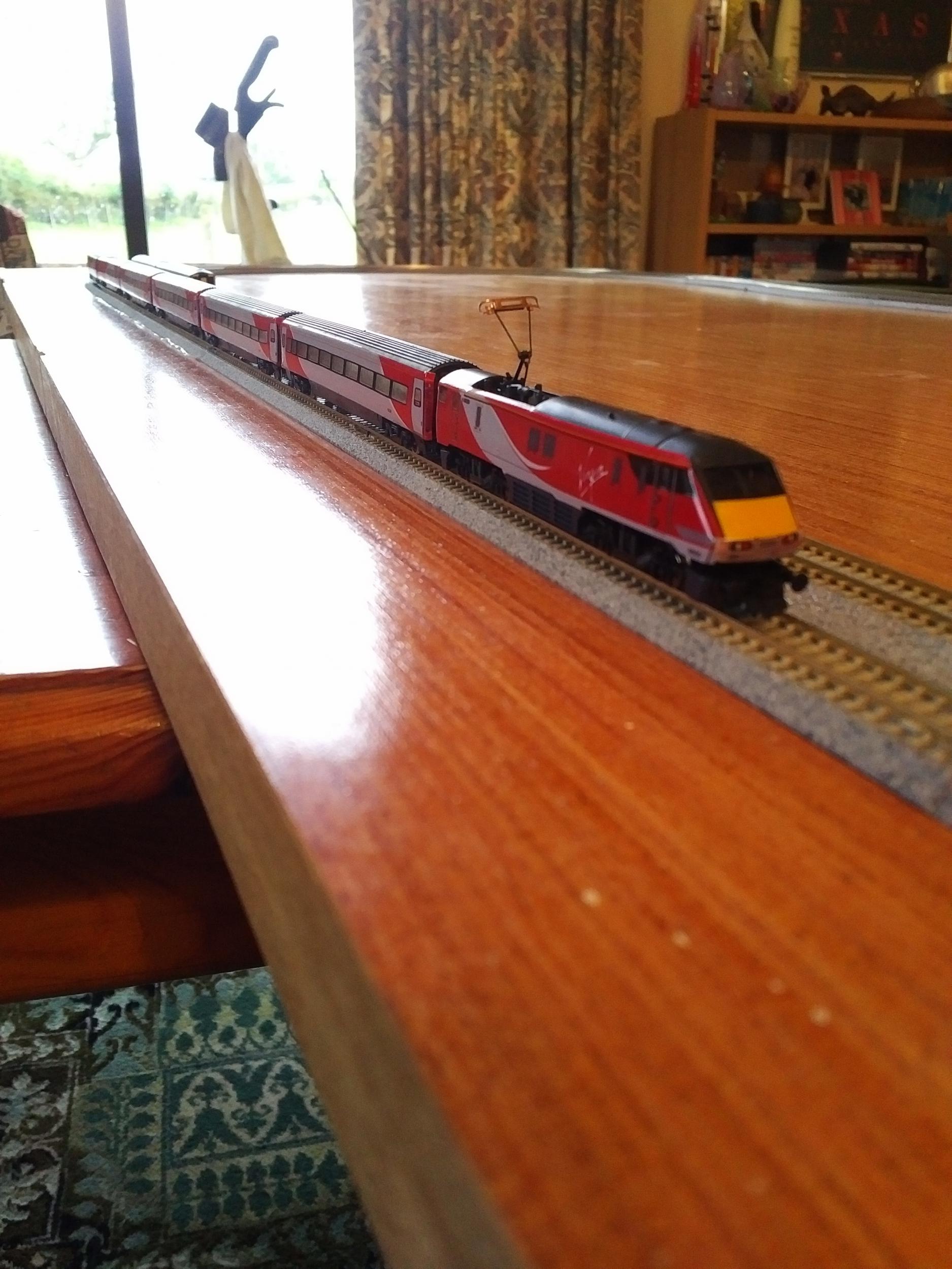

I have a class 91 with mk4's with Electra vinyl's into VTEC.  I only have a small layout at the moment but I think it looks fantastic (from a distance) and probably the only way to get this model for a long time.

I'm having a quick look through my Google photos now to see if I have anything to show without me having to get it all set up to take photos.  I used the Electra website.  Excellent service and easy to do.  I'm happy with the result but it's not perfect upon close inspection.  I think this is more to do with my skills though.
jacowin80
Sorry for the delay @kirky @Jameswgm.  Not the best photo but should give you an idea.
Also a little video.

Very nice work that. Thank you.
