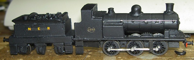

A while back I acquired a Highfield S&D Bouch long boiler. It's probably one of if not the first UK outline N scale model loco kit, and Ray at BHE spun a new batch a while back along with the never released G5. It's not brilliant - it was to fit an Arnold chassis so its somewhat 'Limaesque' but with a bit of hacking and scratchbuilding some chassis bits it is getting there. It still needs a few bits of plumbing adding and the splashers. Right now it's also static as I'm still trying to build a working tender drive for it.
The centre bits of the chassis are from a dead Terrier picked up on ebay the rest of the chassis is bits of plastic and card, except the steps which I etched on the corner of a sheet a while back. On the bright side the NER figured out pretty early on that it was a whole ton cheaper to paint freight locos unlined blakc.

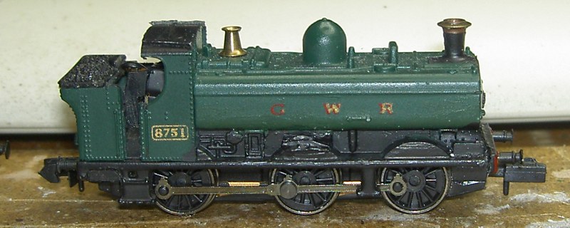

Also doing a bit more work backdating a pannier. The picture shows there is a fair bit of filling and tidying to do yet, particularly where I removed the boxes over the middle spasher. Sandboxes and some work on the front of the frames will also be needed. The motor is a bit of a problem I'm hoping a pair of crew members will "lose" it.
