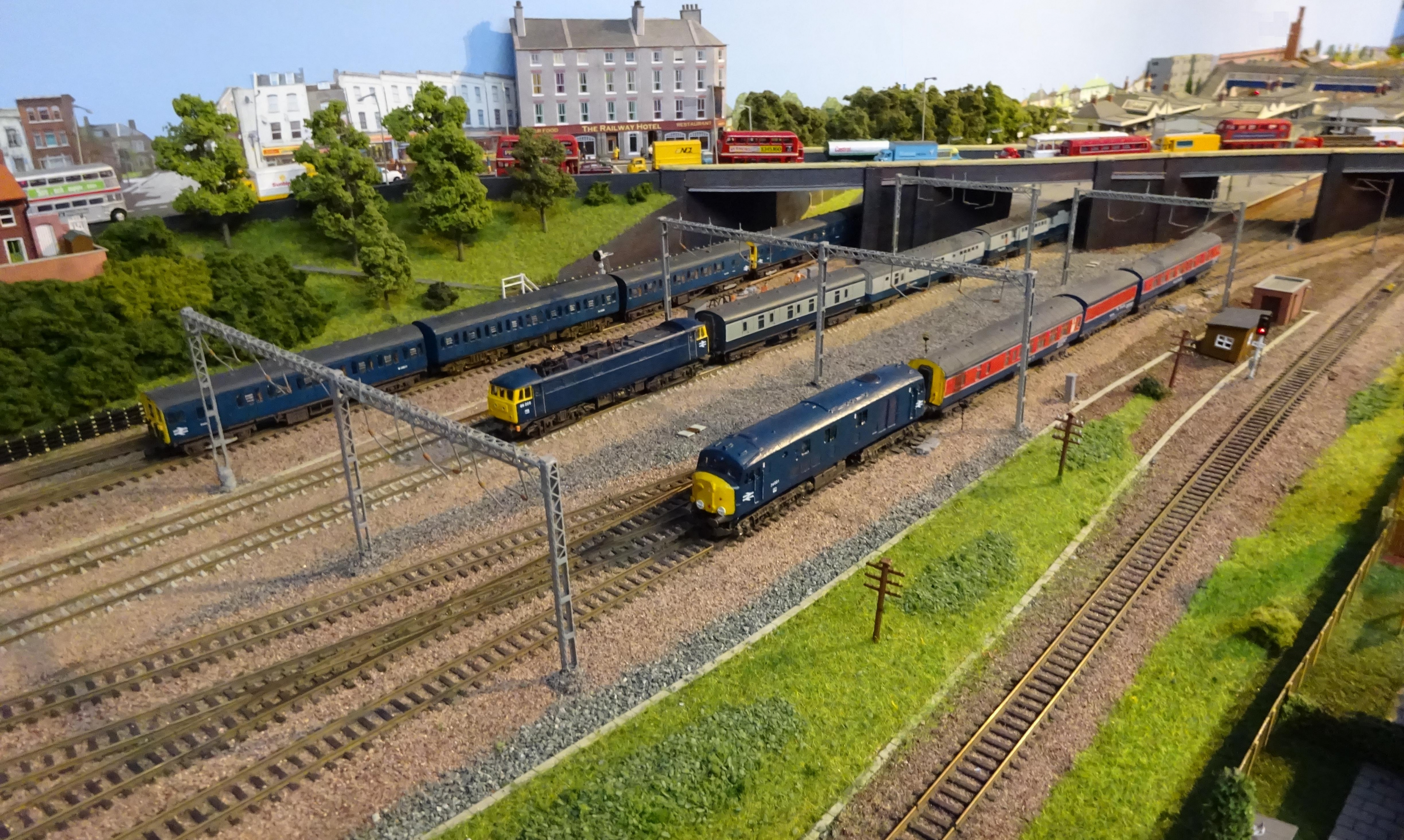

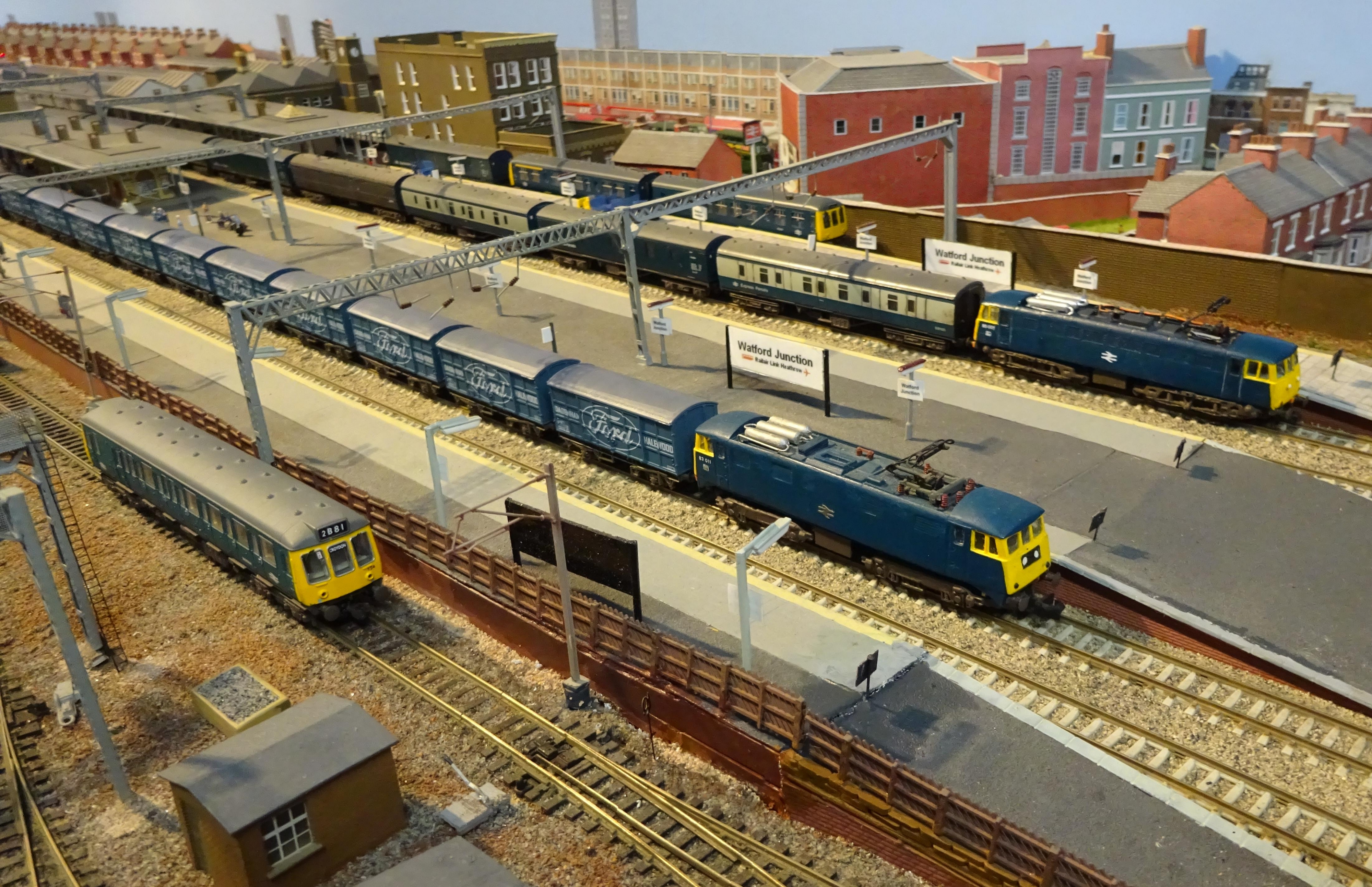

Another weekend keeping the rails clean by running the trains :NGaugersRule:
Full story and pics at:-
Fabulous to have a running session andy. Great photos and stock as always. Chris
LASteve
Always great to see your pictures. Nothing more therapeutic than sitting back and watching the trains go by.

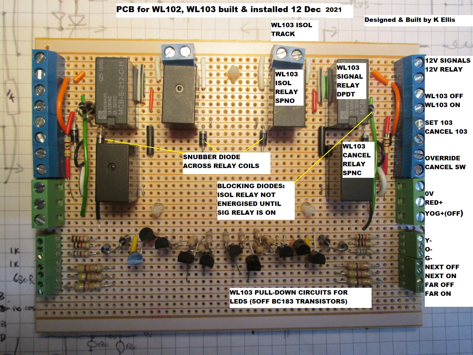

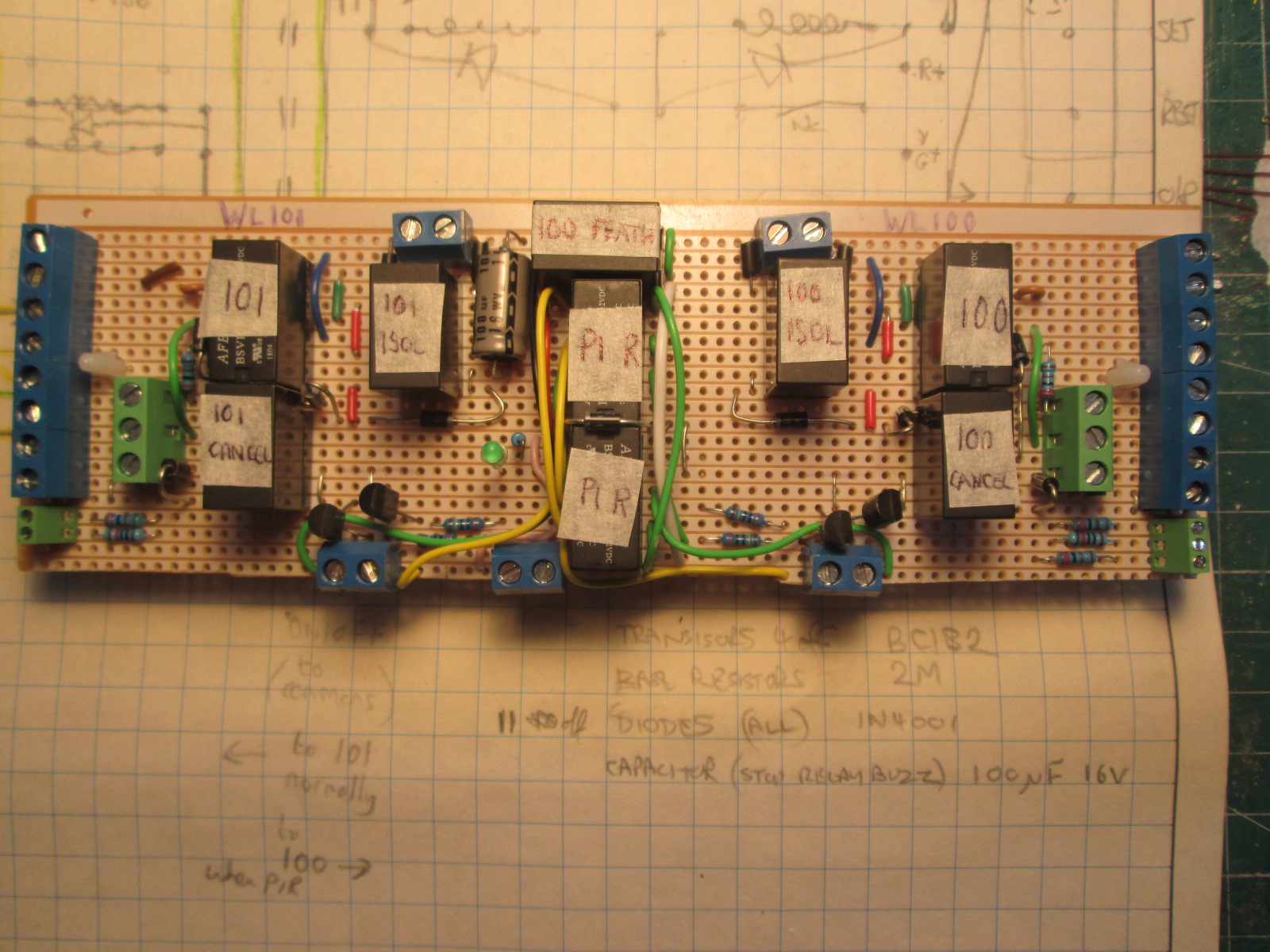

TODAY... I've been installing a new pcb to control 2off 3-aspect signals (WL101 DOWN SLOW & WL100 DOWN FAST). The pcb was designed and built by myself - there are 9 relays on this board! WL100 protects the crossover DF-DS so will have a 'feather'. I stopped tonight at 21:15 having got WL101 working. WL100 awaits tomorrow...
This board permits automatic running; isolator sections, reed switches for cancel and autoclear, override with shunt signals.
Once this lot is working I'll put a video on YouTube... kevthbusdriver

KevTheBusDriver
Well, the board took most of my spare time on Tuesday to install, but it's all working and I manged (eventually) to put a descriptive video on YouTube:
https://www.youtube.com/watch?v=vplfsR-77lw
The electrics aren't that complicated - you really only have to know how a relay works and how a transistor can be wired 'as a switch'. Although it took a week to design & build, this board hasn't cost more than about £15 in parts. What's next? Maybe signals WL102/103 (they are are on a gantry...).

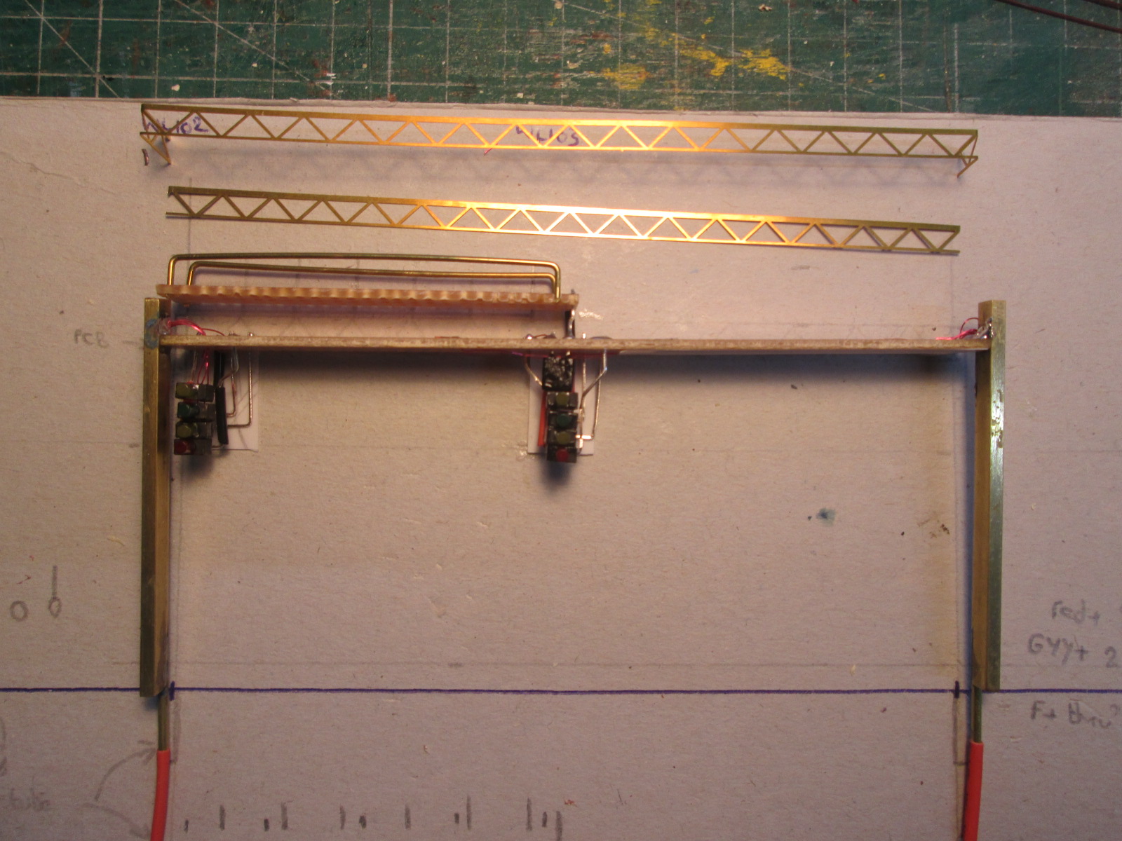

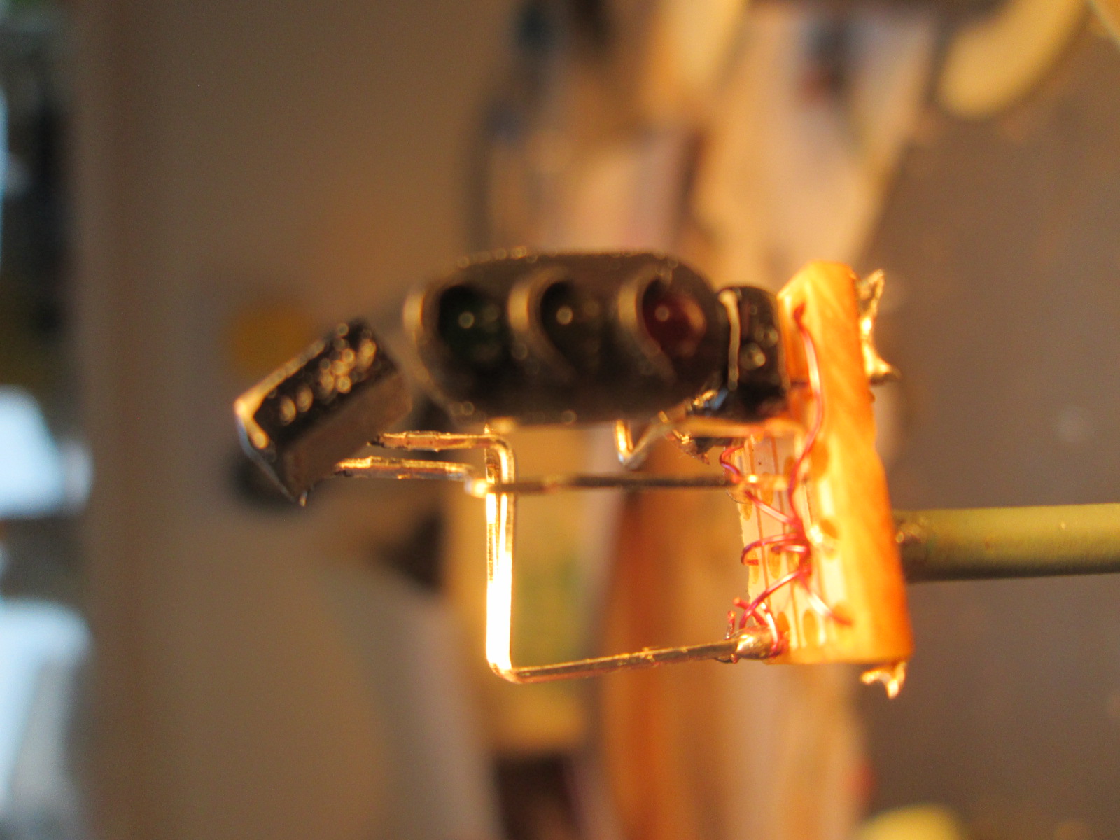

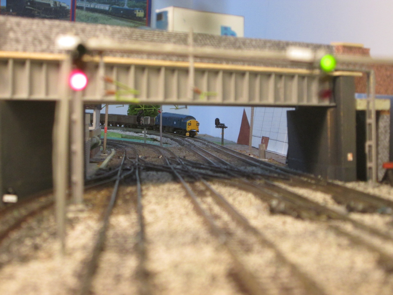

Sunday 12 Dec 2021...
install & wire new 4-aspect signal gantry at Pleck Junction;

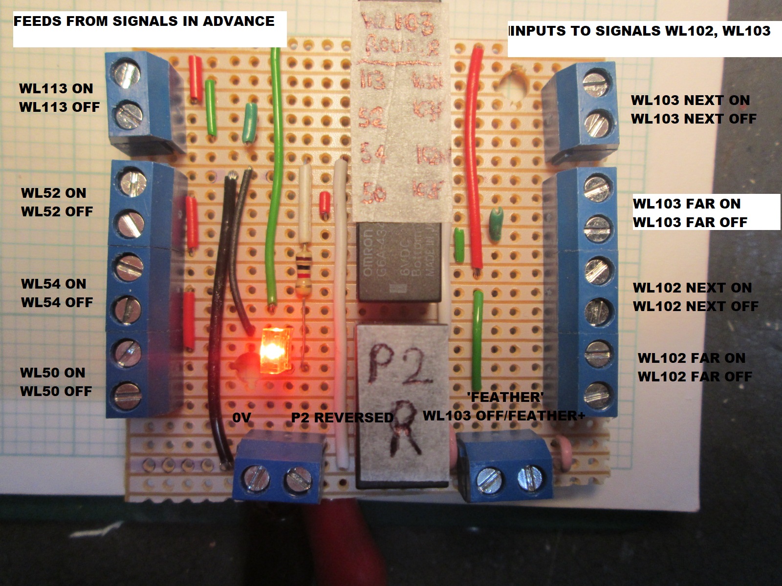

Here's the original 3-apect version dating from about 1985...
The 3-aspect junction signal (WL103) was wired to only show Y when 'off' if the diverging route was set. In order for the 4-aspect version to 'look' at the correct signals ahead, it needed a 'router':
The new signals also required a new control board...
The new gantry on the bench:
And does it all work? See the video
https://www.youtube.com/watch?v=6_VGkPXcvzk
Having spent at least 4 hours underneath Pleck Junction this weekend, I'm running trains now!
