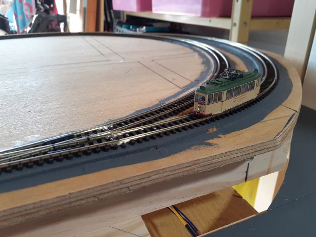

So, I was distracted in the morning, but got to the layout after lunch.
The first test with all the feeds on and controller at max showed there were no short circuits. A run with an old Arnold diesel identified one siding near the front corner had the polarity reversed. With that fixed and a track clean a run by the company tram over the entire track showed it was all working.

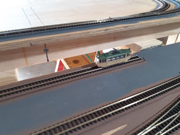

Here's the tram in the bay and approaching the summit.
The tram went off and a Minitrix 0-6-0T was tried. It is the shortest wheelbase loco I have and the point frogs are not powered as yet. I wanted to see if the Unifrog points needed to have a powered frog to operate - they don't. The "dead" zone on the Unifrog point is not particularly large. The 0-6-0T did run very roughly and stall on a point when running into the diverging path due to a very poor alignment of the point, the IRC and the track, but this was very slightly re-aligned and smoothed.

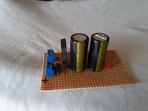

Built a CDU for the 3 motorised points. Haven't wired it in yet.

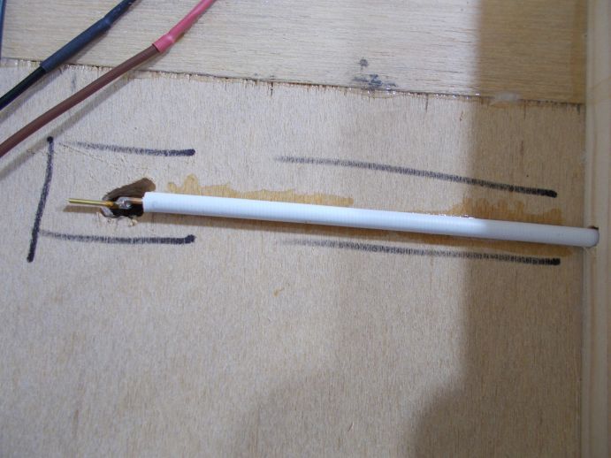

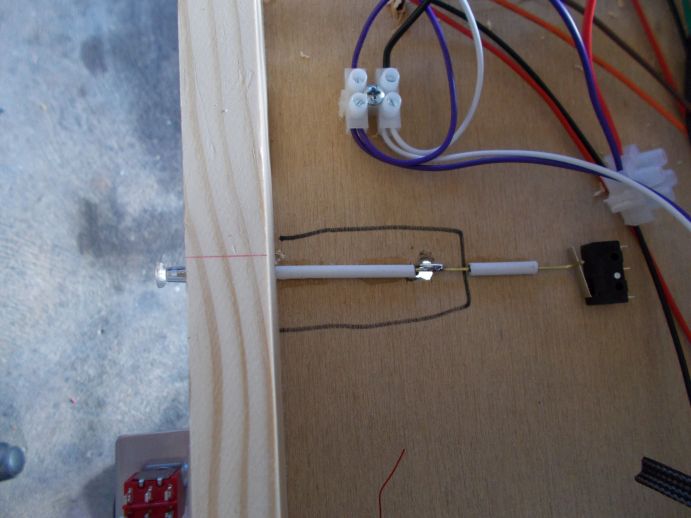

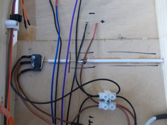

Had a go with WIT for the terminus points. Added a little pusher at the tiebar bend to operate a uswitch.
I wasn't very satisfied with that setup. It worked ok, but the operating rod rose and fell a little bit as it was operated. I added some tube beyond the tiebar and ran the rod right through, with a tiebar operator rod soldered on. Bent the end up to bear on the uswitch lever. Much better.

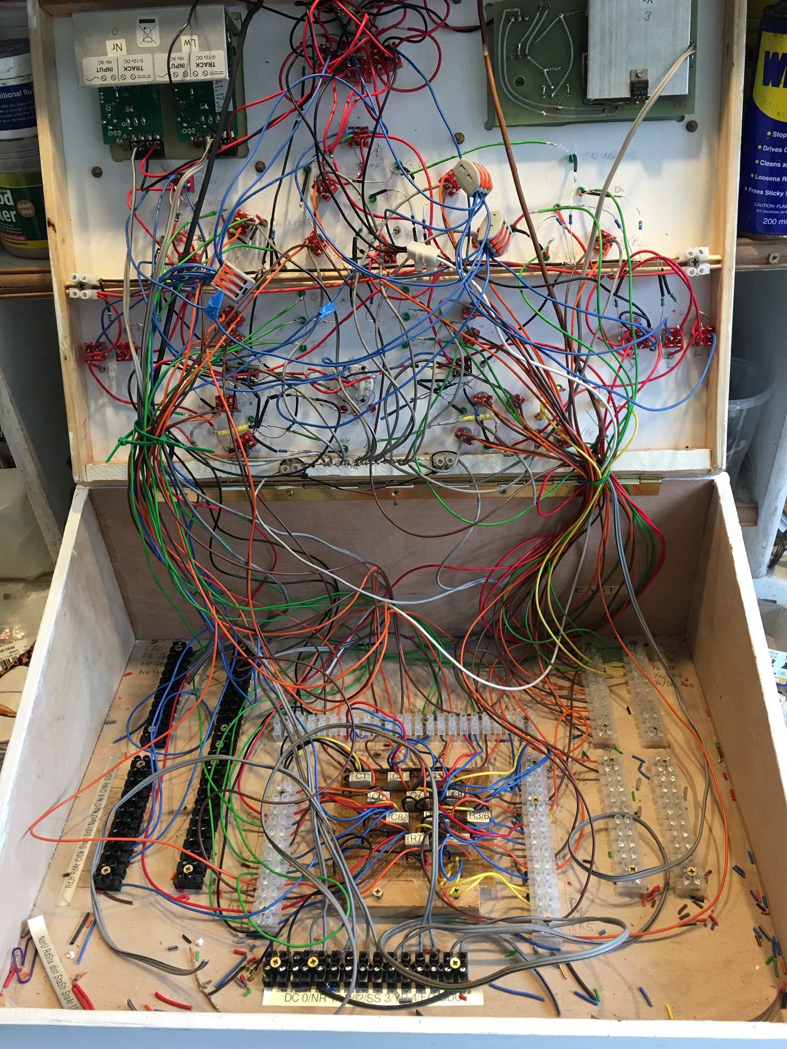

I'm back to hopefully load a short video or a couple of pictures to show where I've got to with the control panel. I bought several used items on eBay and some point motors c/w switches we're in fact unswitched ones!
Consequently I've had to rethink half the wiring, making the West board the non-switched side for point indication from the point motors. To overcome this I've made up a panel from stripboard and relays to mimic the point motor position.
It has one benefit in reduc8ng the number of cable runs to the West board and so I've decided to have the control panel independent but primarily on the East side.

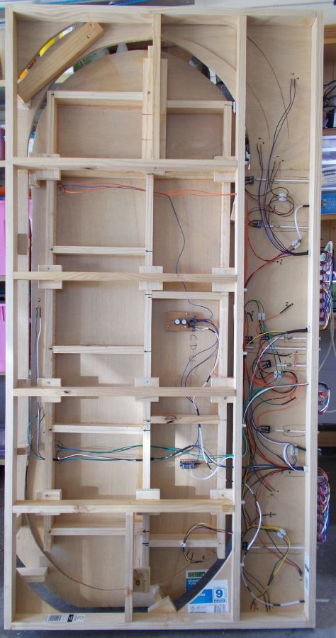

Finished wiring on the underside of the board. Fitted and wired the micro switches for frog polarity/power and wired in the CDU and 1 point motor on the underside of the board.
It's good to get the layout right side up again so I can start on the b, b, ballasting work.

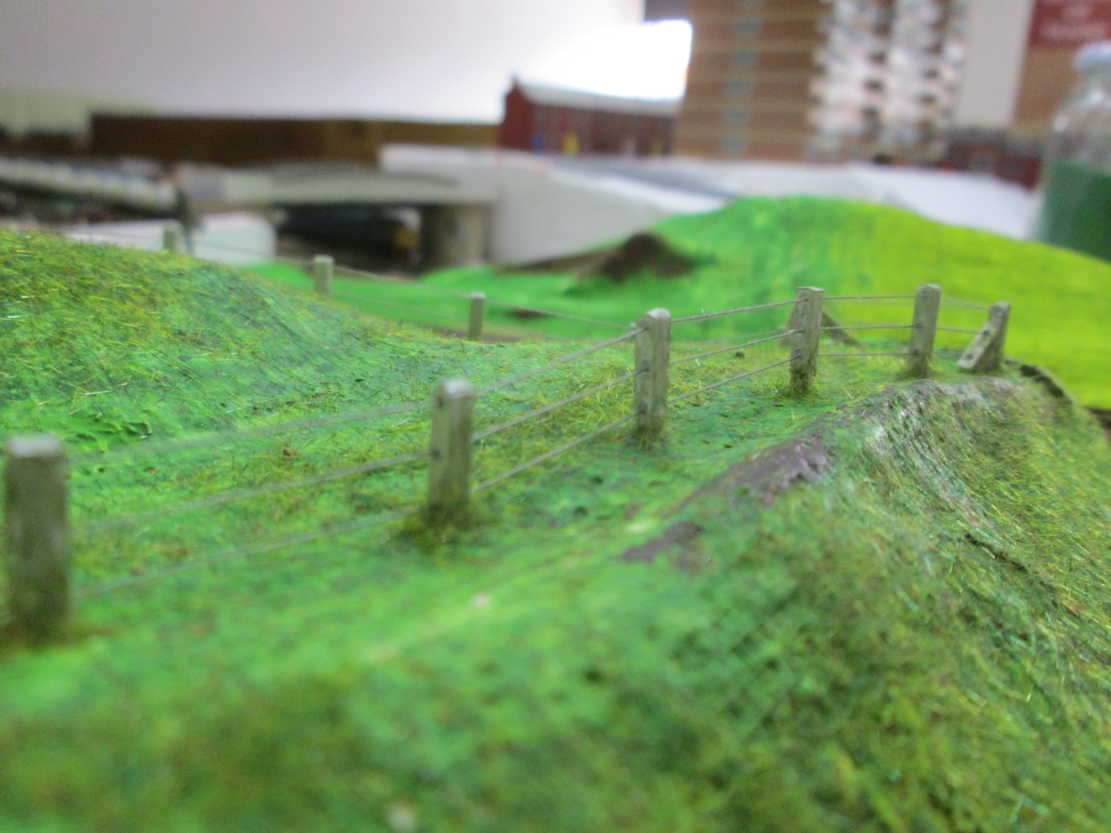

Fencing this week... 2mm square plasticard rod, cut to 13mm long, last 5mm filed/sanded to a round section, top filed like an inverted U, 3 off 1mm diam holes in each one, placed on about 24mm centres, then 'wired' by sewing grey cotton through each hole! Tedious but I'm happy with the result.
Sounds like a Herculean task but it does look very good.
KevTheBusDriver
Quote from: Newportnobby on July 30, 2021, 09:30:42 PM
Thanks, NPN - fortunately(!) this fence was just 17 posts (took about 1/2 day to make & install). I know 1.5mm sq rod would probably look better, but drilling 1mm holes...
