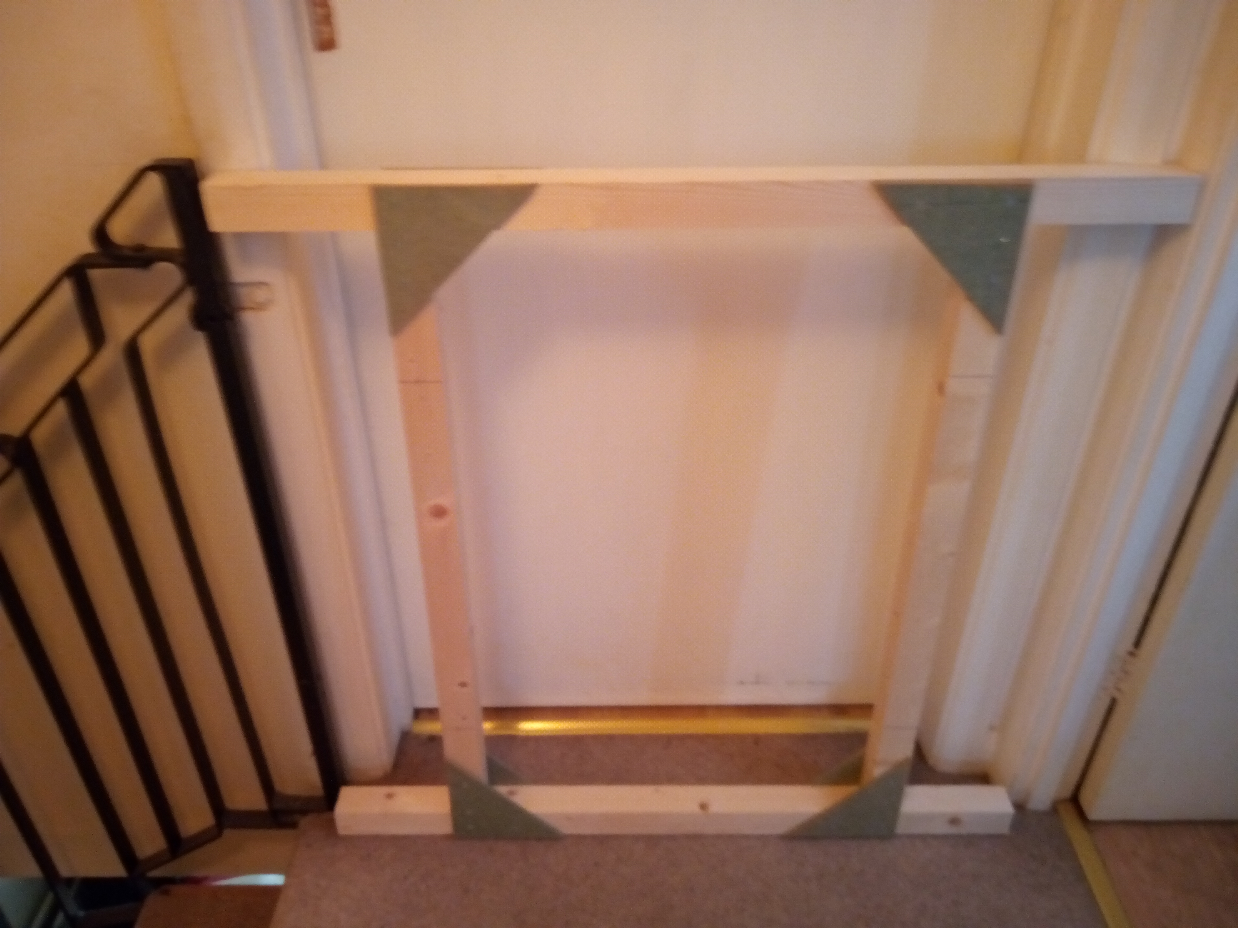

At last I am in construction mode. I am building the vertical elements of the frame which will support my layout.
There will be 4 of these with horizontal spars connecting each pair. There will be castors on the underside of the bottom piece of wood, the front set will be lockable. I will use the space between each pair of legs for storage. I will start a construction thread when I have more to show as the "Maen Quarry Railway (Cornwall)" progresses.

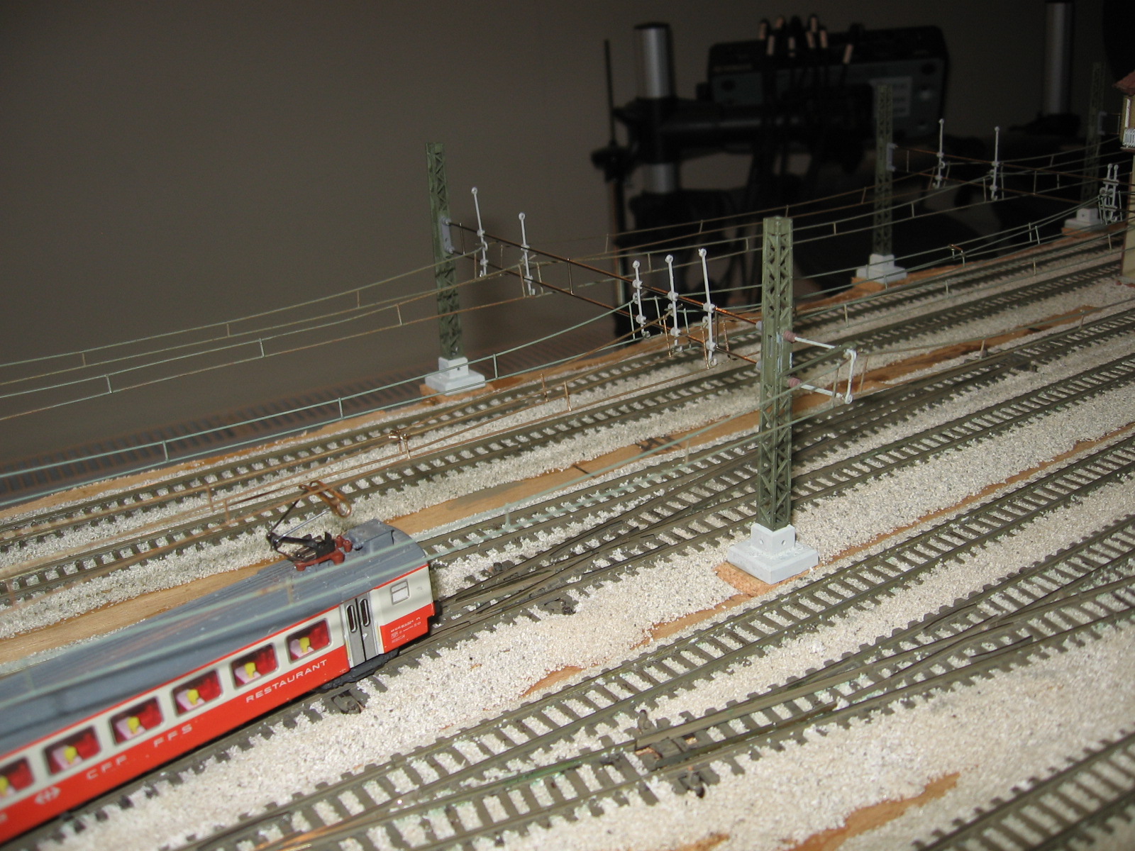

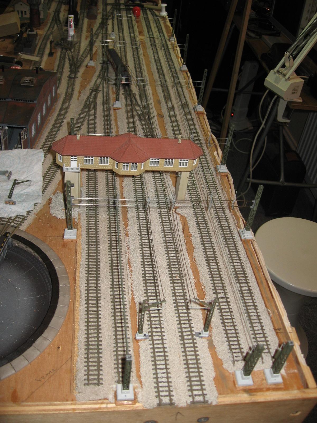

Currently making good progress on adding the overhead to my German loco depot.   I've taken two weeks holiday to get this done, it's got to be ready for next April  :D    One of the pair of boards is fully installed with catenary including over pointwork and a single slip. more slips to do on the other board <groan>

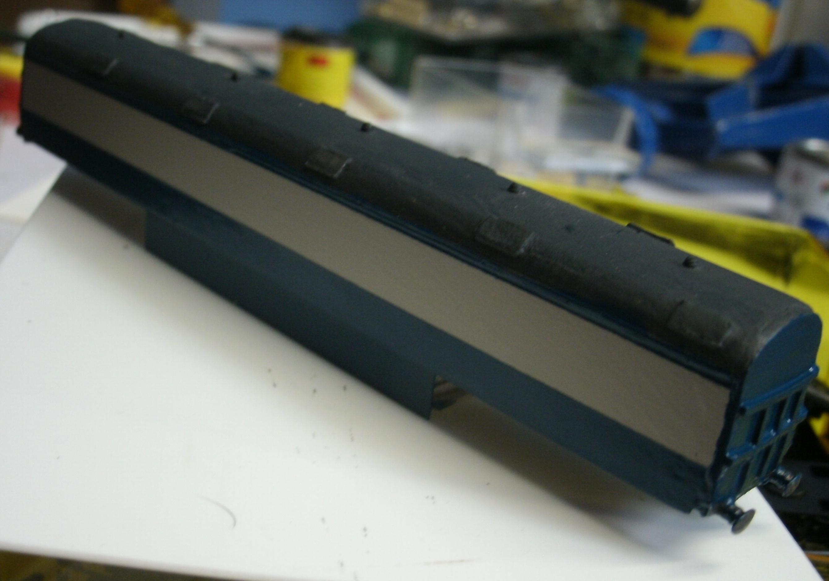

Just finished off making a Twin Deck Car carrier (TCV) out of some leftovers from my spares box.

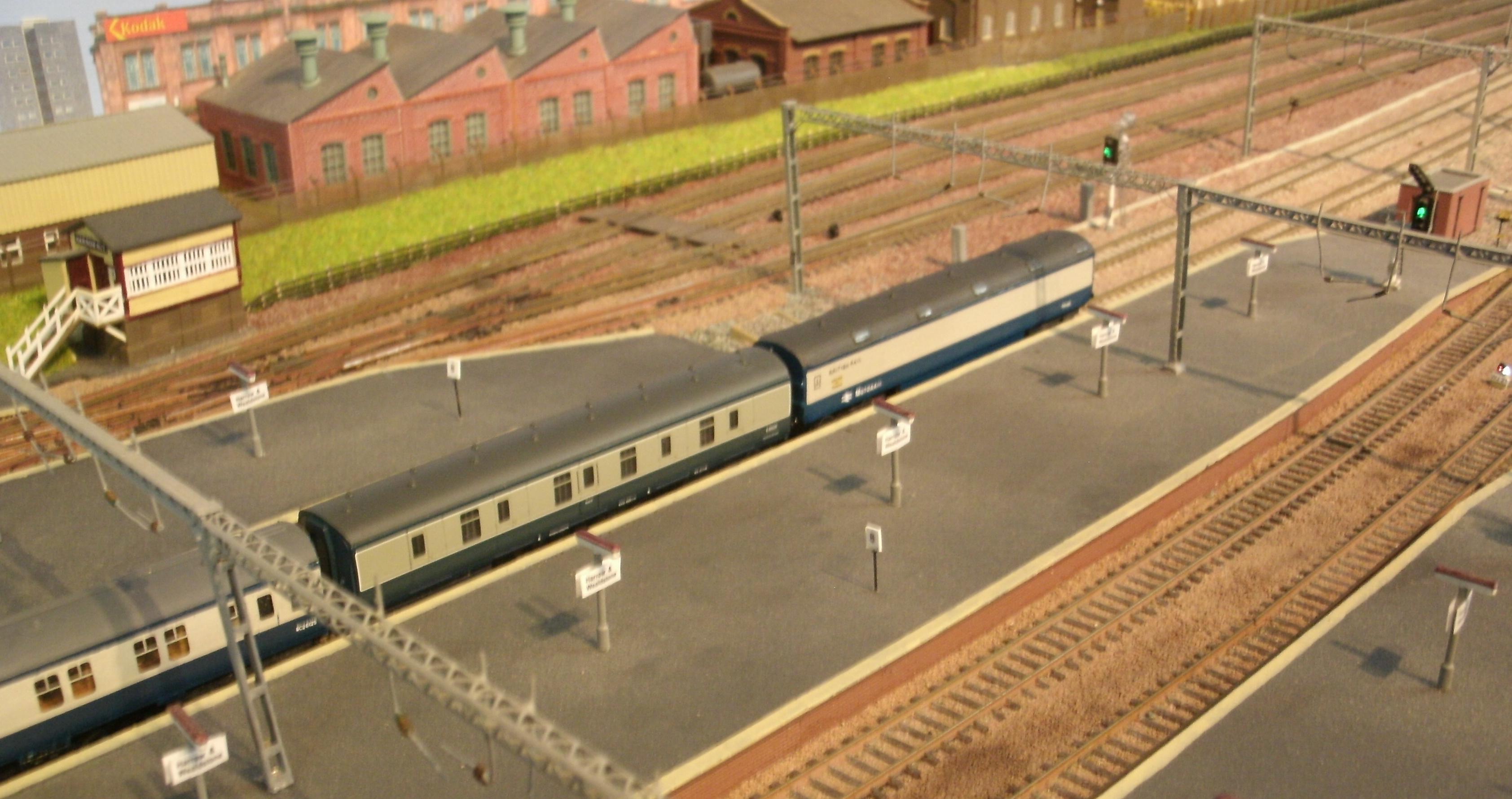

Finished item at work on the layout

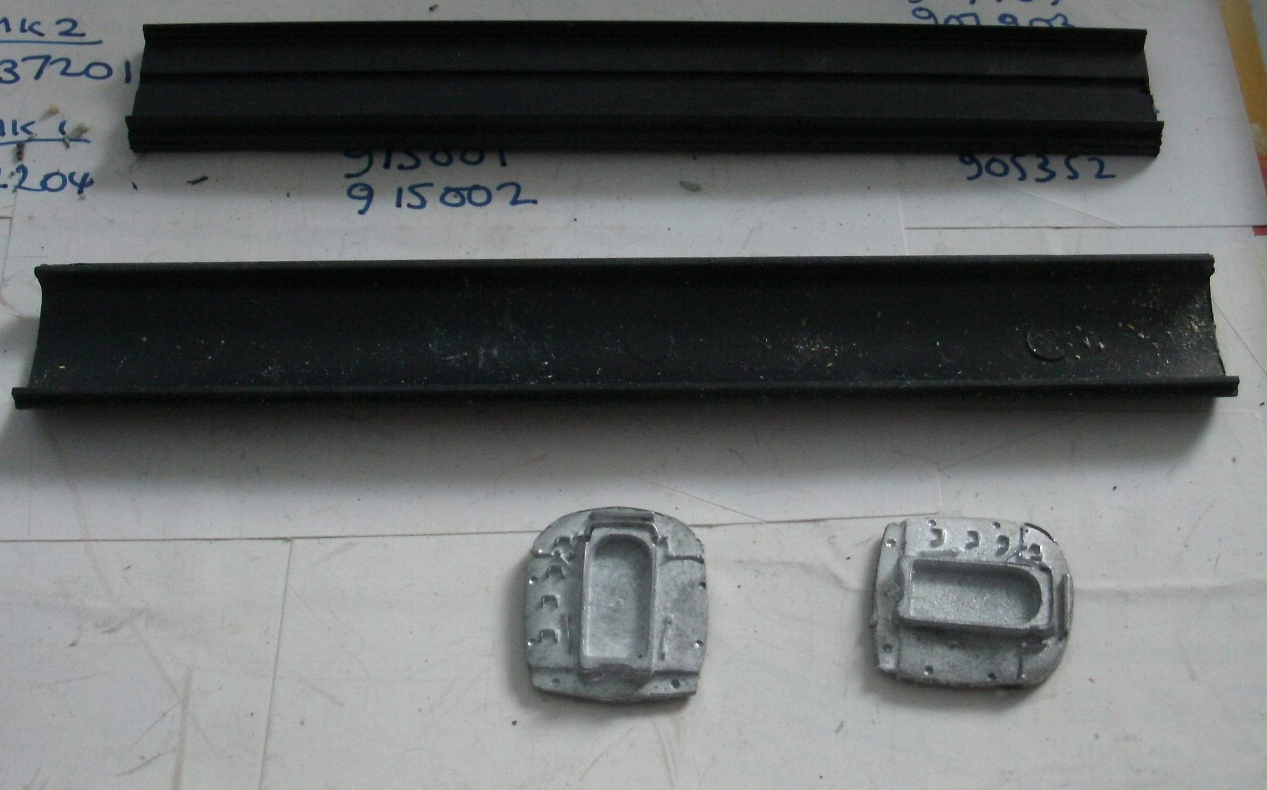

Basic parts roof, underframe, and ends

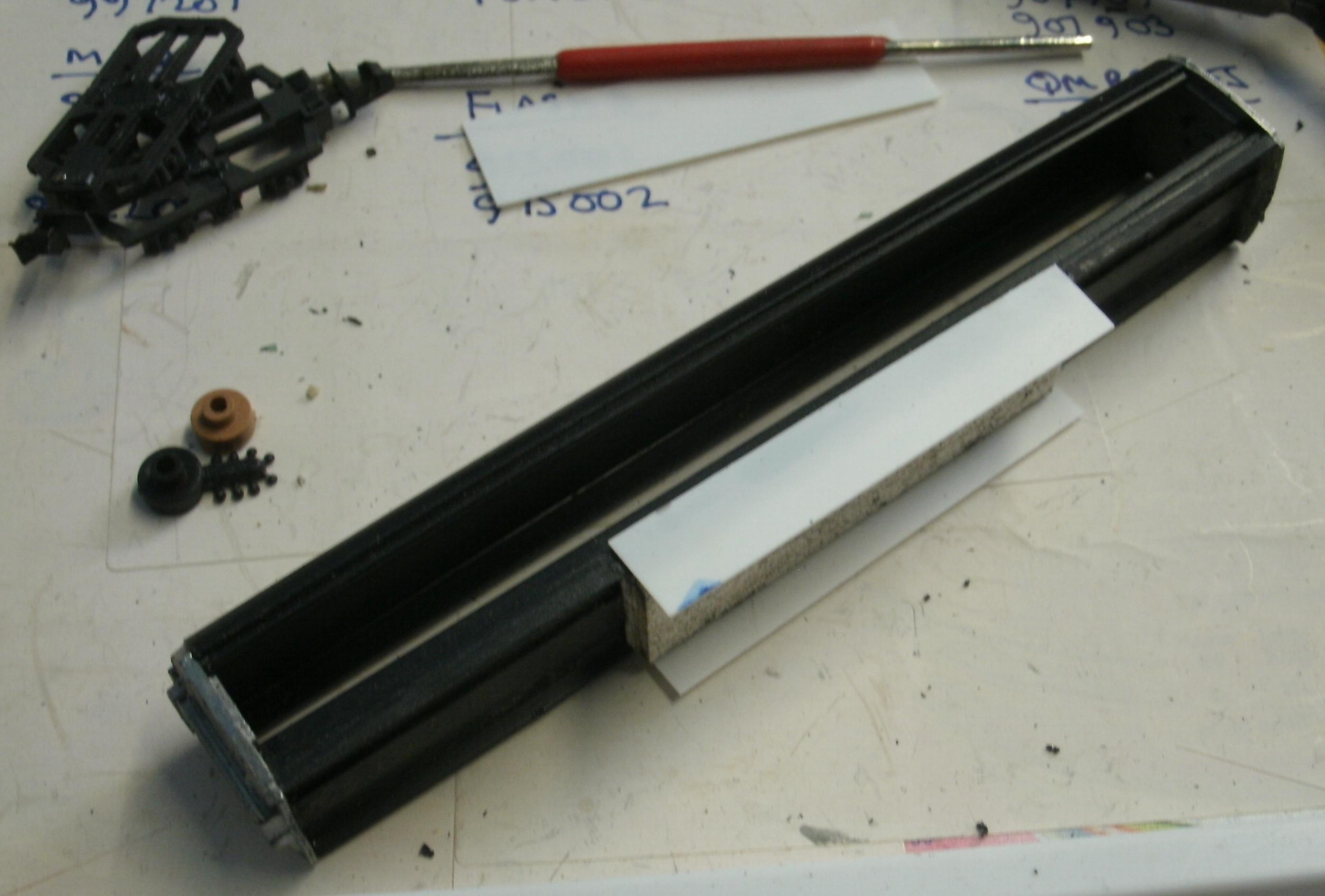

Ends, roof and underframe stuck together. Lower well deck sides stuck to the underframe with some balsa wood strengthening.

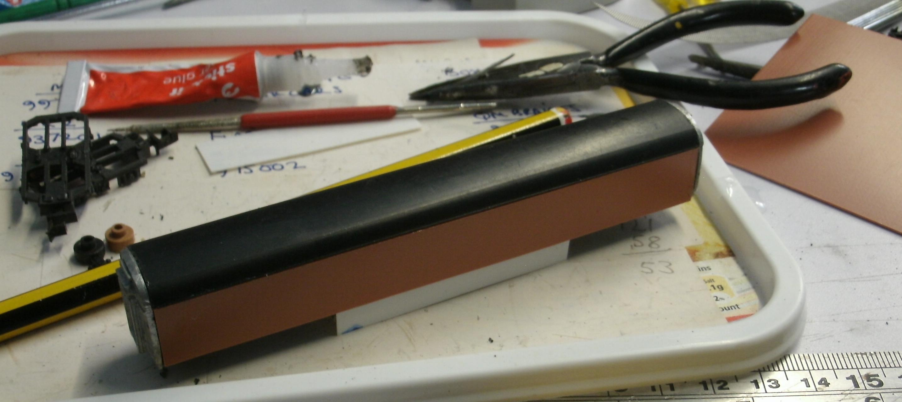

Plasticard sides added before filing ends flush with sides
The ends have had the original detail removed, and some bits of plasticard added. Body was painted all over rail grey first, then masking type applied to do the rail blue parts.

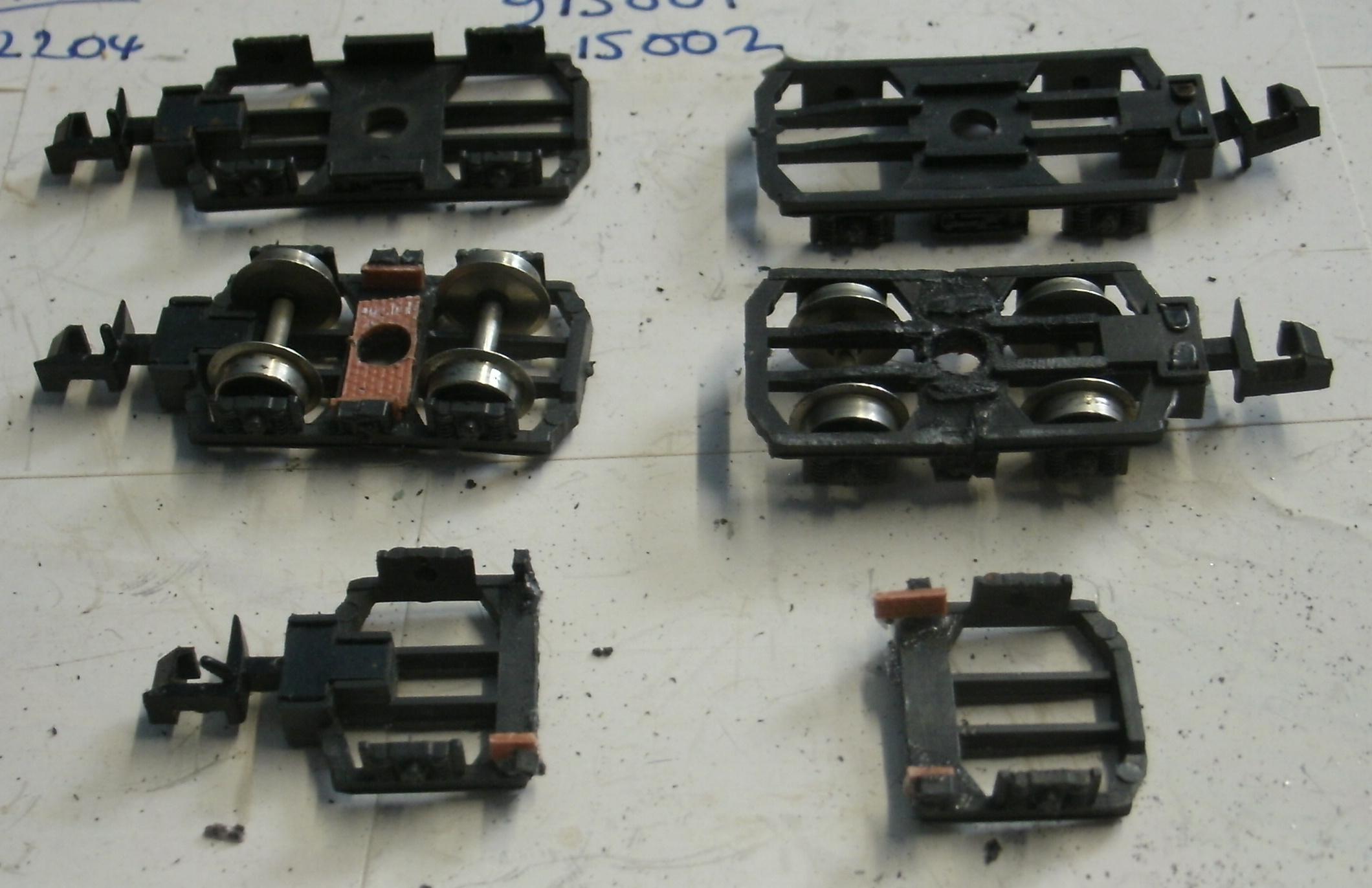

Shortening some bogies to fit.

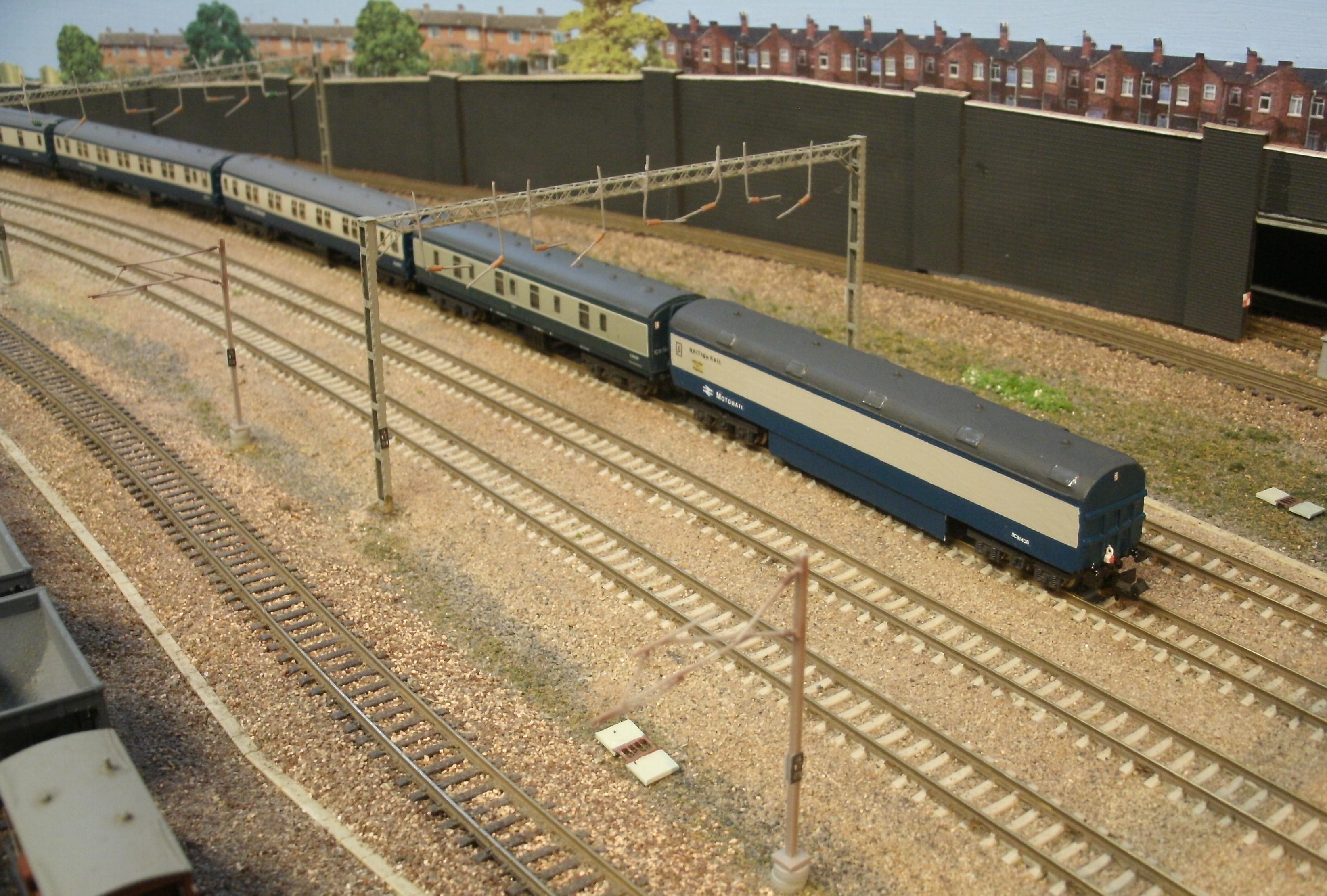

Finished item in use. Didn't have the right transfers to finish, so improvised from some old Pressfix letters.
