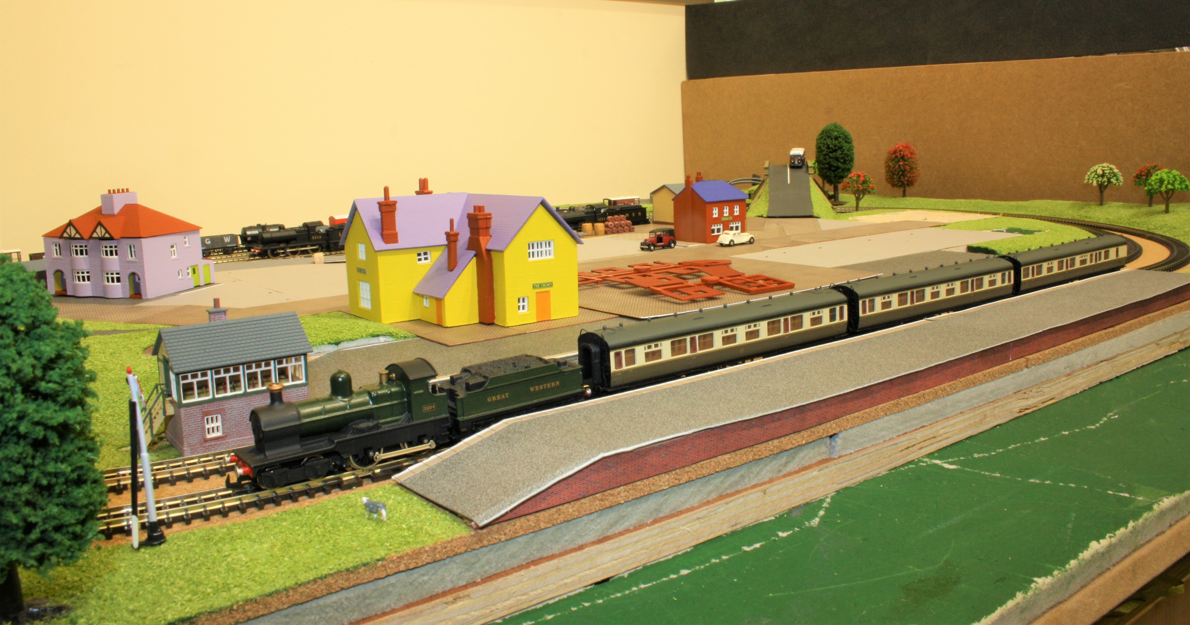

But I can comment on the firm's range of passenger rolling stock and I think it is excellent.  Dapol carriages spend many happy hours running round my little layout and are an absolute boon.  I'd be struggling to bring my 1923-1938 scene to life without them.
These three Dapol 'Collett' carriages make a super passenger train.  By the way; the locomotive is a 'Dukedog' 4-4-0 from Union Mills.
Thank you Dapol, from a happy customer.
Best wishes.
Dr Al
