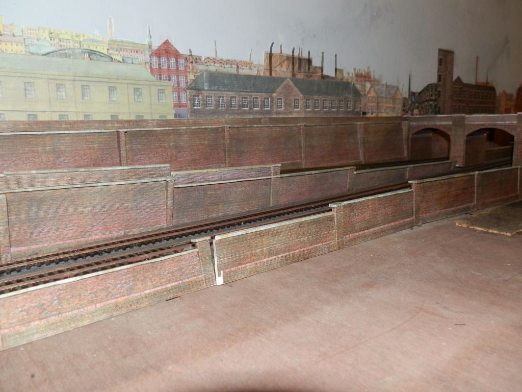

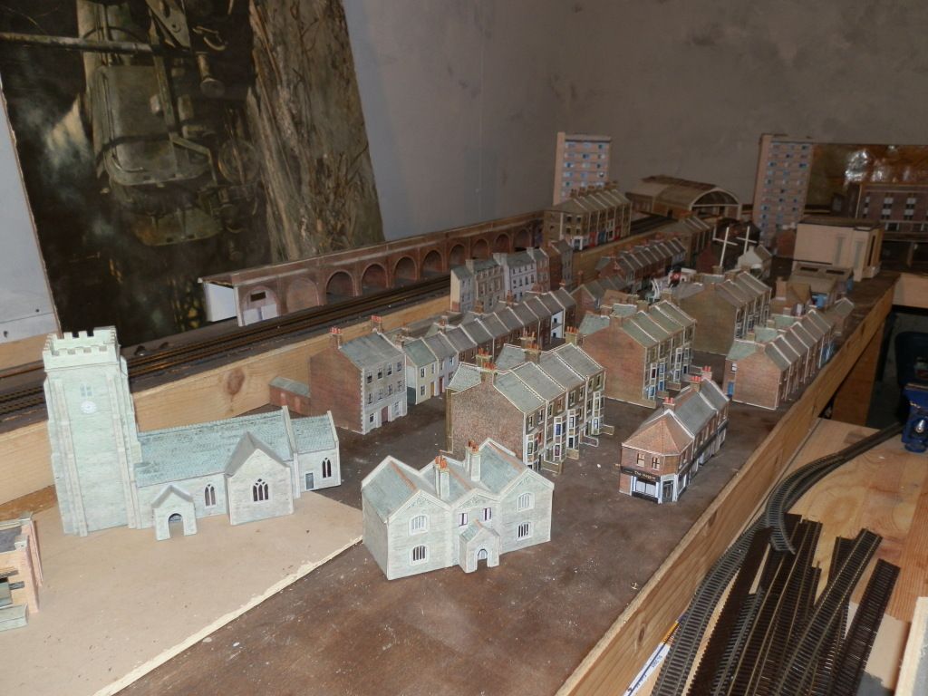

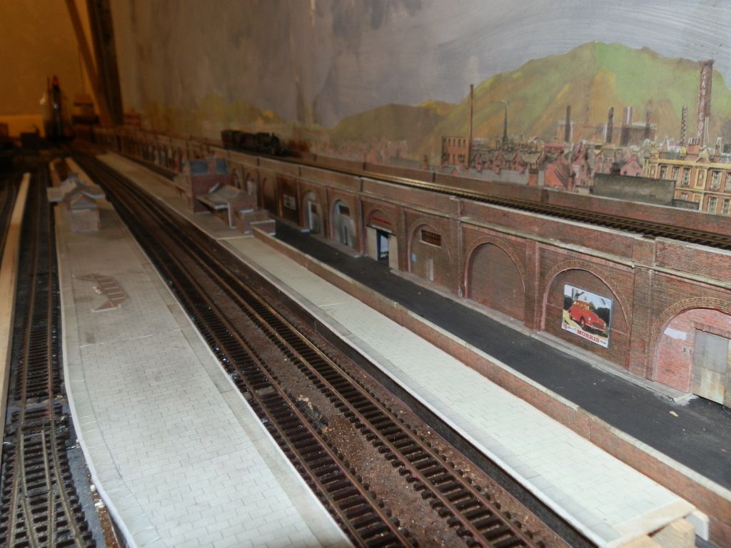

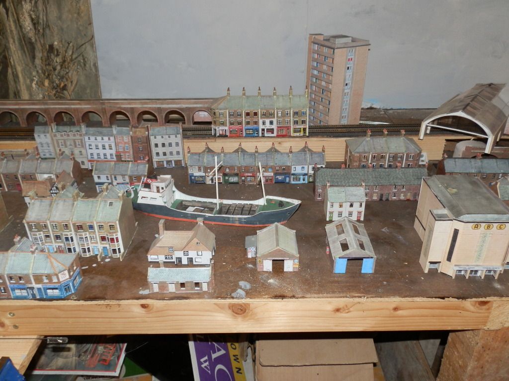

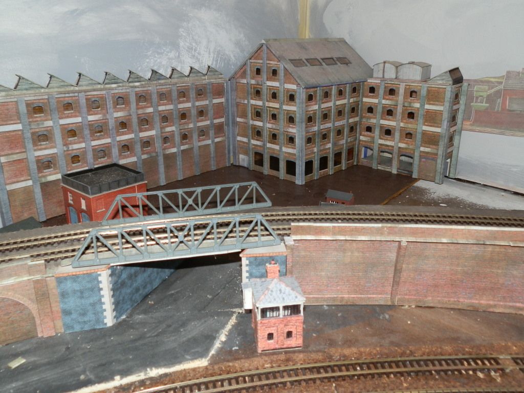

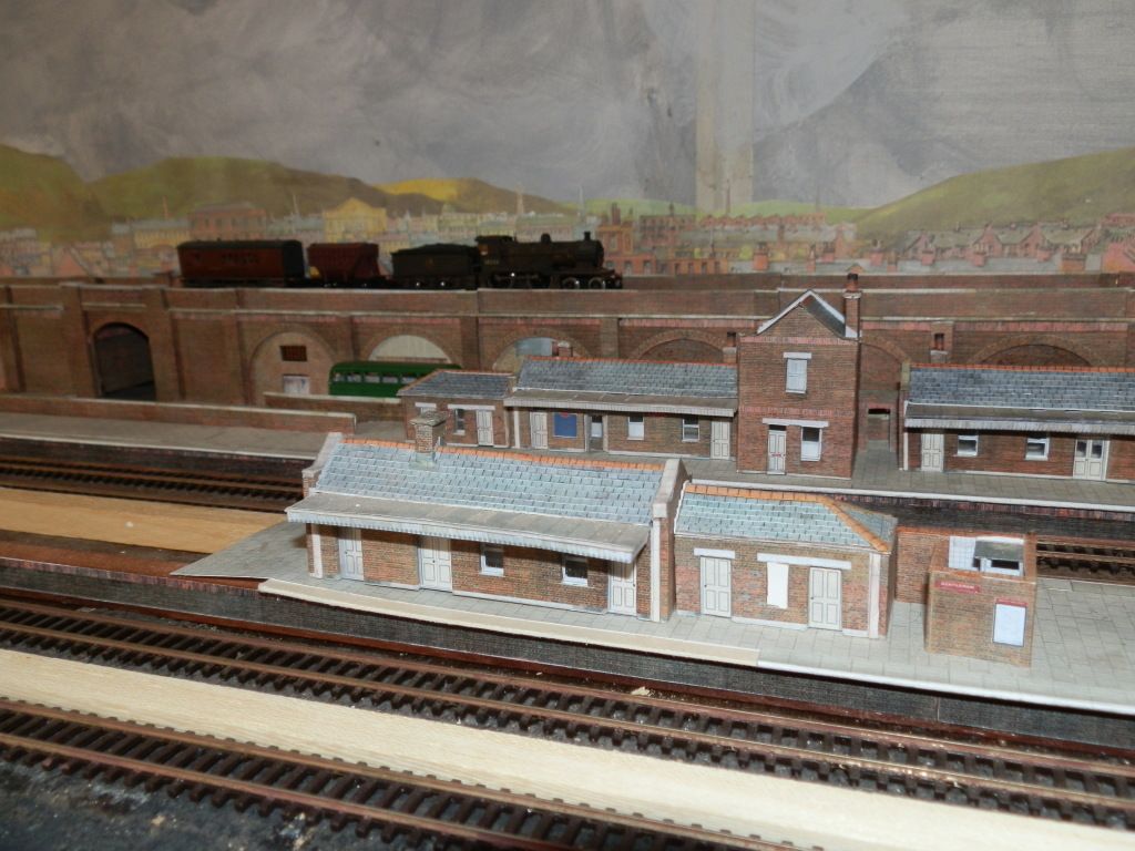

It is NOT a disease, It's an addiction, luckily I don't suffer from it as these pictures will prove.
Avoid the house backs though. Started them a few months back got to the stage where I hated the construction so much I had to go and download the oil tanks and then build another metre or so of retaining walls / arches.

If you look at the factory right on the factory roof I have used the water tower there  :nerner:

Unless it's Waterstones I wouldn't situate it in the harbour like the others >:D :D
