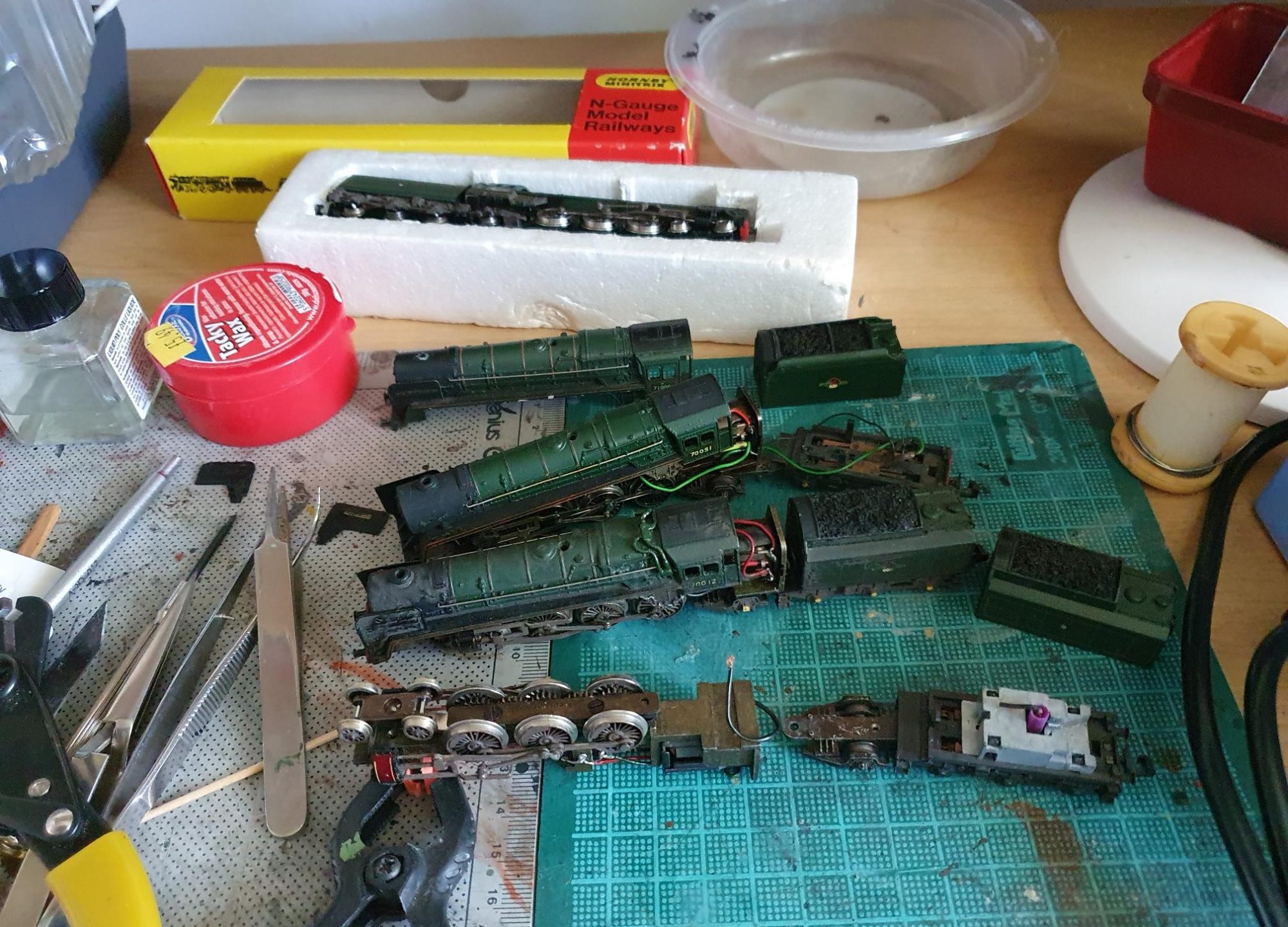

Meanwhile, here is an undercover peek inside the ramshackle, inefficient works that is SPAM Lindfield:
Currently undergoing what is laughingly referred to here as 'maintenance' are no less than four Britannias. Quite why so many ended up shedded here is a mystery. Boudicca Boadicea in the box at the back is the one with the broken crank pin, but otherwise runs fine. She is going to have a chassis exchange with the next in line, Duke of Gloucester, who can cope with a modified motion. His chassis is currently a non-runner but the Chief Mechanical Eejit thinks it is only detached/missing wires. He (the Dook, that is...) also has a missing nameplate and chimney. Third in line is Firth of Forth, running status unknown, which is going to become Hereward the Wake. Finally, there is John of Gaunt. He is OK apart from the fact that he also is missing a nameplate and needs new traction tyres. The CME is losing brain cells and there are none left in the spares box but he's coping with the stress.
Talking of the DoG, does anybody know of a source for a double chimney? N Brass is no more, of course, and BHE don't do them.
Bob G
Quote from: Papyrus on Today at 05:38:18 PMTalking of the DoG, does anybody know of a source for a double chimney? N Brass is no more, of course, and BHE don't do them.
There used to be a double chimney kit for the Peco jubilee. Also isn't there a current Farish loco with a double chimney? Farish spares are pretty good source of bits. Failing that a dead Dapol 9F?
