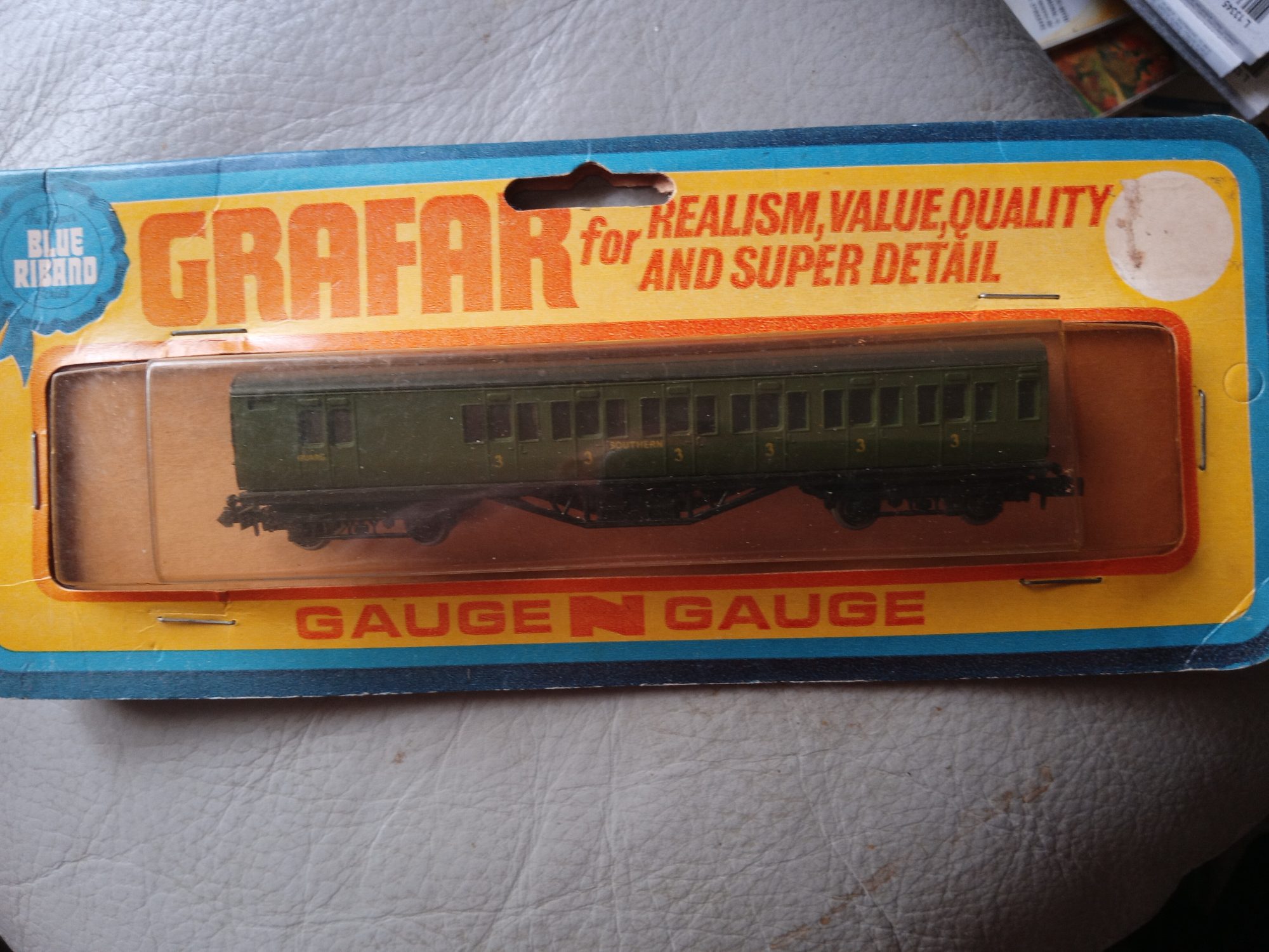

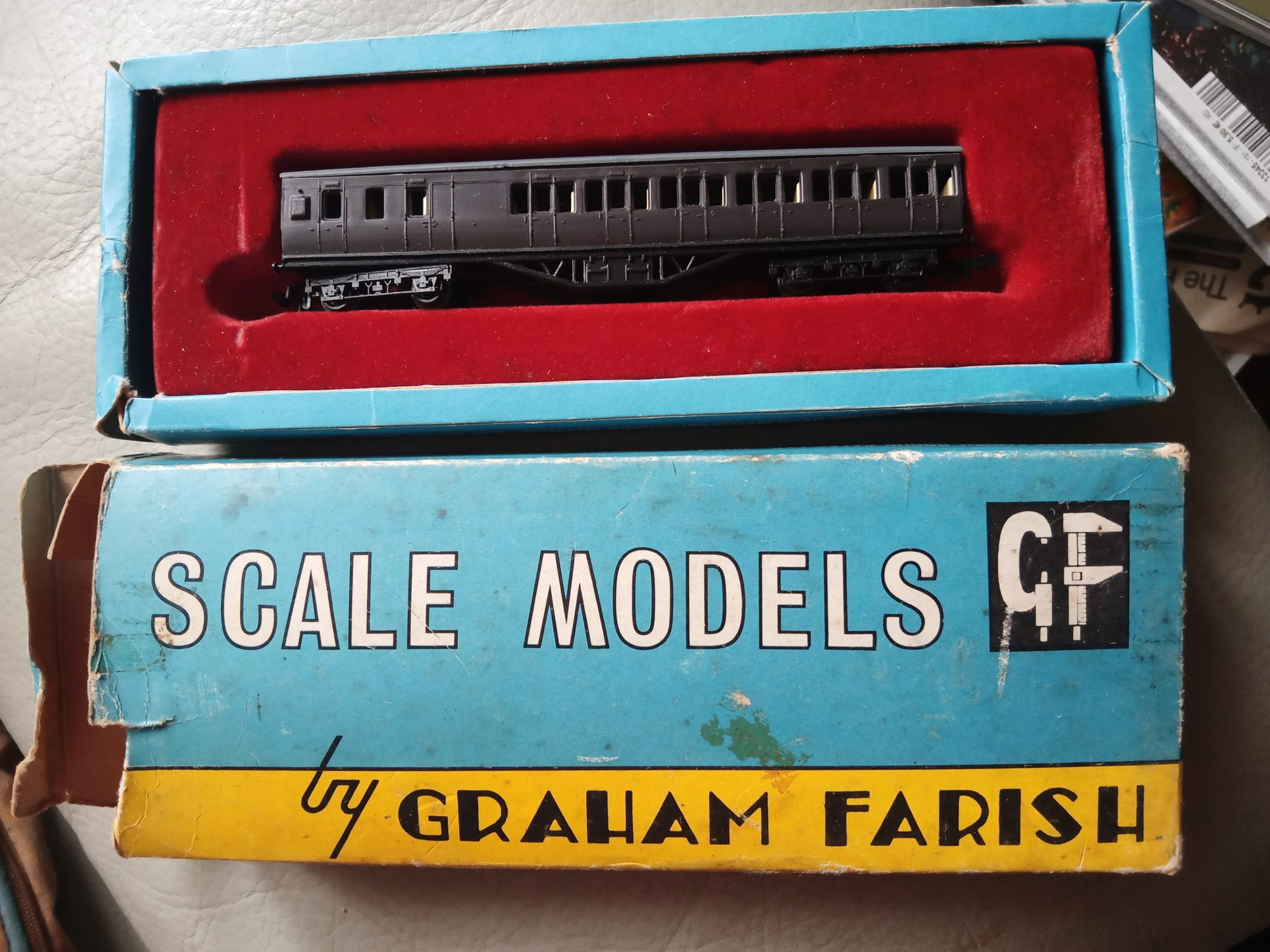

Don't know how long I've had these, 1st time the large box they were in has been opened this century.

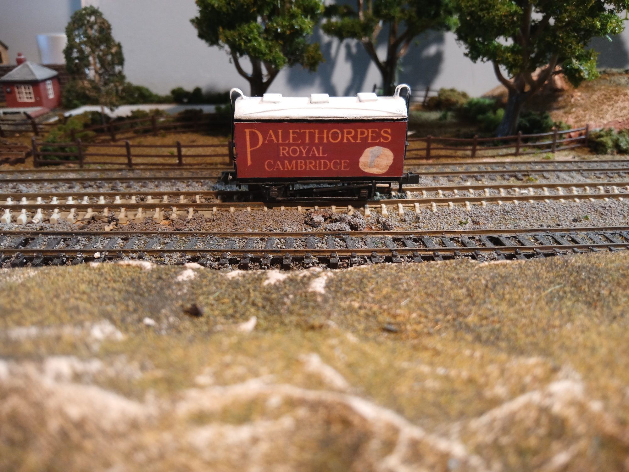

Here's one from another discussion
S&D lives on - sort of!
