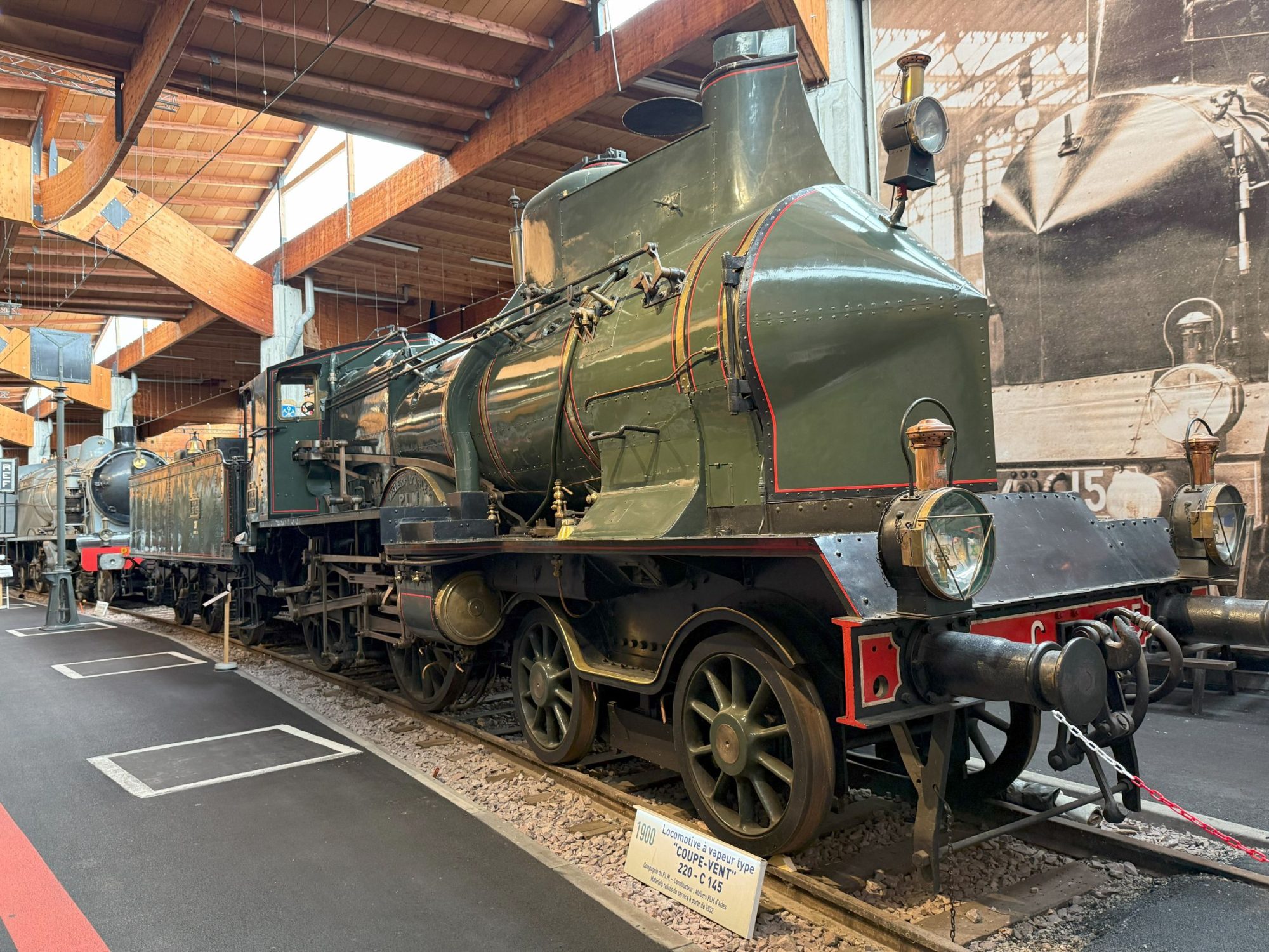

This striking-looking engine is 4-4-0 No145 "Coupe-Vent" of the PLM, built 1900, withdrawn 1932.
Coupe-Vent means "cut wind" and clearly refers to the attempt at streamlined bodywork. If this was fitted at the time of construction it must be one of the earliest attempts at railway aerodynamics.
The name puts me in mind of the 9F hauled coal trains with a fitted head that ran on the former Great Central much later. These were known as "windcutters"

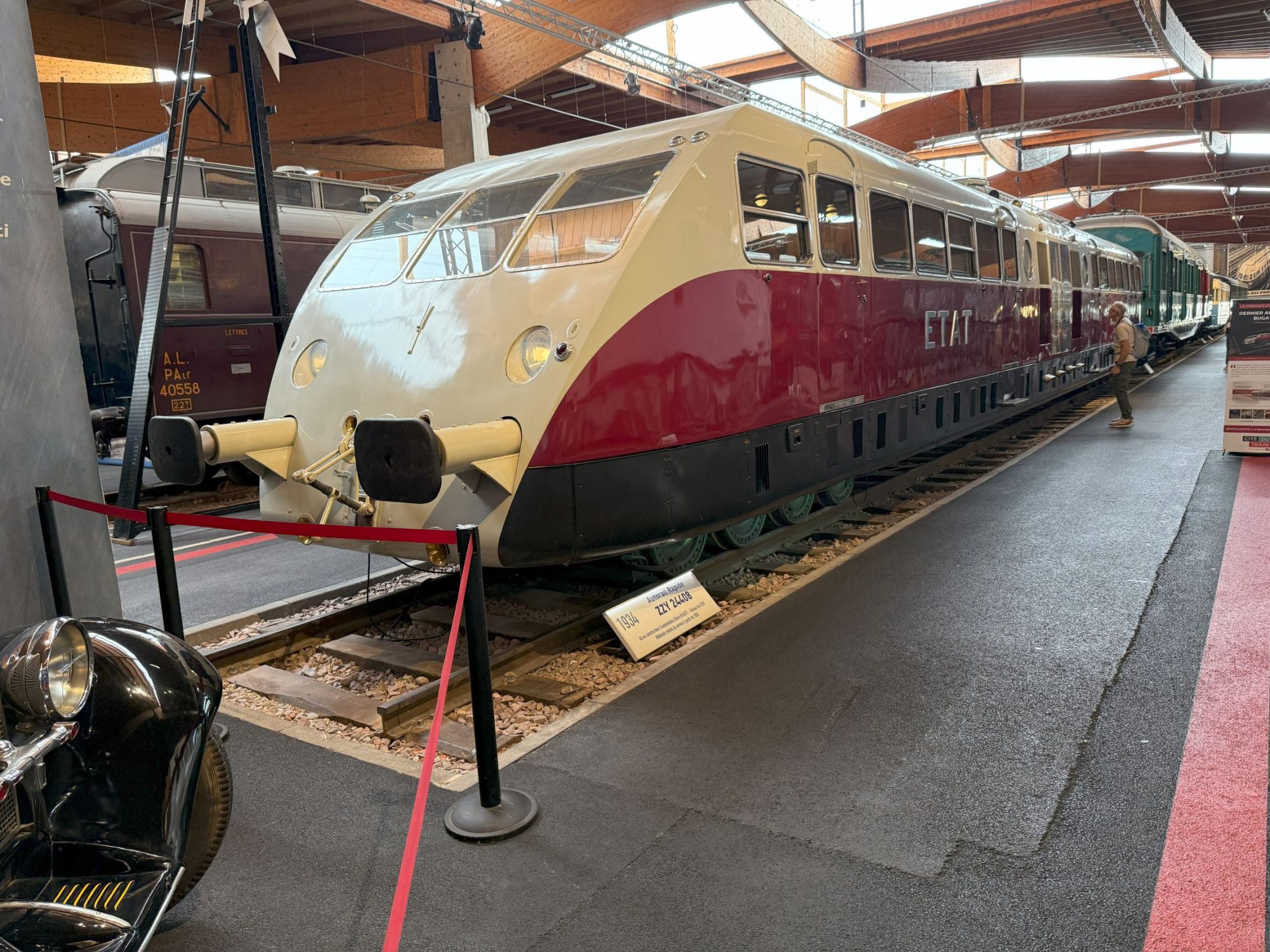

This is Bugatti Presidential ZZy 24408 fast railcar, ETAT, 1933, withdrawn 1950.
Ettore Bugatti designed one of the first modern high-speed rail vehicles in the world. His first RAILCAR was tested near the Bugatti factory at Molsheim in Alsace in 1933.
The Bugatti railcars were built as single, double or triple 'car' units with either two or four petrol engines centrally mounted in one of the cars. Each car was mounted on two 8 wheel bogies and the linked engines were arranged to drive two or four of the eight axles via drive shafts with hydraulic clutches and reversing gears.
This modular system of powered and trailer cars could be arranged in various combinations to suit the different needs of the French railway companies from the smallest 36 seater to the triple set 144 seat train.
These railcars were highly successful being light, clean and comfortable as compared with steam powered rolling stock. Their chief asset was speed and the railway companies were able to drastically reduce long distance journey times.
From the end of 1933 for five years the Bugatti factory built and maintained more than a hundred railcar units which resulted in a huge expansion of the small factory and much needed revenue in the difficult economic climate of the time.
Ettore Bugatti was not a formally educated or qualified engineer and it is remarkable that he was so successful with this revolutionary rail project which he personally conceived, designed and developed between 1931 and 1933. Every aspect of the system was carefully considered and he took out numerous Patents to protect his rights to his inventions. Many aspects of the design were developed from his ideas for motorcar components. The engines, for instance, were practically the same as used in the luxury class Bugatti car: the Royale. The cable operated twin shoe drum brakes were similar to the Bugatti car brakes of that time.
There were many entirely new ideas. The railcar chassis, body and the arrangement of the lightweight monocoque bogies with sophisticated systems for achieving a smooth, stable, quiet and comfortable ride were entirely novel. As always with Bugatti the method of construction of each part was conceptually integrated with the design of the part itself. Several of the relevant Bugatti Patents were for special machining processes and the factory layout was neat, logical and efficient.
These Bugatti railcars were designed to run on petrol/alcohol fuel of which there was a plentiful supply in France in the early 30s. However, this fuel became more expensive and eventually the Bugatti equipment was phased out on economic grounds. For a time, though, they had been a well known and popular feature of the French transport system.
This example has four engines. You can just see the front of a Bugatti Royale to the left of the picture.

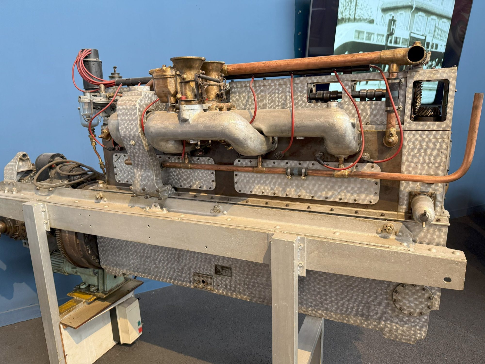

Here's one of the 12.7 litre, straight eight cylinder, 24 valve, monoblock type engines:

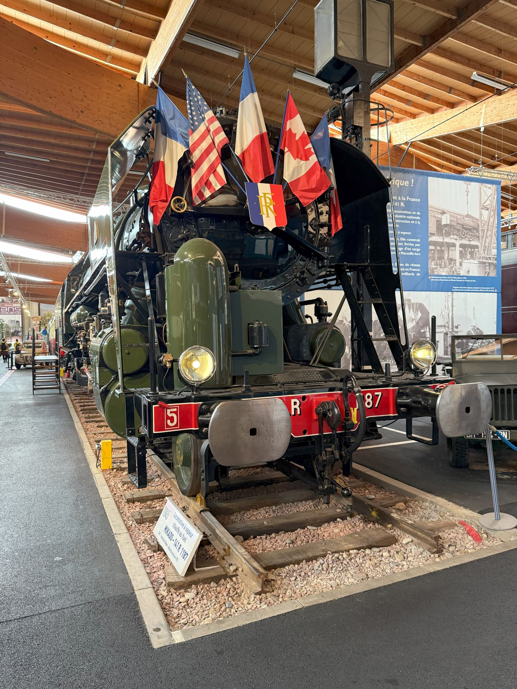

Steam locomotive 141 R 1187 Mikado, SNCF, 1945. Oil fired, built by Baldwin.
 They were used all over the French rail network from 1945 to 1974.
At the end of World War II, there was a shortage of locomotives, and to quickly obtain the large number needed locomotives were ordered from the main American and Canadian locomotive builders under the Lend-Lease Program (and not the Marshall Plan, signed in April 1948, as often written).
The design was based on the Green Bay & Western Railroad's Mikados, based somewhat on the USRA Light Mikado, suitably modified to meet the SNCF loading gauge. Modifications included the overall height, the fitting of European couplers and buffers, left-hand drive, smoke deflectors (to a unique and instantly recognisable style) and a Kylchap exhaust on the second batch.
The first order for 700 engines was placed in February 1945 with production split between the "big three" American locomotive builders: Baldwin Locomotive Works, Philadelphia, Pa, American Locomotive Company, Schenectady, NY, and Lima Locomotive Works, Lima, Oh. Once financing was made available, the second batch of 640 engines was ordered from the "big three", plus the Canadian manufacturers Montreal Locomotive Works, and Canadian Locomotive Company, Kingston, Ontario. Most of this batch were built as oil burners, burning preheated heavy fuel oil (known in French as 'Mazout'), unlike the first batch which had all been designed as coal fired.
The massive introduction of oil fired locomotives was due to the fact that in the immediate post-war period, quality coal was in high demand and SNCF was consuming 9 million tons per annum. Oil thus allowed savings in coal, even if in many depots it required a revolution in working conditions. The extra range permitted by oil—700 km (435 mi) instead of 400 km (250 mi)—explains also the more intensive use of the locomotives. The enginemen nicknamed the locomotives mazoutières or charbonnières ("coal-scuttles") according to fuel employed; oil-burners were also called les goudronneuses ("tar spraying machines") by their crews.
After the second world war, the American manufacturers' output had been boosted by the war effort. Thus from July 1945 to May 1946 the 700 141 R of the first batch were built in only eleven months. slow down in February and March, and to continue until finished in May, an average of almost three engines per day! By way of comparison in French locomotives works (French industry having been weakened by the war) it took four years, from June 1948 to July 1952, for the manufacturer Schneider to deliver 35 241 P to the SNCF.
For the SNCF, this type of machine constituted a small revolution – with simple expansion and very advanced construction techniques, the 141 R 1101–1340 were the only SNCF steam locomotives equipped with Boxpok wheels, and roller bearings on all the driving and coupled axles, as well as a one-piece cast steel frame. The bar frames and the axle box bearings of 141 R 1–1100 were excellent which made them powerful machines but economical to maintain. For 141 R 1101–1340, the maximum mileage run between two main works visits was up to 230,000 kilometres (140,000 mi). Easy to drive, they offered relatively modern comfort for both drivers and firemen. The cabs were fully enclosed, equipped with comfort and ergonomics hitherto unknown to SNCF crews. Driving and firing controls were within reach while seated, with automatic coal feeding thanks to the mechanical stoker, and oil-firing was even easier. They were banalisées ("standardised"), that is, not assigned to a particular crew.
On 19 October 1975 the last 141 R in use with the SNCF, 141 R 1187 of Vénissieux depot, worked a special return working between Lyon and Veynes. Four locomotives of Narbonne depot were leased to the Hellenic State Railways from November 1973 to April 1974.

This caught my eye:-
Quote from: Ali Smith on September 17, 2025, 11:18:31 AM[...] Here's one of the 12.7 litre, straight eight cylinder, 24 valve, monoblock type engines: [...]
Presumably two inlet valves and one exhaust per cylinder.
Pre-War there was a fashion to fit single-cylinder motorcycles with two exhaust ports and twin exhaust pipes which gave the stylish but false impression of two exhaust valves. Ariel and Panther were especially keen on this arrangement. Rudge did things properly with four-valve cylinder heads.
I hope there's more to come...
