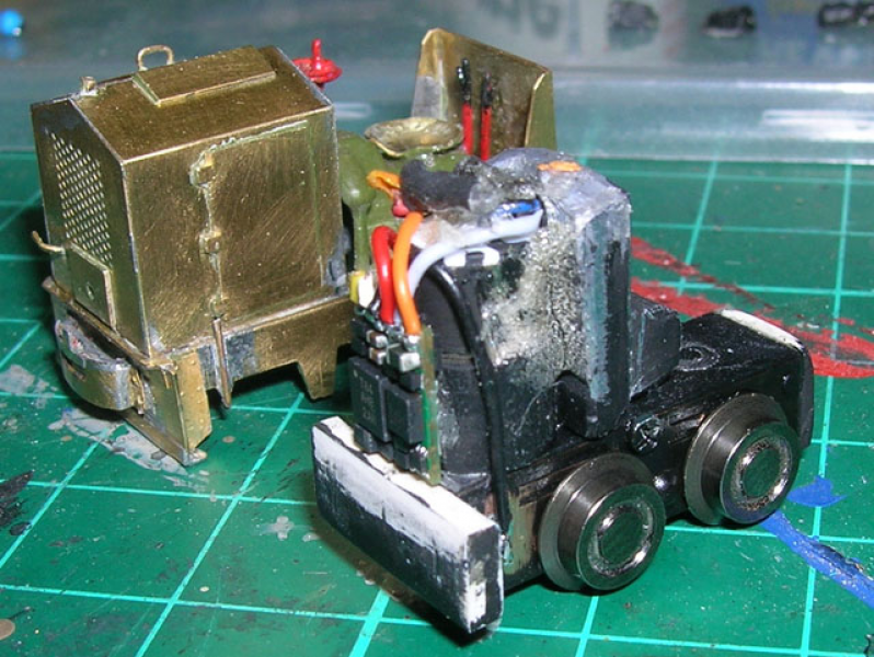

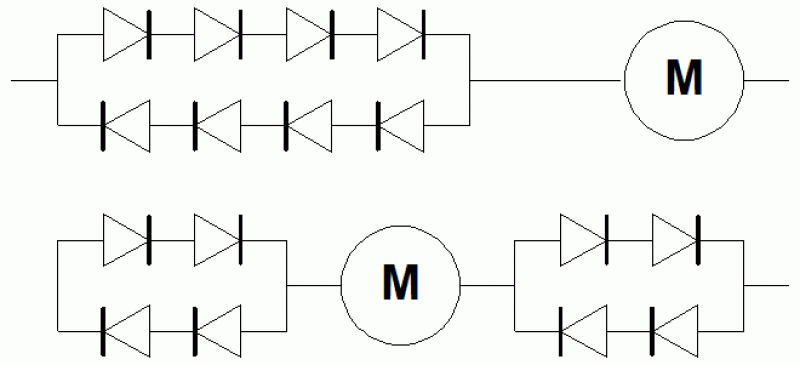

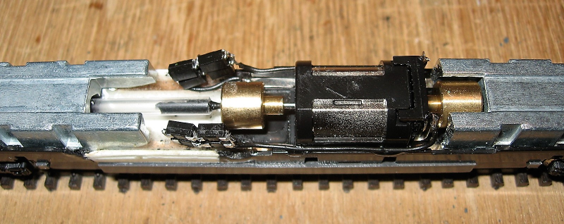

I have a railcar with a Tomytec chassis which tended to run rather faster than other models on my automated shuttle, so for that one I use a string of diodes wired inverse-parallel then in series with the motor.  Each diode reduces the voltage seen by the motor by about 0.7v.  It's a bulky solution though, even with SMD diodes but it has tamed the speed to better suit the automation.
I also have a DCC fitted tiny 009 shunting tractor which has a 4.5V motor: for this one I've used a decoder specifically designed to run low voltage motors (I thinks it was either a TCS or a CT Elektronic decoder).

Hi, thanks for the reply and the pics.  Yes, the motor has to fit in a specific space hence the size requirement.  The loco works ok providing I don't wind up the control knob too far ! I had found a similar schematic using surface mount diodes but space inside the loco body is sparse so I didn't go down that route in the end as the loco needs weight added to help it run. Wheel for it are another challenge, no greater than 7mm diameter and I need to adapt them for conrods and valve gear.  The nightmare of that is yet to come,  :D  :D  :D I will most likely just keep the control knob low power and try not to forget to wind it up too far.  Thank you !
