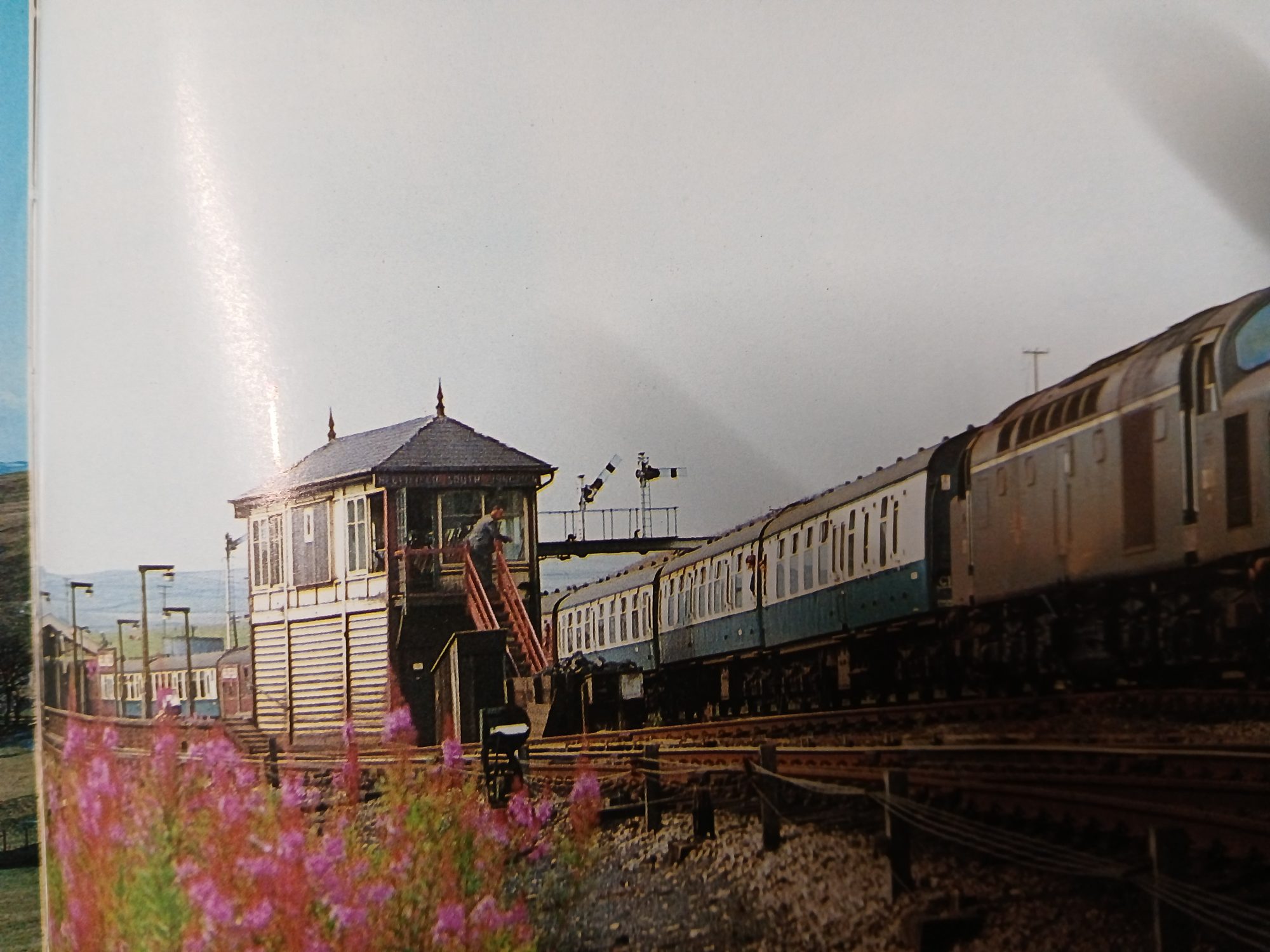

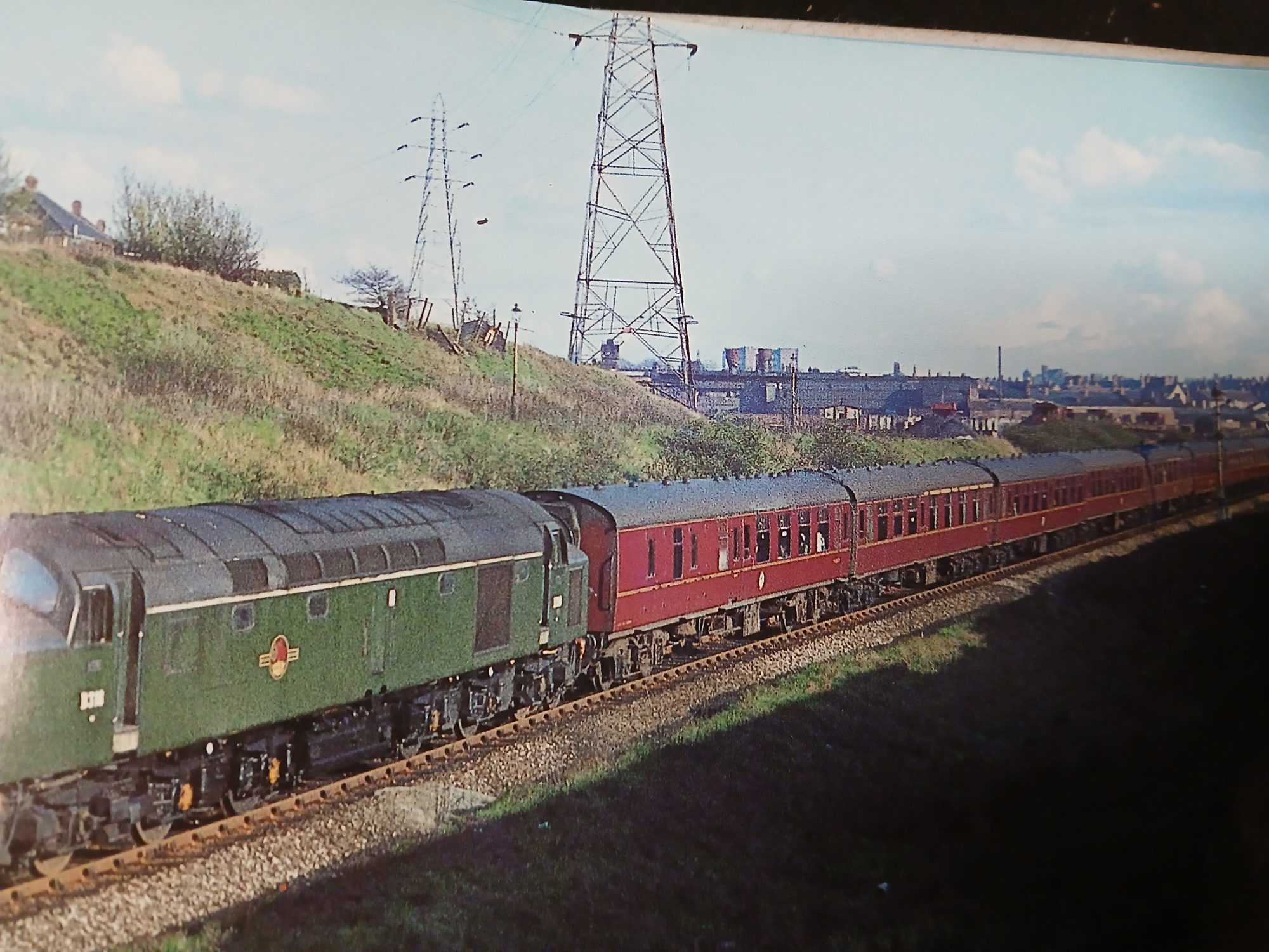

Photo I found Rail Portfolio
1, editor M. Bennett,  1984
D318. Wednesbury
Diverted Birmingham Snow Hill  Liverpool Lime Street/ Manchester
24.4 66
Photo M. Mensing
Clearly BR maroon
This one shows Blue / Grey plus a maroon coach visible behind the signal box.
Hellifield
D339. 4 August 1968
Edinburgh Birmingham diverted
Be interesting if anyone else finds useful photos
