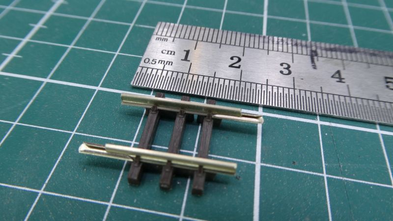

I've cut you a little bit of track, 2cm long ...
I used a cutting disc on my dremmel, and slipped a couple of rail joiners on  :D

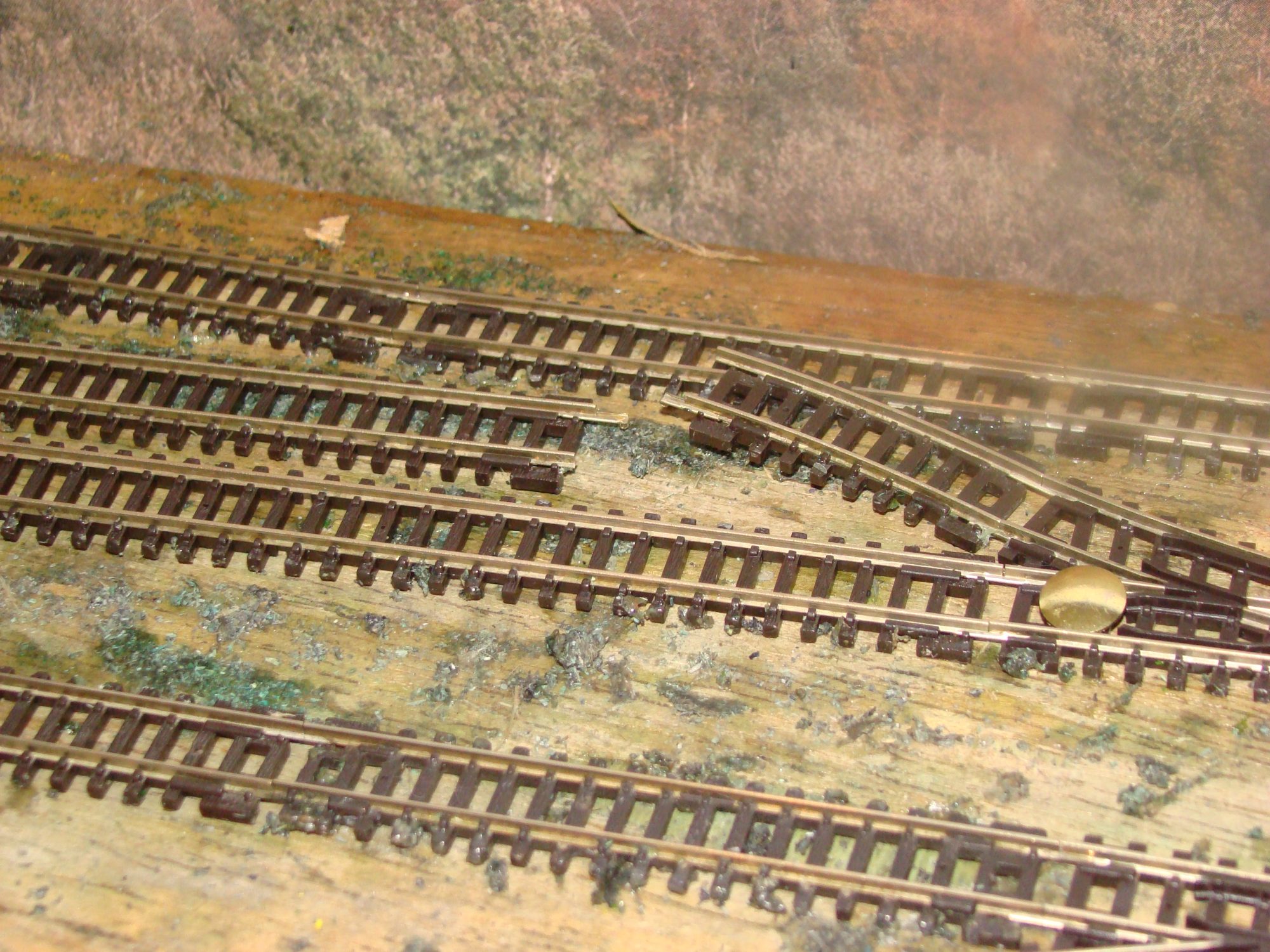

As requested by NTPNTPNTP , a photo of the reason for the new piece (as supplied by Kevin).
From the main circuit, the original junction was point (Peco ST6), small straight (ST1) and another ST6 and then a short curve (ST4). The points then led on to 2 sidings. Now that the track has been re-laid , the photo shows the dilemma and the need for the short piece of track.
Thanks to all for the advice and comments
#21
Hmm that looks like the wrong curve to use after the Setrack point if you want to go back to parallel tracks?  You need an ST-3 standard R1 curve to match and counteract the 22.5 degree angle of the point.   That piece you have there looks like an ST-4 half curve? The angle is wrong as well as it being too short.

Thanks Nick , it did seem to fit , I guess that's why there were track issues initially.

Just to throw another spanner in the works if it were me I would look at replacing the short piece you have with a longer piece rather than filling the gap with a very short piece.
geofff
Hello Trainfish
If I finish it , I'll show a photo of where the new piece fits. It's to move the whole junction away from the rail that the small curve is touching. Thanks for the input.
