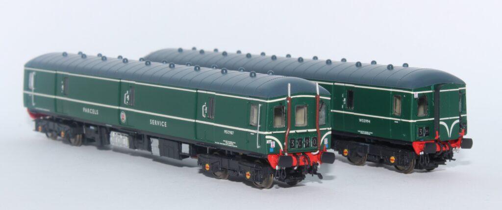

Huge frontal differences. MR (left) has central headcode and no corridor connection - WR (right) has split headcode and corridor connection

The pic was a lift from the Revolution website very early on in the scheme of things and hence the grey cab roof on the WR one

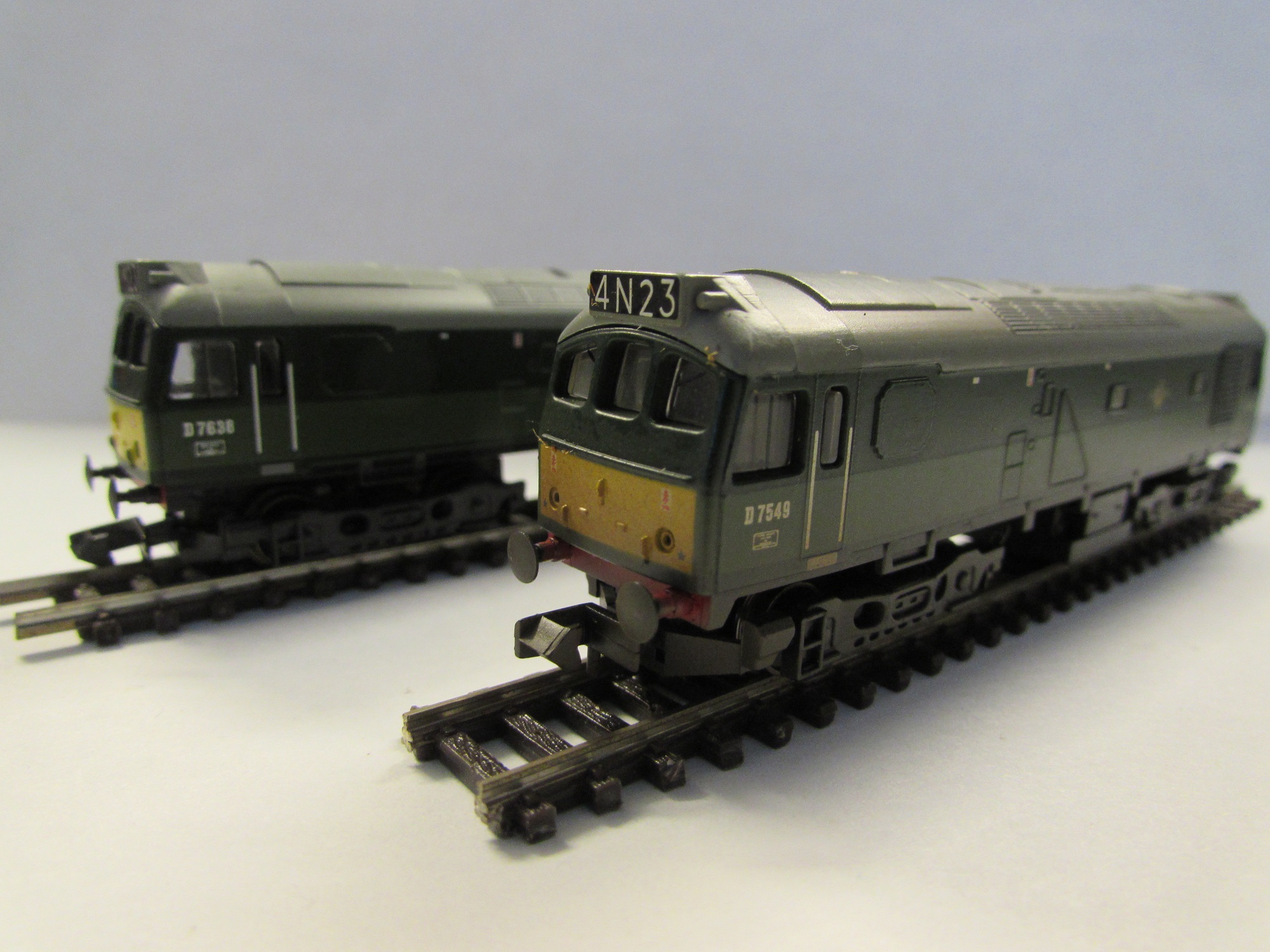

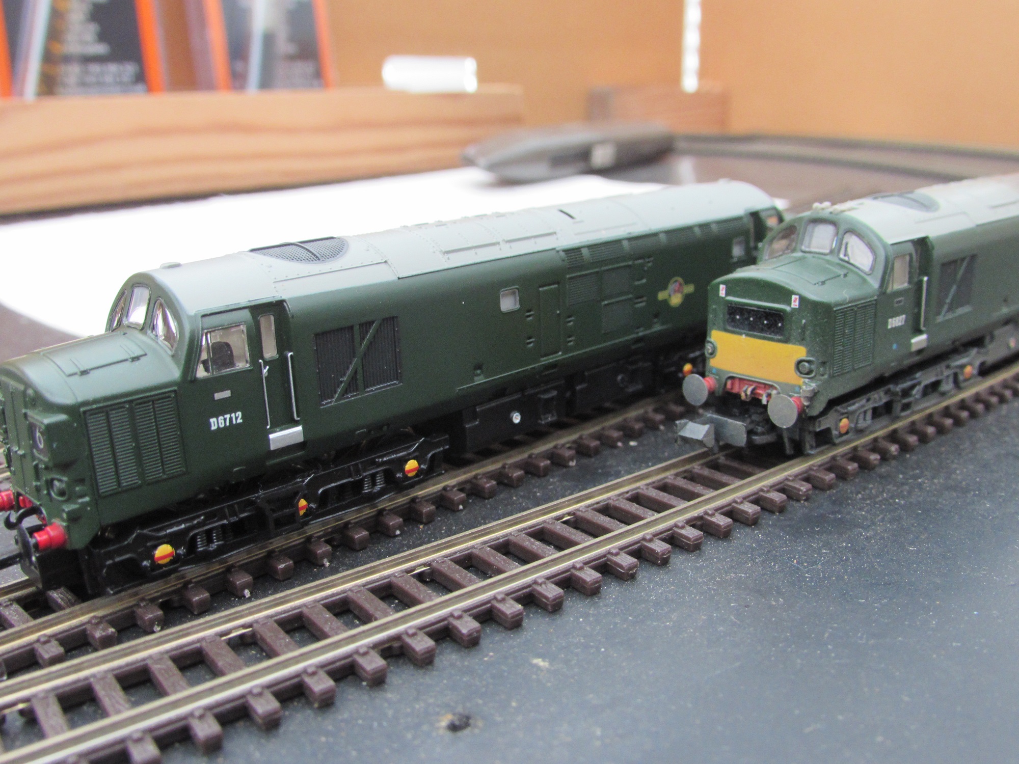

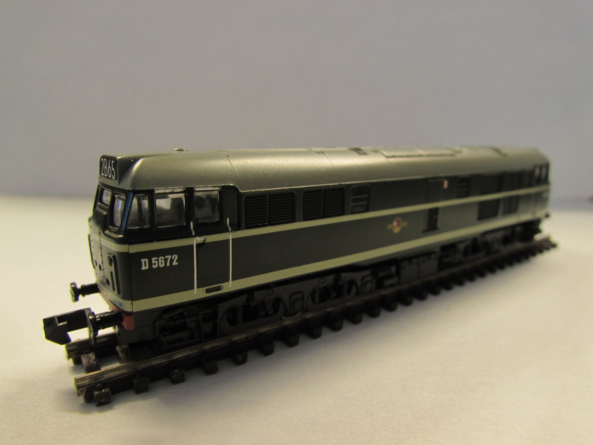

Looks like we have the club layout up and running again so last night I took some 'old' Farish stock along. These included old class 25, 33, 31 and 'not so old' class 37. All ran spectacularly well so I'll be taking these to the Colne show in November. OK, they don't have the fidelity of the more recent models but there will be times when other folk will be running my stock and I'm still of the opinion "if it looks like a class 25, it is a class 25"

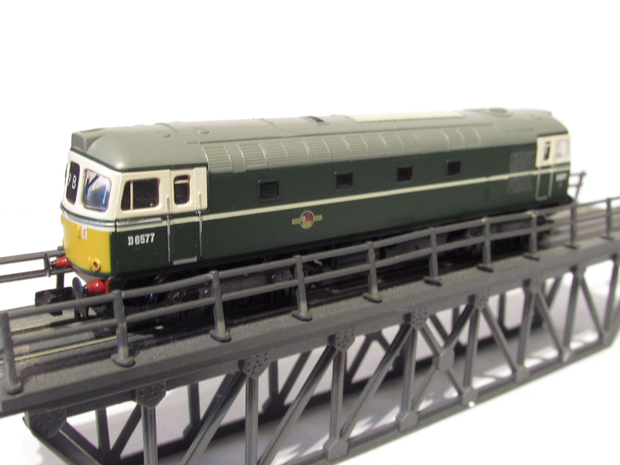

Oddly I don't have a pic of my old Farish 33 which I'll have to remedy :hmmm:
Edit: Class 33 pic taken
