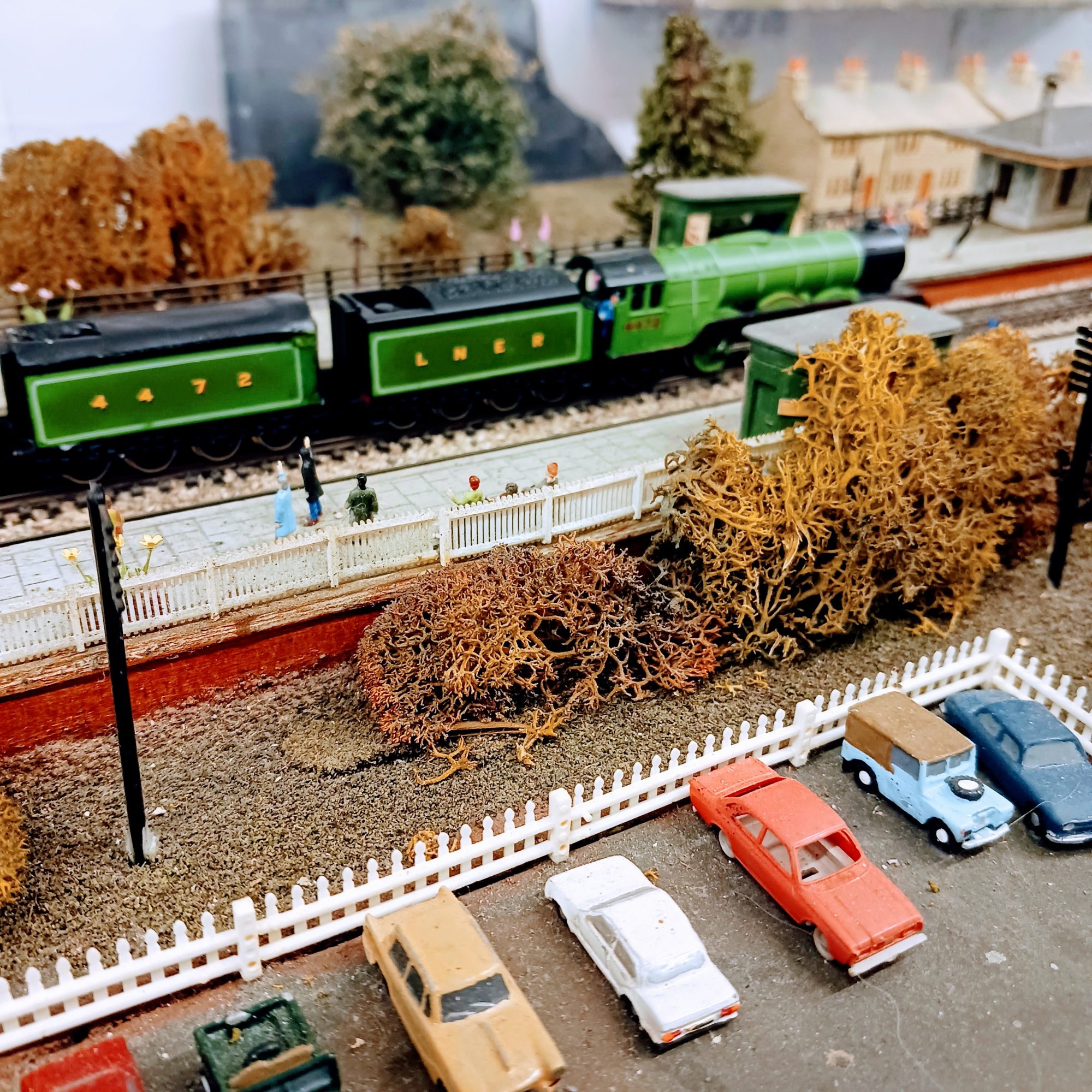

I made my second tender from a standard Farish one ,
But there is so much drag that I had to remove most of the metal and the pickups and now the loco just about manages the two tenders and 6 Minitrix coaches that I had to remove the weights from but I am not a rivet counter and I am happy with my effort .
A fellow club member then very kindly removed the letters and put the  numbers on for me as my hands are not steady enough now .

Hi with bobs permission @Bob Tidbury
I was visiting a while ago
Here is Flying Scotsman <img src="https://www.ngaugeforum.co.uk/SMFN/gallery/136/3894-241023012644.jpeg" />
The only photos I have
