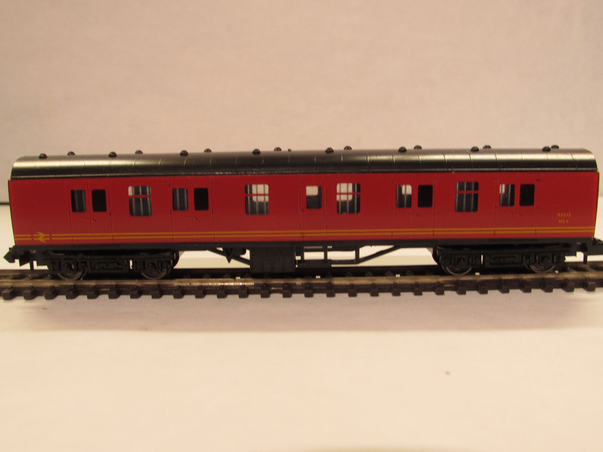

Here's the relevant BG with the newer wheels and I think this simple(?) change makes a huge difference over the silver originals
