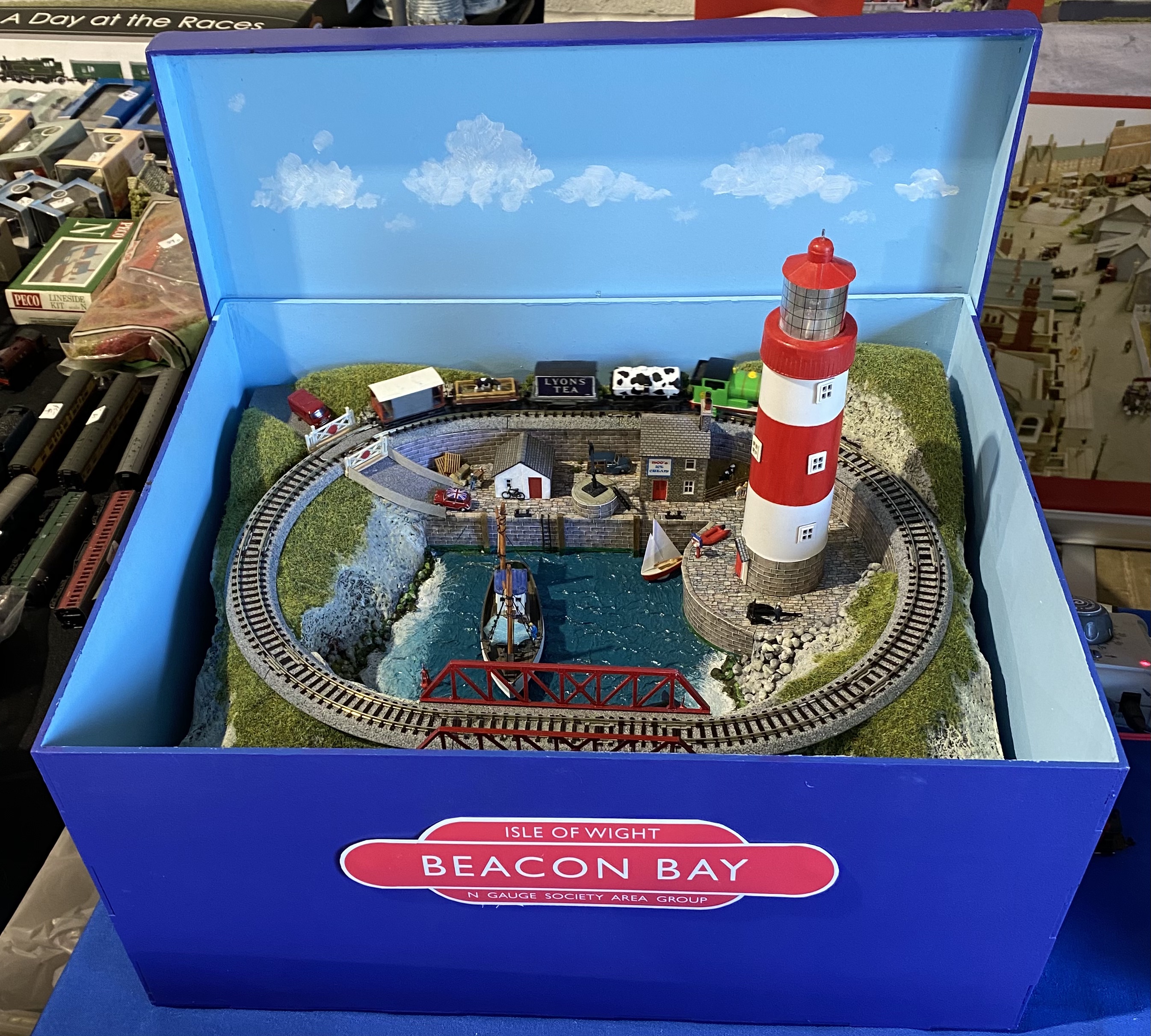

I have just made a micro layout that fits into a mdf storage box that measures 320mm x 400mm by 190mm deep (it doesn't need this depth but I already had the box)
It has an oval of Kato 117mm radius track.
The layout is a removable insert that fits into the box which made it much easier to work on. I'm in the process of making another insert/layout for the box.
I found the Kato track very good to work with and would recommend it for ease of use. I can run Farish Austerity tanks, Poole Farish 08 shunter, Minitrix Dock tanks and a Tomix Percy. They pull a selection of Peco four wheeled wagons and a short wheel base brake van.
I'll try and post a photo.
PS The lighthouse folds down for storage.

@silly moo very nicely done Veronica. Likewise @EtchedPixels The picture in your post is not showing for me, but having looked at the link, another nice layout. Just goes to show that you do not need a big space.  :thumbsup:
