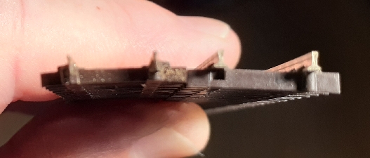

Easy... Code 80 sits in the chairs on top of the sleepers, Code 55 rail is embedded in the sleeper base. Bend Code 80 tightly and it has a habit of popping out of the soft plastic chairs.

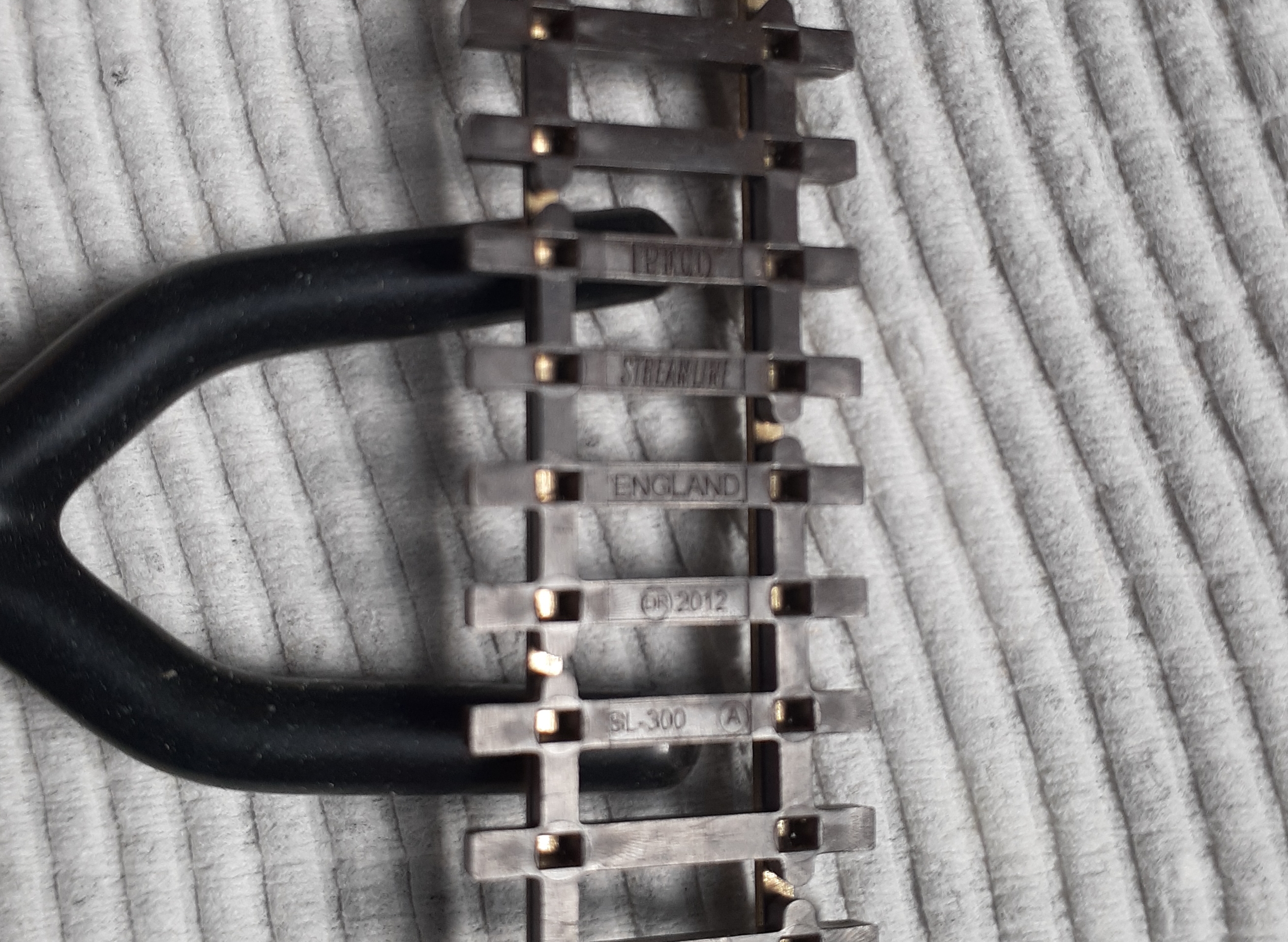

Code 80 is labelled as SL-300 on the plain track
Code 55 (on left) has some track embedded in the base, where Code 80 (SL-300) sits atop the base.
Code 55 comes in yellow packets/labels while Code 80 has blue.

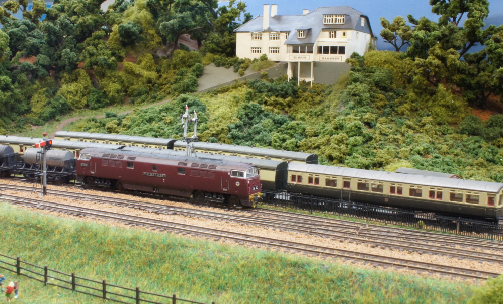

This is one of my layouts that used code 80

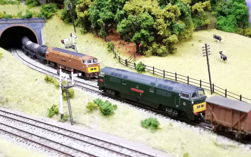

And this one uses code 55
Yes code 55 is better but the when the rail sides are painted there isn't a lot of difference. British Finescale code 40 track would be much better but I really am not into building my own track. I can see why some folk do though.
