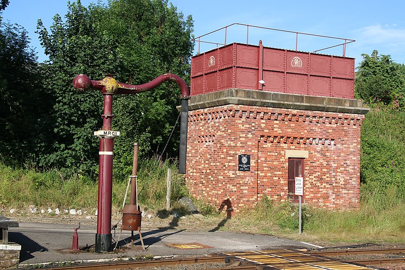

The Q
Heres a picture of a fire devil in position, under the parked arm of the water tower.
Highland railways didn't need a separate fire devil, their water towers had it built in, with the firebox in the side of the tower,  the heat ran up the sides of the main tower.. inside the chimney surrounding the tower water tube.
