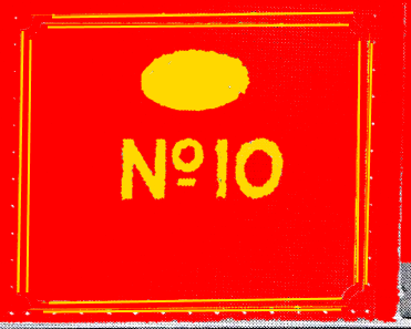

I designed a set of decals for my Peckett saddle tank project and printed them out on decal paper using a laser printer. They are yellow text and lining to go on Tamiya Dull Red paint. I tried a test decal to see how it looked, and I was hugely disappointed to find that the print was so faint as to be illegible against the red background. The decals are set to pure yellow which I would have thought would have given the densest colour. How can I make the colour more intense? The main colour is quite dark, so I don't think darkening the yellow would help.

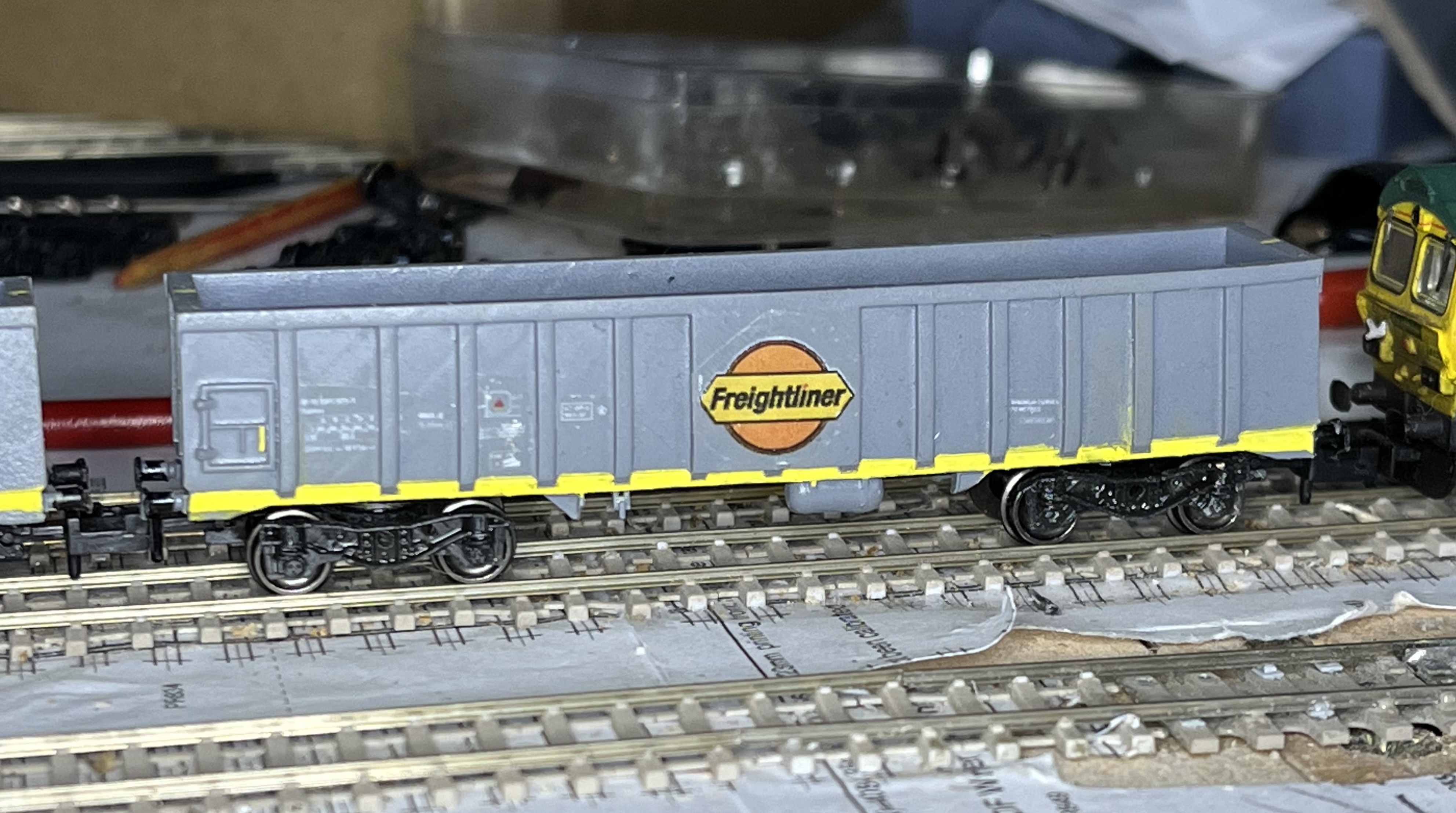

I have a Ghost White toner and I print a white 'under decal', then apply the proper one over the top. I don't do 'two pass' printing, as it doesn't tend to be accurate, I just apply two decals. Makes a huge difference.
The Freightliner logos were done in this way (the white lettering is straight from the Ghost White toner). This really highlights the edge of the decal paper, must sort that!

Just did this using Paint.net. using the standard red & yellow. If you can get the red to match..........
If you print on white decal paper this will be fine.
