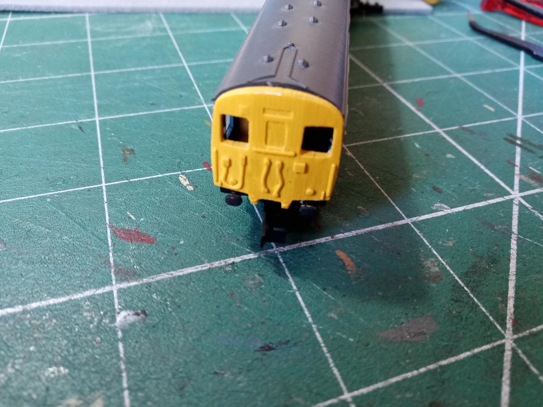

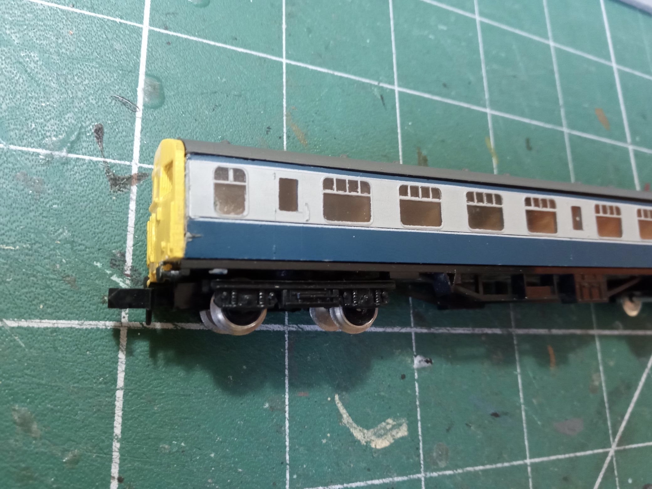

Hi All,
Need some help identifying what was attempted to be created as part of a conversion I picked up in an ebay lot.
It clearly started as a mk1 blue and grey coach, with one end neatly removed and replaced with what looks a 3D printed DMU end.
What I'm not sure of though, is what DMU was aimed at, and therefore how accurate it is.
Depending on the answer, I may either attempt to complete the conversion or use a spare mk1 body to put it back to how it was.
Any help appreciated!

Could it be a Class 302?
According to Wikipedia: "This class of multiple unit was constructed using the Mark 1 bodyshell and was slam-door."

Top marks to @Platy767
The cab ends are representative of the Class 302 (3-car Fenchurch St - Shoeburyness) and 307 (4-car Liverpool St Southend) units. Both had pantographs sited above the guards accommodation.
However the bodies of both units should be multiple slam door and there should be a bit more of a roof projection over the cab front (like the Farish 4CEP).
The 307 units were built at Eastleigh/Ashford so there is a southern EPB ancestry to them. The later 302s were York/Doncaster built, but used the same cab style.
I think they should really have the sides stripped of paint and e.g. brass sides (or Electra vinyls) added.

Thanks both.
I think in that case, it's likely getting put back to a mk1. It's looks nothing like a 302 or 307 other than the replacement cab. Also, with having only one end, going to struggle to make a full DMU!

 :( There is work to be done either way and an EMU (even a single or double car)  is FAR more interesting than another Mk1!

It's a Class 302 front end. The Class 307 had narrower windows. Both were 4-car sets. The 302s were originally DC powered so open up a whole extra dimension.

At the risk of being pedantic, it was the 307s that were originally 1500DC units, they were extensively rebuilt to 6.25/25KV AC in the early 60s when the GE electrification was changed. 302s, despite the earlier class number were always 6.25/25KV AC.
Agree with others, that's a 302 front end.

No. That's not being pedantic, @AdrianC . That is just fact, and you know your ER EMUs better than I do.
It is @Neil of Teesside that is being pedantic, suggesting that the windows on the 307 are narrower, and that you would notice this at a scale viewing distance of 300 feet.
There is a whole thread on advising a modeller what to worry about here: https://www.ngaugeforum.co.uk/SMFN/index.php?topic=56651.new;topicseen#new
Given that @Dalteth acquired this conversion with a 302 front end stuck onto a Farish Mk 1 coach, and without the roof projecting over the front end like both the 302s and 307s did, I think that is far more obvious a compromise than the windows being a bit narrower on the 307.
Plus nobody has commented on the MU jumper leads yet, which are wrong for early 307s, but consistent with 302s and later 307s.

Thanks - always get them mixed up.

The windows of the 307 stop a good 6 inches short of the central flat panel, whilst the 302's windows go to the flat central panel. Visible at any distance. Pedantic maybe, but a fact that is readily spottable.
