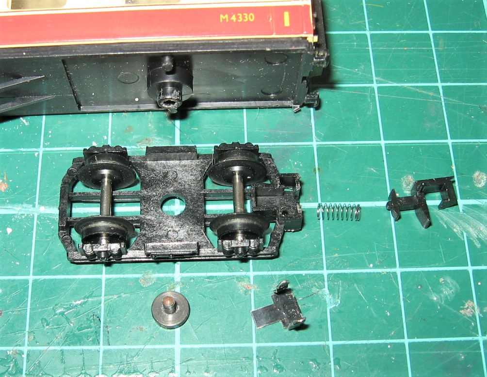

The coach will have a pocket to take the traditional "T shank and spring" coupling.
The bogie is retained by a screw so undo that and remove the bogie.
The coupling pocket has a metal cover plate underneath, secured by two small tabs on the top side. Bend those up and straight and you can remove the cover to gain access to the pocket.    Be careful of the spring pinging away!
Fit new spring and coupling, and replace the cover plate bending the tabs back over.   Re-fit the bogie.

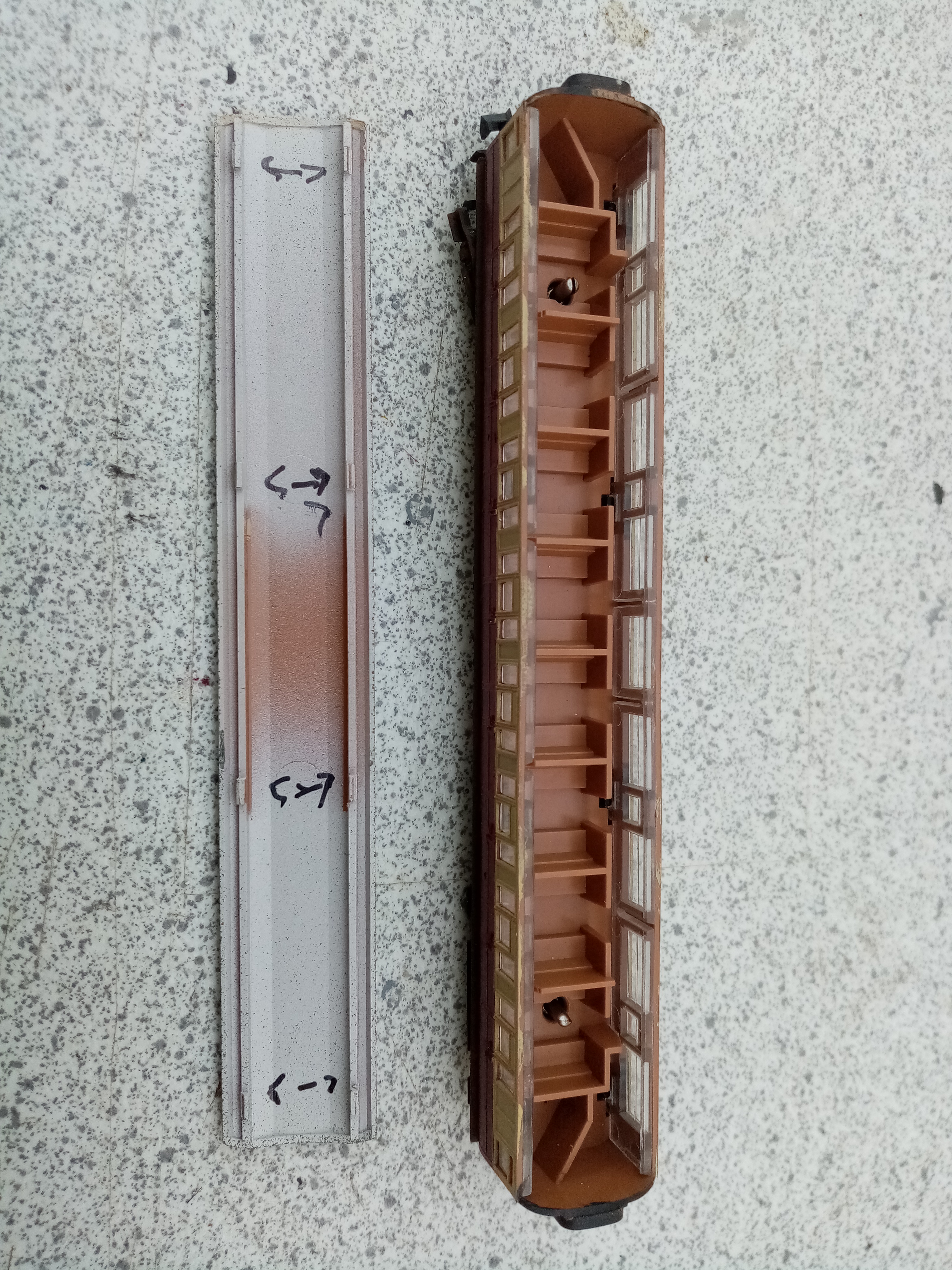

martyn
#6
@mojo ;
Maurice, it's a bit more complicated than I remembered......
The arrows on the underside of the roof show the roof clips. This needs easing off, usually finger nails between the roof and side.
Once the roof is off, the body is retained by another set of four clips each side which then need easing off. I use a small screwdriver to spring them back clear. The position is just visible as a black dot on the coach side in the photo, they are more or less the same positions relatively as the roof clips.
Once the body is off, the C-clips are exposed to remove the bogie.
HTH
Martyn
