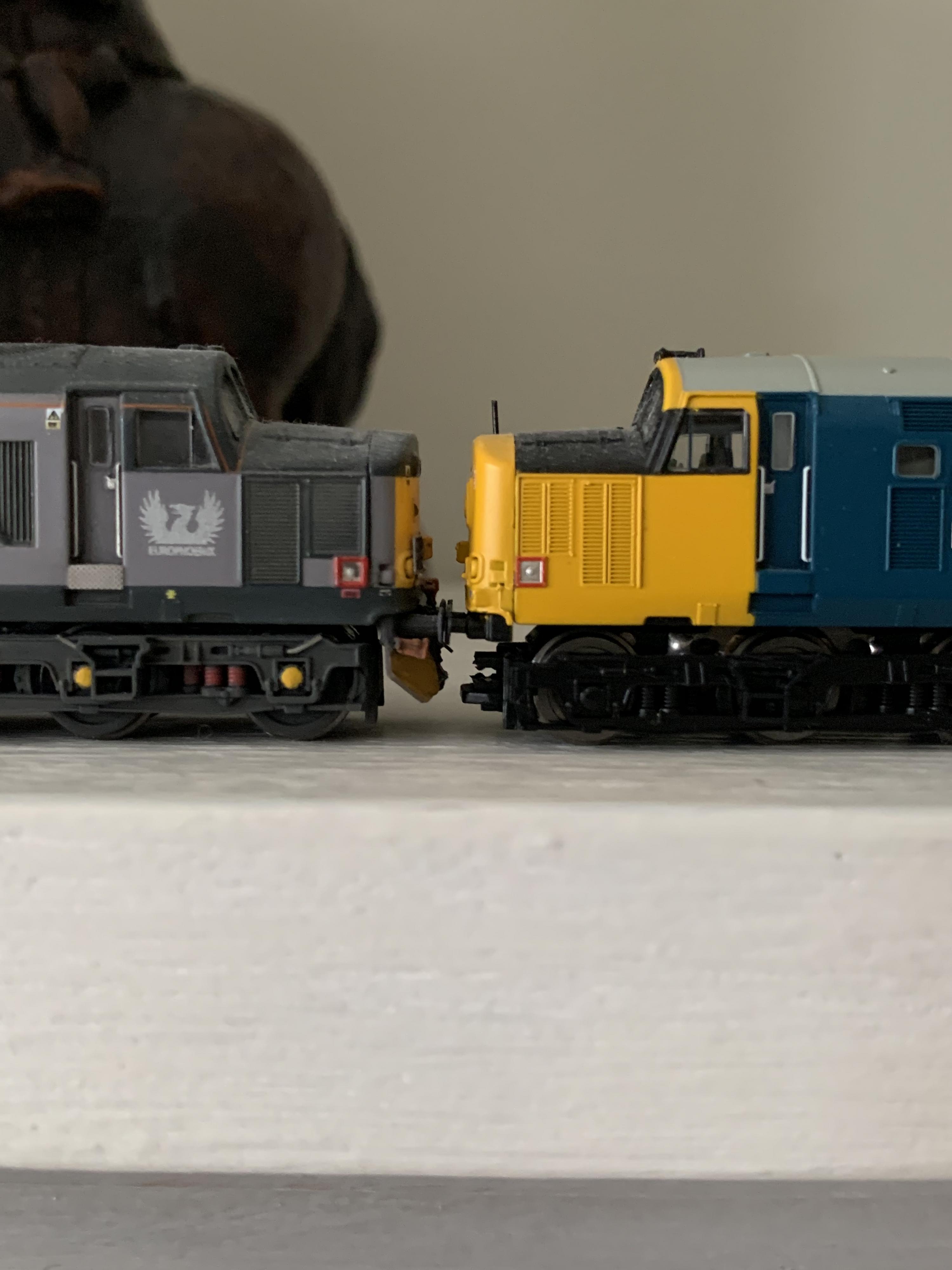

The 37 does ride too high. I've got a 'lowered' one (on the left), and it does make quite a difference. Mine has been done by brining the bogie frames up, but you can also do it by actually lowering the body, so its plausible they're riding at different heights.

In relation to the 37's ride height - I've got a couple of 37's and a couple of 47's and the gap on all four (before I butchered them) was completely different.  The 47's were worse than the 37's, but all of them had very un-prototypical gaps between bogies and body, and it was something that to me, made them look like N gauge in pictures.  After some trawling of the forum I did find the two solutions mentioned above and opted for the cutting of the lighting PCB's to lower the body on the 37's.  The 47's were more involved, and despite being relatively easy to lower the body, the running wheels were then catching on the buffer beam.  When I looked at prototype photos the buffer beam looked smaller so I had to remove some of the plastic carefully to allow for free running.  On the 47's it became a balance between getting the body as low as possible, taking small amounts from the buffer beam without overdoing it and allowing the running wheels clearance.
If you do opt to make some modifications, it's very easy and I would definitely recommend it.  It makes a huge difference to the model :)

Looking at the picture it seems that the body of  the blue one is just a tiny bit higher but the bogie sideframe seems to be much too low. Could it be that it is not clipped on well?
Nah, it's how the Farish 37 is; there's a whopping gap between the side frames and the body. You can lower the body, or you can lift the bogies! was just trying to show how much scope there is for altering the ride height of the 37. I don't actually know whether it's easier to lower the body; that involves trimming the lighting PCBs IIRC, so wont have been done on a new model, but could explain a difference to the OP if bought secondhand. Or it could just be that the different tooling yields a different height body. It certainly looks taller without the cutaway buffer beam.
