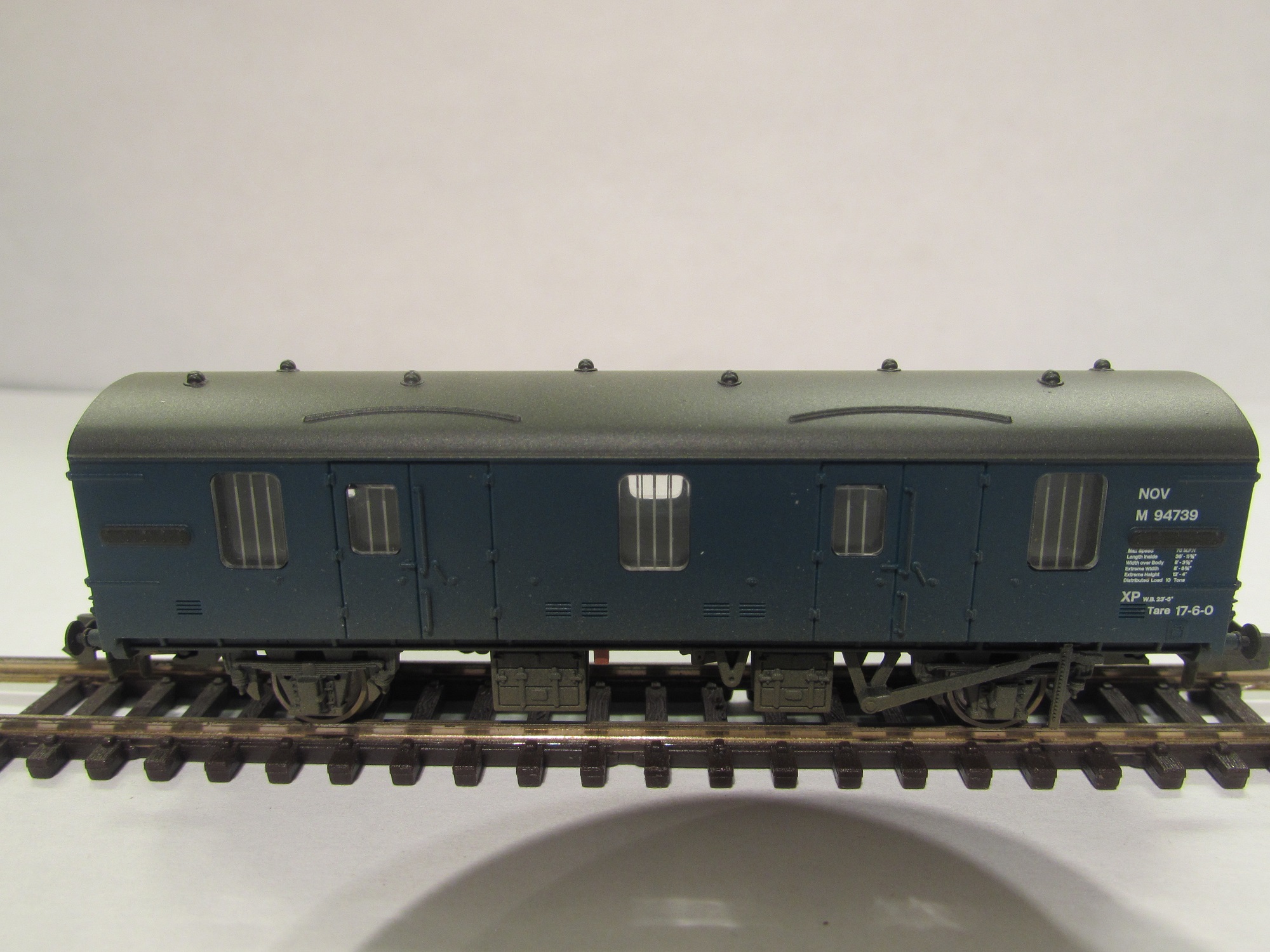

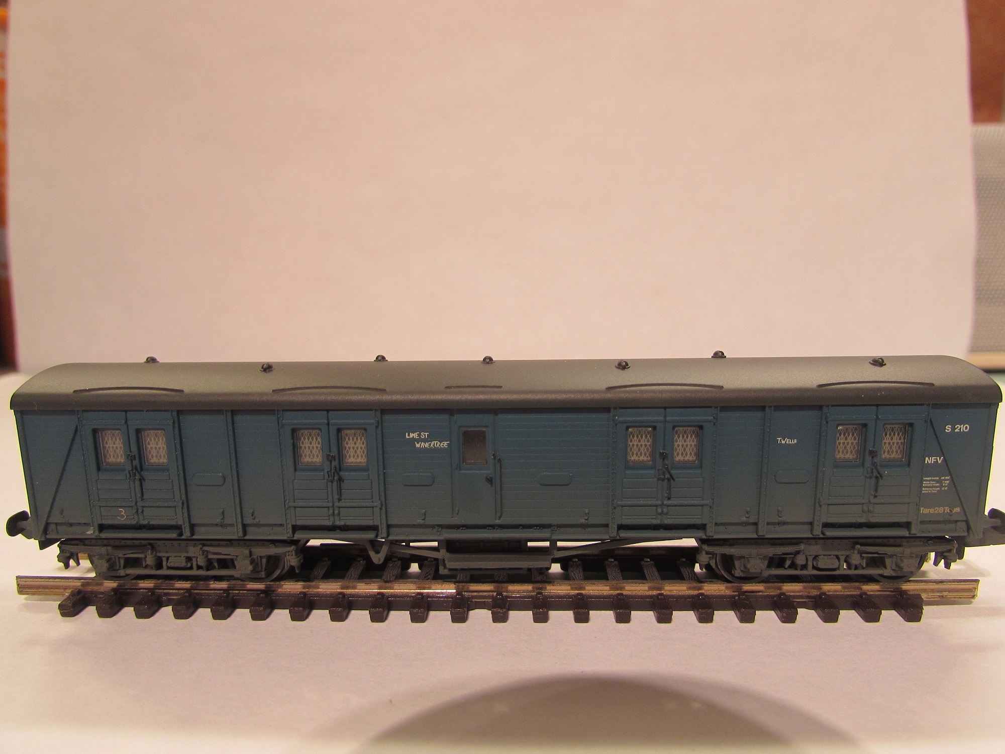

Farish CCT 374-640 factory weathered followed by Farish Bogie B NFV 374-632A factory weathered

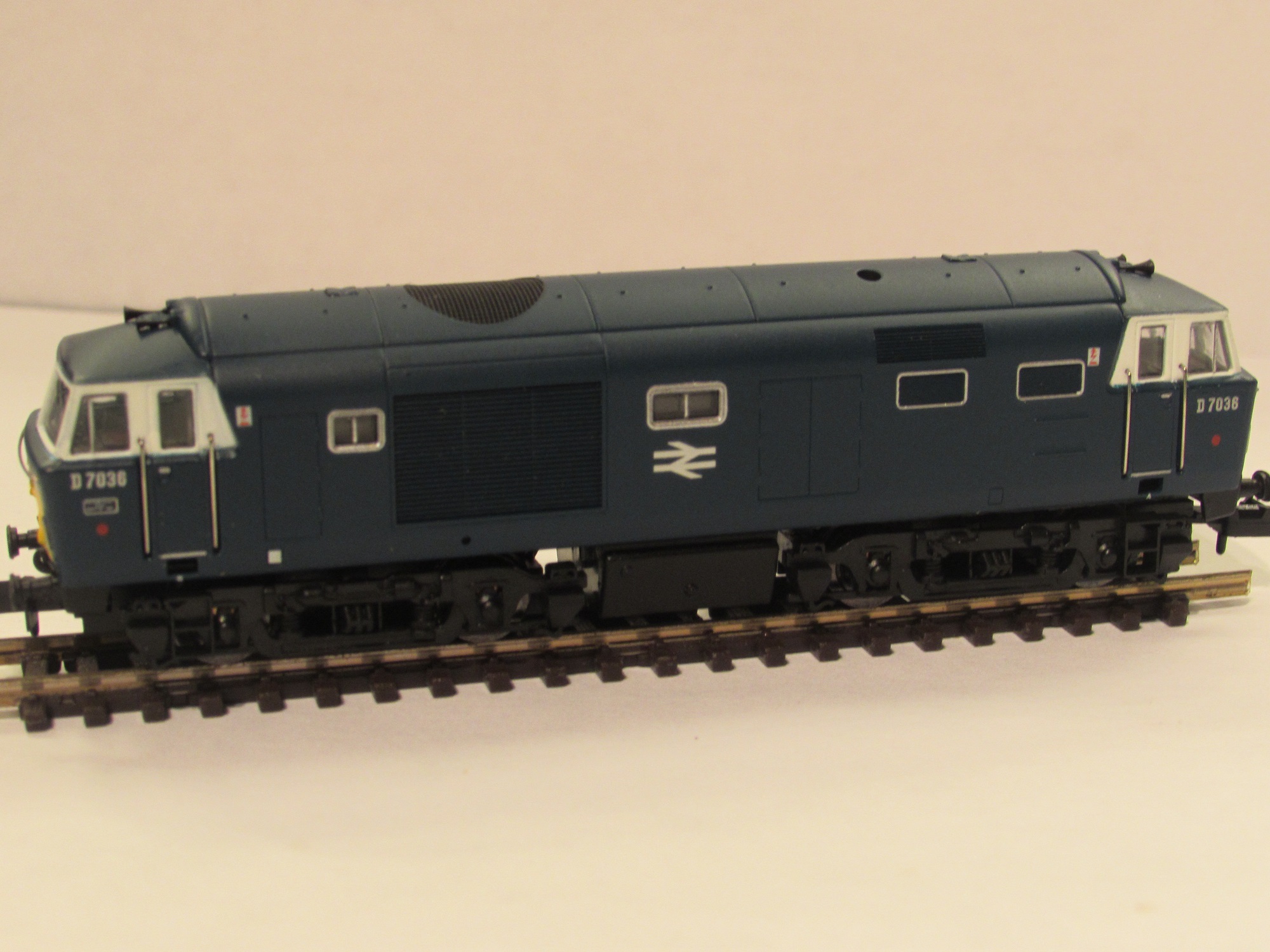

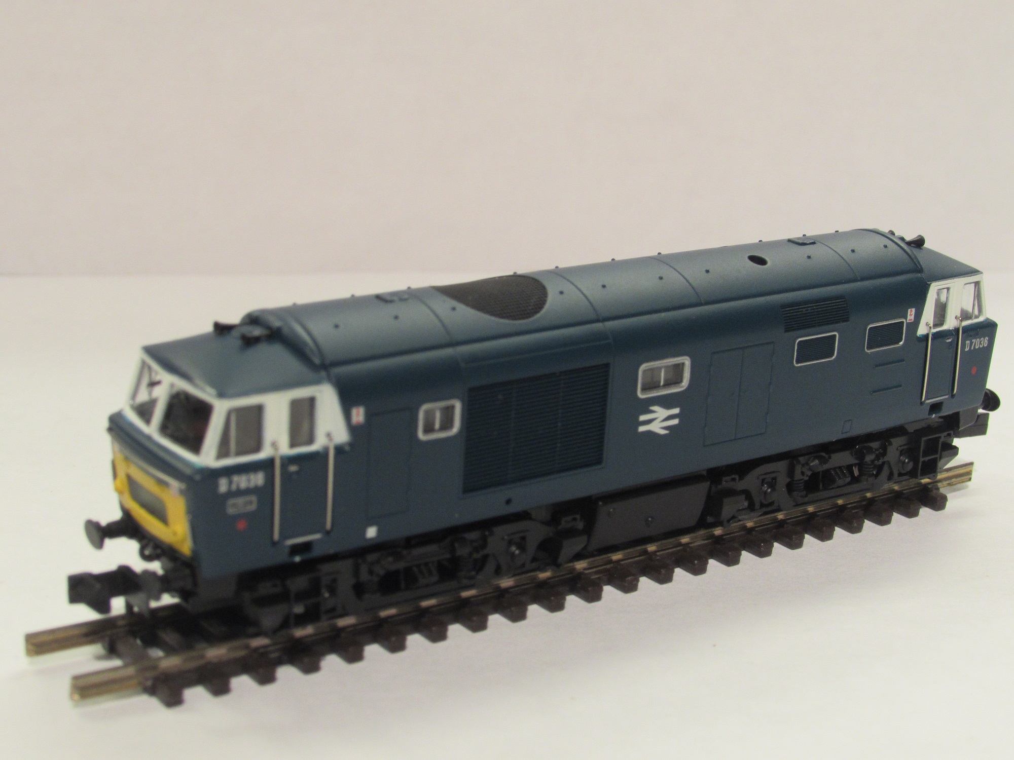

And, of course, the little beauty that kickstarted the whole project thanks to @Chris Morris
Dapol 2D-018-010 chromatic blue Hymek D7036 with SYP

1. The Hymek is just as, if not more, noisy as my other Dapol locos. I swear in one direction it's noisier than my vacuum cleaner! It was given a light oiling as per the instructions. The bogies are such a tight fit I'm scared to use more force to get at the bushes. If I was going to run it more often than my usual era stuff it would be going back to Osborns, but the occasional outing is all it will see.
2. My Farish 374-890 Stanier Full Brake won't traverse 282mm curves without derailing. It seems something is preventing the bogies from swivelling enough, so that will need some investigation.

Stiff bogies suggest that the metal pickups that conduct the power to the motor are bent and/or fouling the bogie wipers.
Hymek bogies are a simple pull out and should be no problem at all to remove  :D
Then you can test the free running gears at the same time.
You shouldn't tolerate tight bogies Mick.
Assuming you've checked that the wheelsets are in correctly and rotate freely, the next thing to look at with the Staniers is whether the coupling mounting moves freely to both sides and self centers when uncoupled.
It would appear this coach is one with the coupling socket mounted on the body, not the bogie.
This restricts the movement of the bogie. I have tried free wheeling it on my main layout's 304.8mm curves and it sails round with no issues.
If mine is representative of the bulk I am surprised Farish have produced a small length of coach which will not like 1st radius curves one bit.

As per above Mick, if the coupling mount is articulating correctly, the coach will go round a 9in curve (Peco R1 Set track)...
The mounting should move side to side allowing full free movement of the bogie... (and spring back to centre if you let go)
The Hymek is heading back to Osborns for replacement (they've sent me a returns label)
It's had a couple of hours running in each way and not improved, and I'm not prepared to damage it by excessive heaving at the bogies to remove them.
