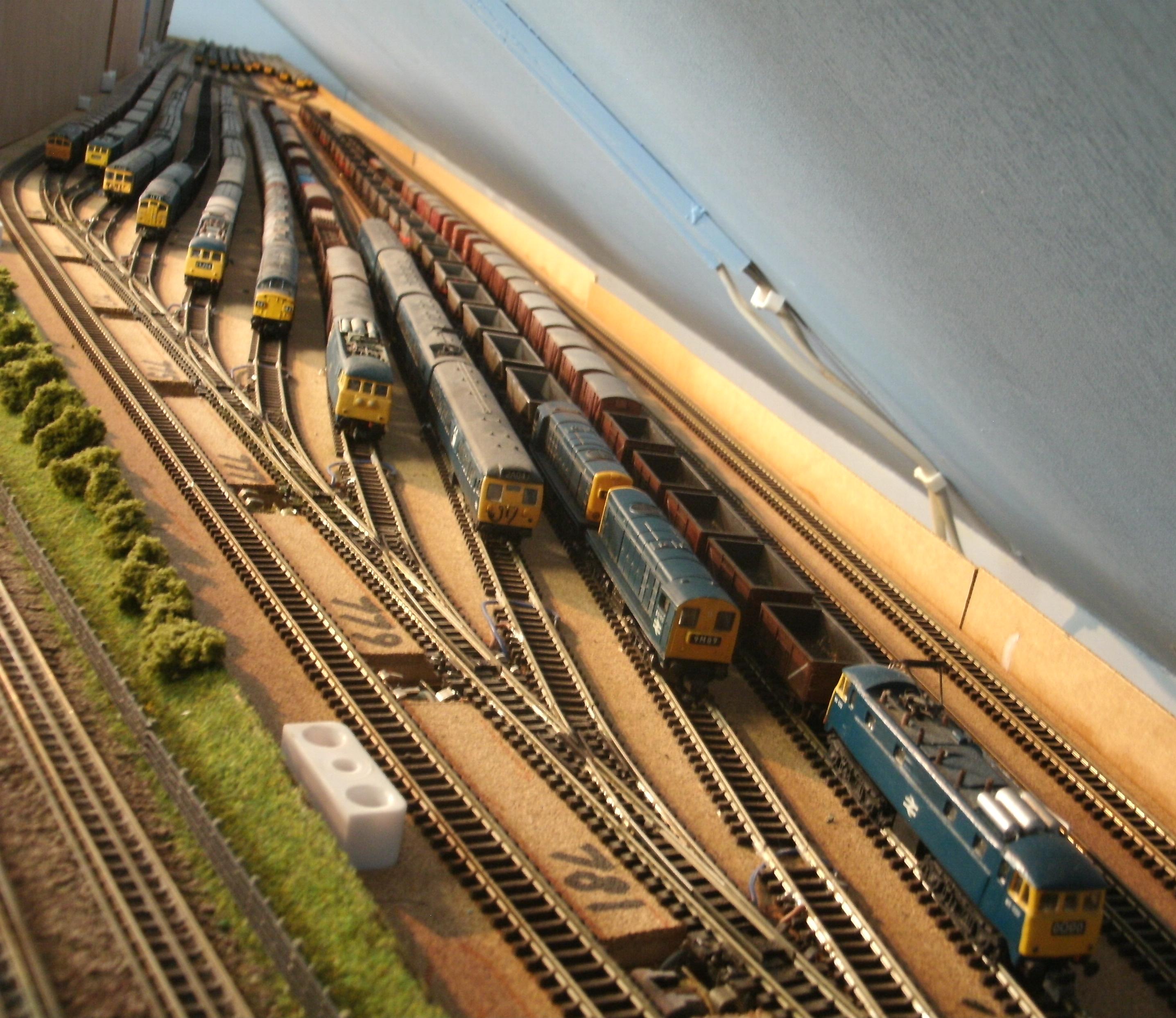

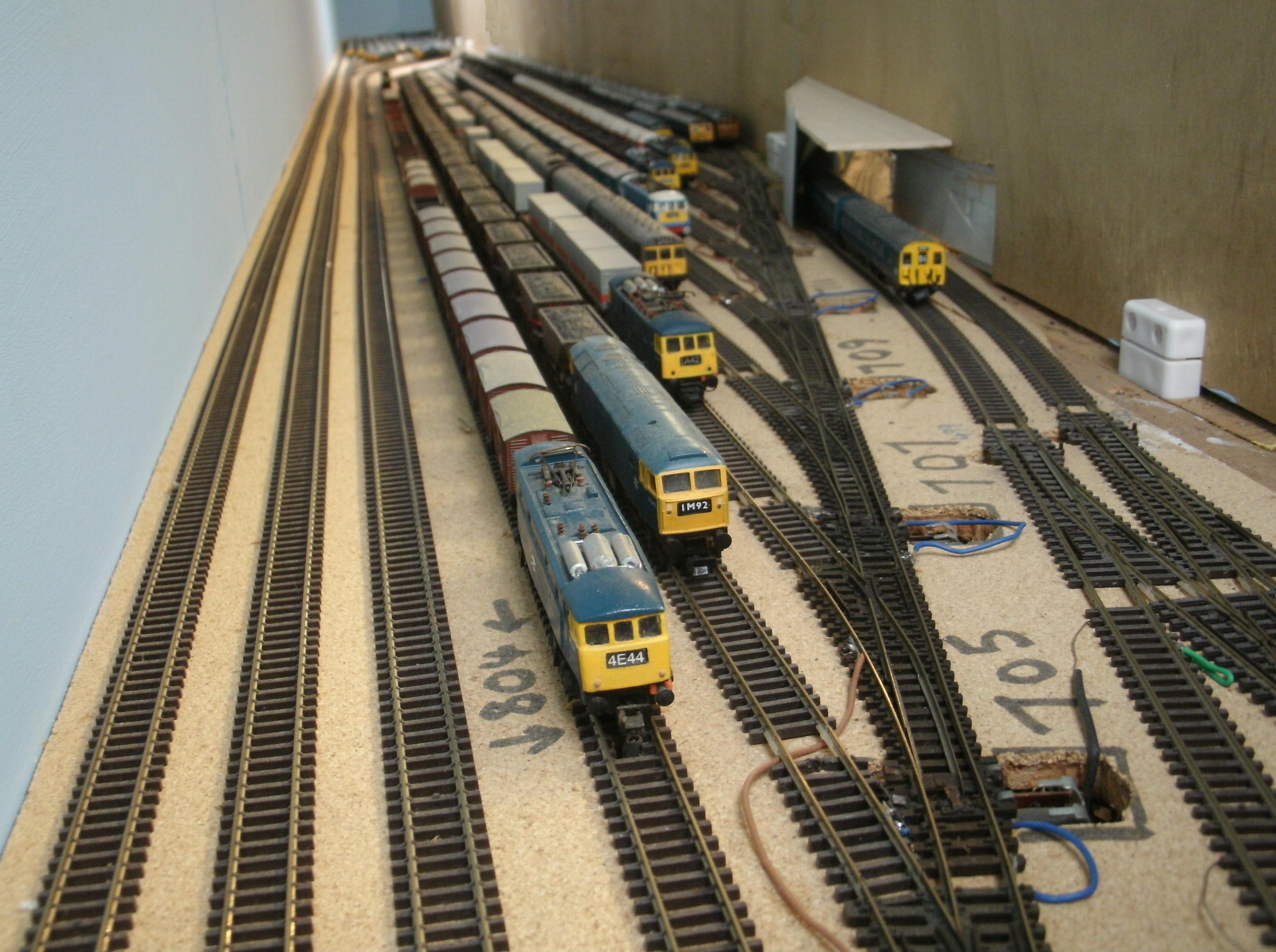

I have used flatpack furniture brackets so that the backscene boards can be removed if necessary. They just slot into place without the need for using the bolts.
Full story and pics at:-

Quote from: AndyRA on November 13, 2021, 10:43:36 PM
Yes they're useful items, I've used those in the past too, same idea as the wooden dowels I suggested.

knock down connectors or knock down modesty blocks
im going to try this method that andy used. hopefully will be sturdy enough as the blocks i got are not v big.
