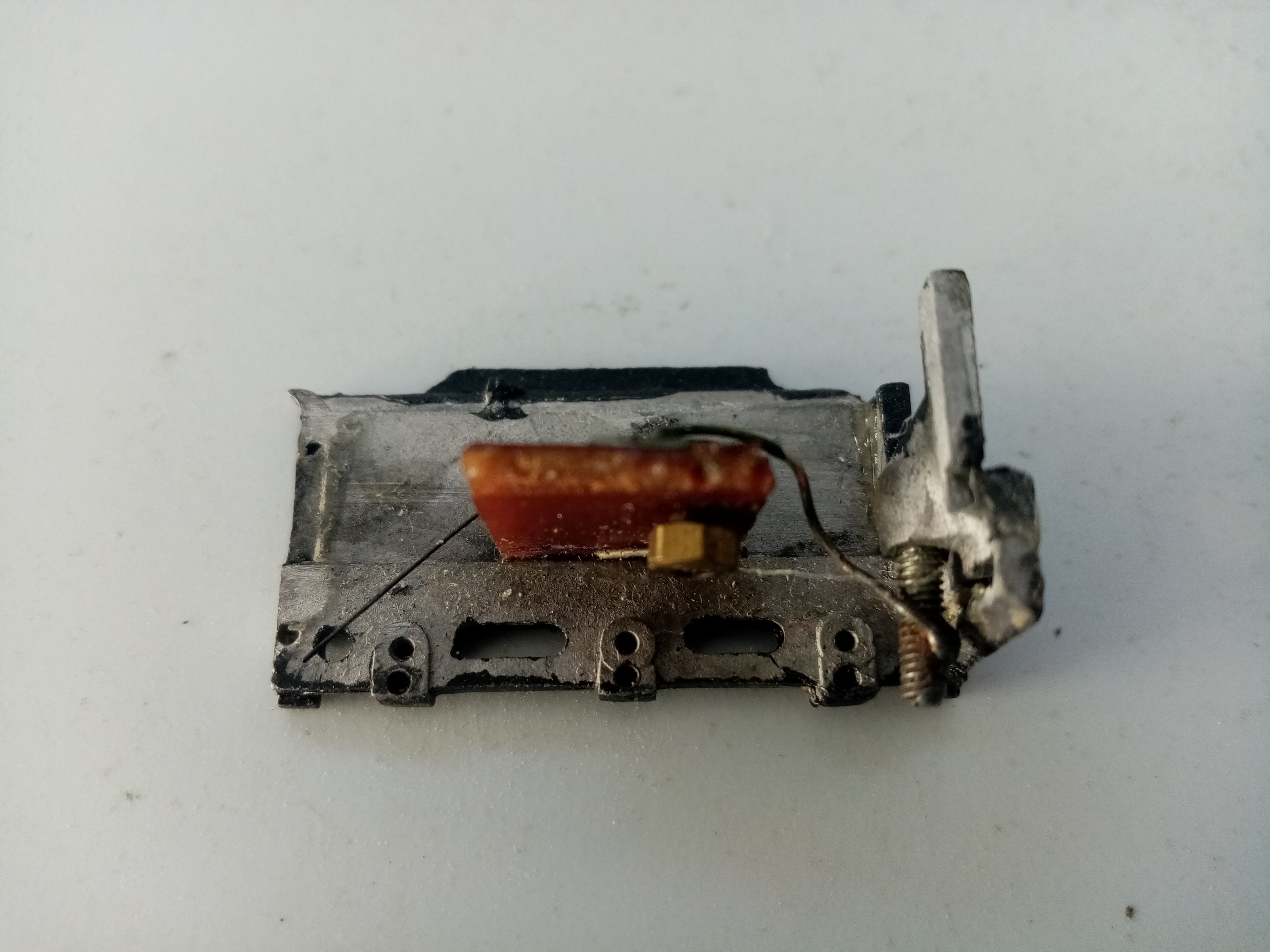

A cut away (!) view of the tender pick-up;
Hope this is clear enough. A second thin wire was added the other side of the paxolin to make the pick-up for the other rear wheel.
Note that it also shows the two sets of holes for the axles; I'm pretty sure =you need to use the top ones, but in any case, not the set that corresponds to the actual axleboxes.
martyn

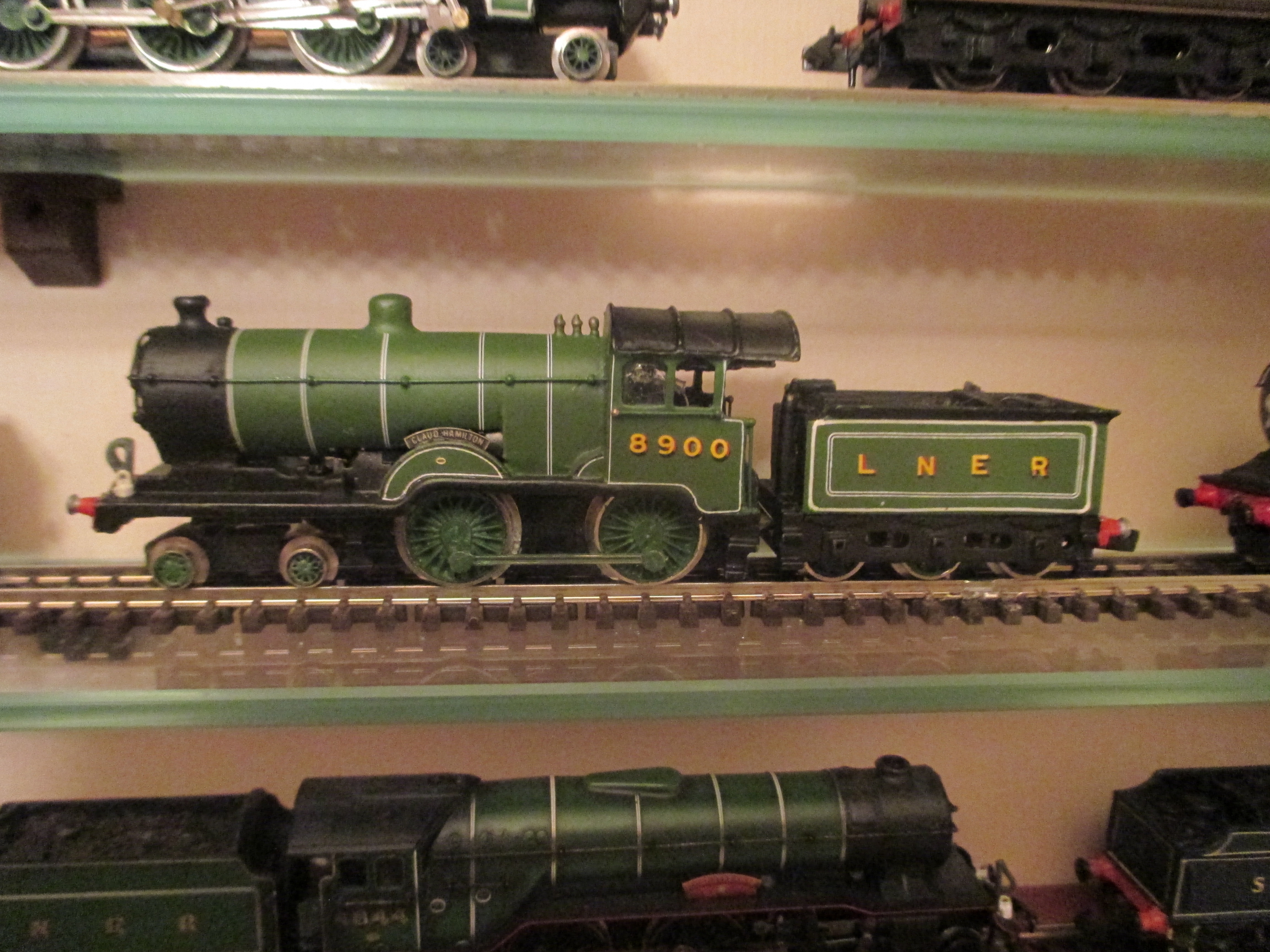

@east anglian /Derek has sent me a photo of his Claud for posting, as he is still finding it difficult to post himself.
Here at is......
Martyn
