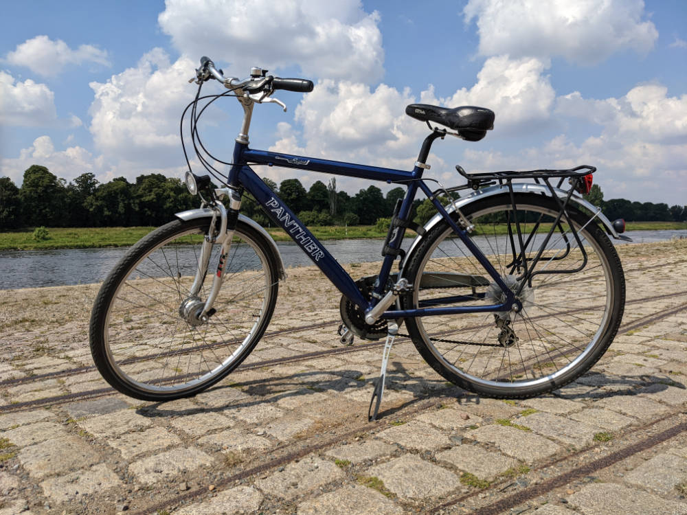

I finally got round to aquiring myself a bike. Picked this one up second hand. It has been a slightly troubled birth though.
I like the bike a lot and it works fine at the moment (gears not the quietest in the world). However I decided to take it for a service and an upgrade to metal pedals (which was expensive). The guy pointed out damage to 2 teeth on one of the front chain rings. He mentioned it would cost 160€ to sort out, as apparently you have to change all the chain rings front and back as well as the chain.
This gave me a sinking feeling, not sure if it is worth investing that amount in a second hand bike. It also got me to thinking I should just have bought a new bike. Sorting this one out with decent tyres alone is quite a lot of money.
In the service they put a new tyre on the back, which I now know is the worst possible junk tyre brand. I then also cleaned all the gears myself, as they clearly didn't touch them.
Anyway, working on a bike seems a bit like working on a giant N gauge loco ;D, I will have to figure it out as I go. I have already tweaked with the gears to get them to be quieter, damaged though they may be!
This is an ideal city for cycling, I imagine I will use the bike daily as my main transport. I have definitely bought the right kind of bike (i.e. a city bike). On a typical ride I come across every type of surface - gravel, tarmac, big cobbles, badly tarmaced cobbles, you name it! And you do need an upright position for hazard-awareness. Cycling is largely done on the pavements and there are pedesrians and other bikes left and centre, as well as cars, buses and trams on the road of course.

The bike looks good, I have a city bike too as I like the sit up stance to help me keep a good eye out for hazards! Is that front hub a dynamo for the light?
Bikes can cost a lot, but once initial service and tyre cost is out of the way, they normally give lengthy use before any other major maintenance is required.
Interestingly I prefer plastic pedals as metal ones can be like 'rat traps' and catch your ankles, etc.

Hi Dave - LOL yes know about the metal-pedal-danger. I do just prefer the grip though.
Yes that is indeed a dynamo hub. I think the lights work - I will test them tonight to be sure.
I am quite surprised at what a bashing a city bike needs to take, I am certainly glad of the front suspension. In Germany they call this style of bike a Trekking Bike, I can see why!
Hopefully the cogs will hold out a long time. Will have to make a descision if they fail.

Oofff. That seems a bit steep, what are they putting on gold plated Ultegra!?! Technically I suppose it's the right thing to do (very German ;))  but before you go down that route grab yourself a pair of pillars/adjustable spanner/vice grips and see if you can't gently coax the bent teeth back into the right position. It won't be perfect but it'll keep you on the road long enough to make a decision on whether to replace parts. It's probably where all the noise is coming from.
Also unless the chain and rear cassette is really worn there's no need to change the whole lot; if the fix above doesn't work I'd get a second opinion (maybe a good old boy who is good with bikes), you might only need someone to change that damaged front chain ring and the chain as they do stretch over time. Should be a lot cheaper than swapping everything out (£20 for a Shimano chain and big chain ring online).

Yes I thought that sounded steep - it is only Shimano Acera. Last time I checked, they weren't using that on Tour de France bikes!! :smiley-laughing:
I did wonder about just using some pliers, will give it a shot, nothing to lose.

I took my bike to another repair shop this morning - a real spit and sawdust place.
They verified I have bought a pile of junk. The entre drive train is worn out and needs replacing for 160€ to 180€. The back wheel has small cracks and is well on the way out.
The best thing to do would be to ride it to a bike shop and buy a new bike! :-[

Might be worth salvaging any good bits to transfer to a new bike. The carrier rack and dynamo hub, for example.

Good point Jim, yes will salvage what I can!  :angel: :thumbsup:
