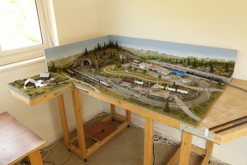

Meanwhile, the bike box arrived. It is the correct size - phew! It was flat packed, so I've used about 5 sticks from the hot glue gun to construct it. In addition, I will add duct tape and nylon straps to prevent any possibility of the box coming apart in transit.
Next thing is to make the wooden corner struts which will attach to the layout baseboard.

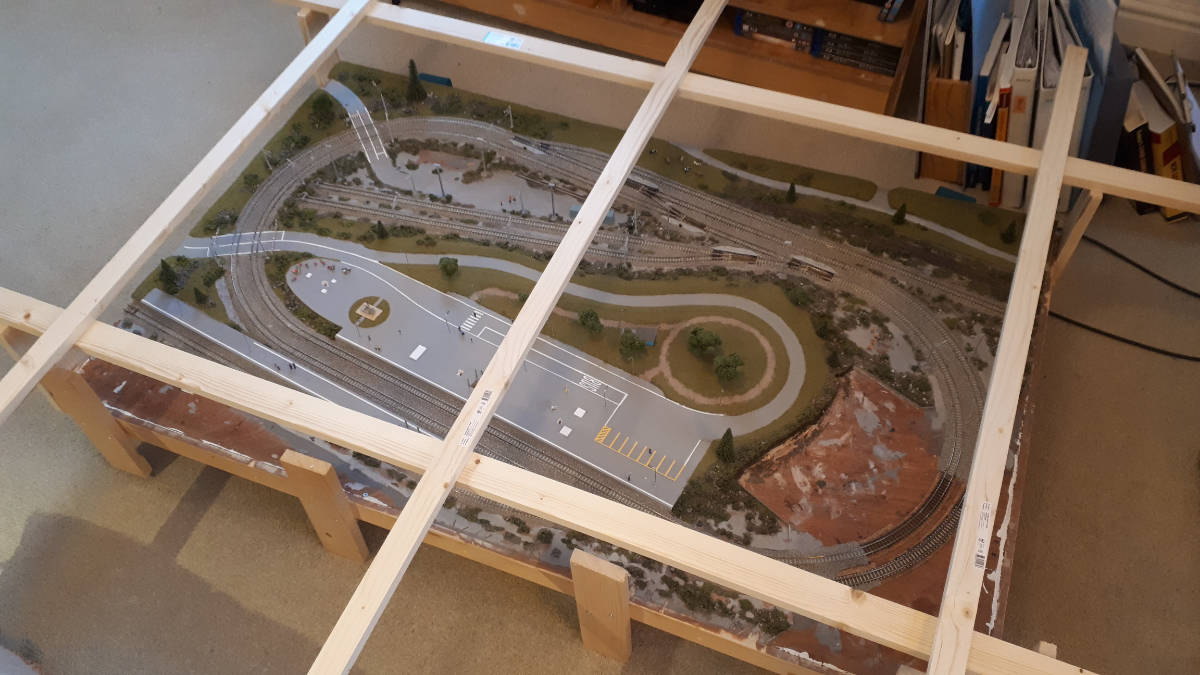

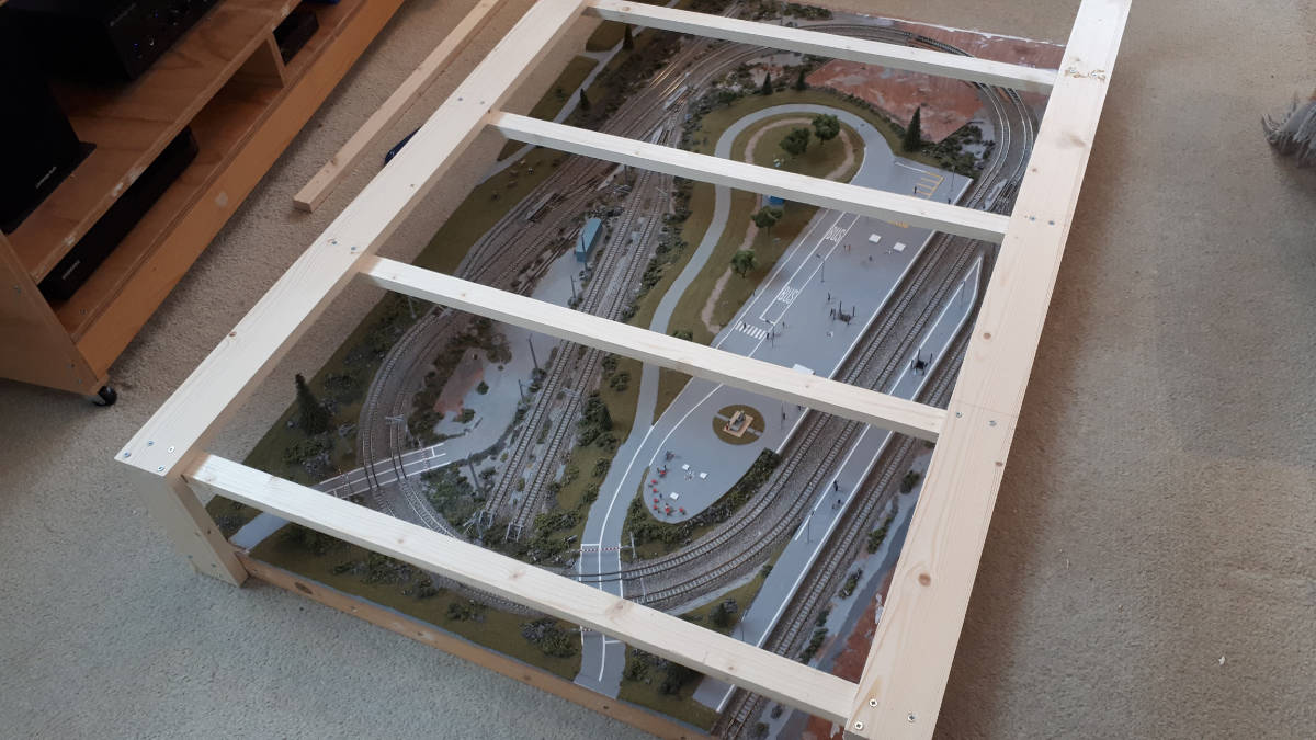

Working on the framework for the baseboard.
Globibahn
Progress on the layout framework.

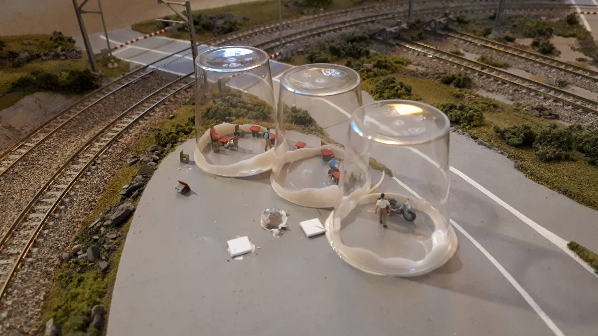

I've also ordered a lot of plastic shot glasses on ebay - can anyone guess why??? :hmmm:
Globibahn

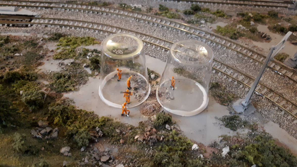

The little figures are superglued on my layout. However to be on the safe side I'm gluing plastic shot glasses over them with copydex, which will be fully removeable.
Looks a bit surreal!  ;D

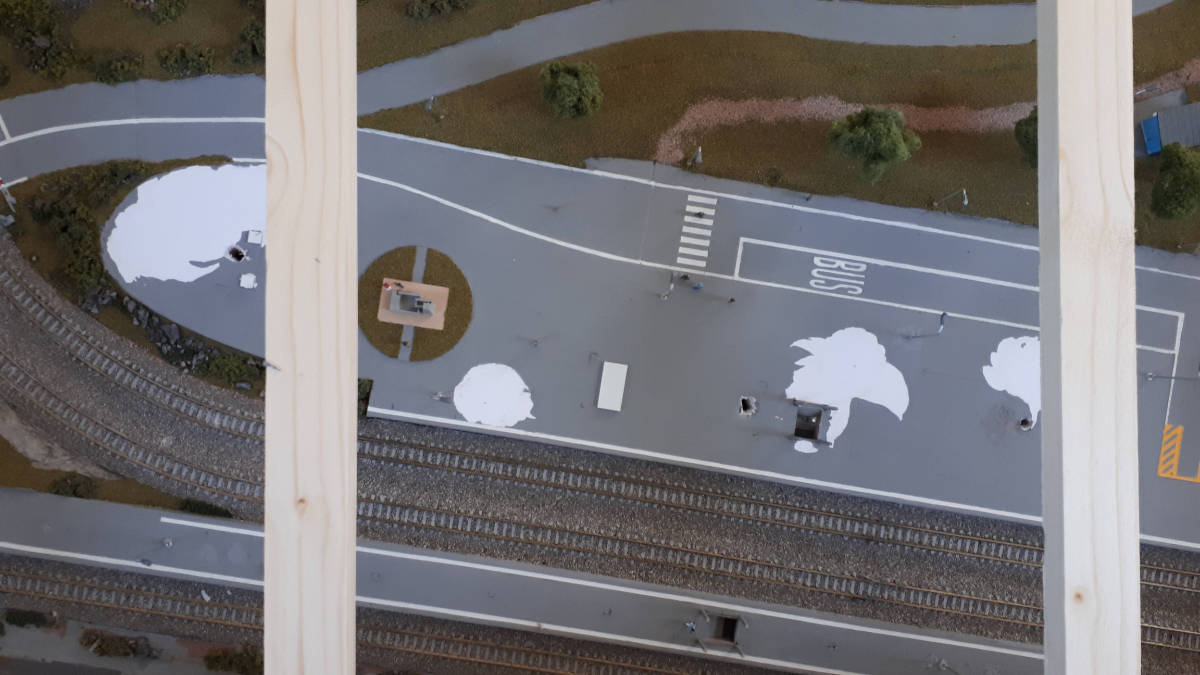

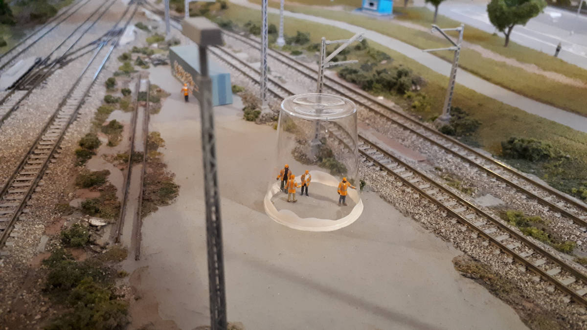

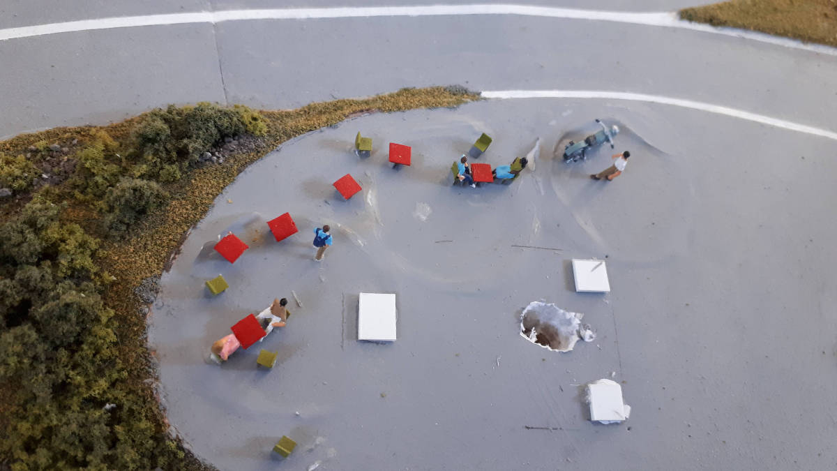

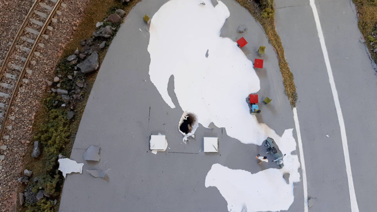

Had a bit of a Homer Simpson 'Doh!' moment.
I thought I would remove one of the shot glassess to see if it had any effect on the paint. As it turns out, the glasses were stuck on much too strongly and the copydex had manged to seep into the acrylic paint and soften it.
Anyway, I removed the whole lot and half the paint on the platforms with them.
Several points from this:
1. I had been thinking, that in future I would glue figures in groups onto movable base plates anyway, so this has forced my hand. This enables moving figures around and onto new layouts/ dioramas etc.
2. Adhesion of acrylic modelling paints onto smooth foam core board is acceptable but not that great - I had the same issue with plaster not sticking to it also.
3. The whole Cafe scene will be re-done, also on its own base plate.
4. To summarise, looks bad but lessons learned, progress made. 8)
5. Having all my workmen on base plates means I can put them on the container yard diorama I'm thinking of doing....

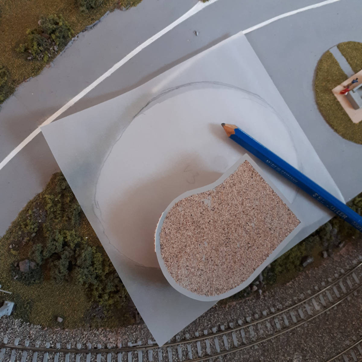

Globibahn
Righty -ho.

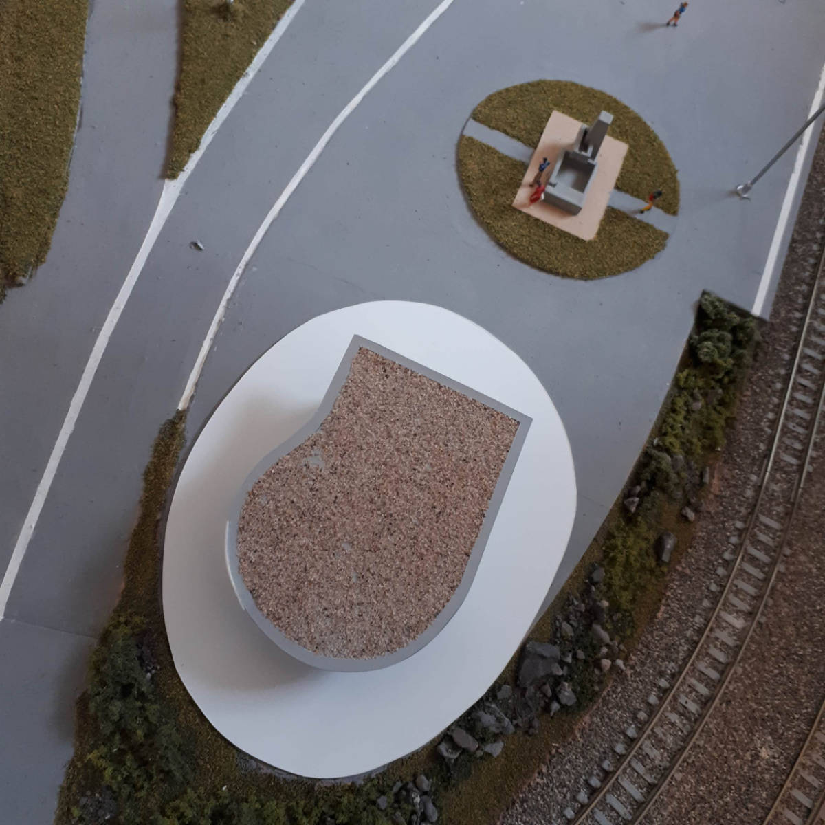

I've set to work making the new base for the cafe scene...

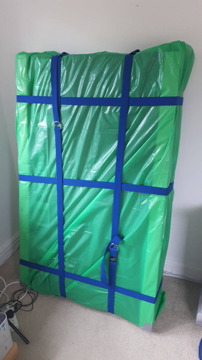

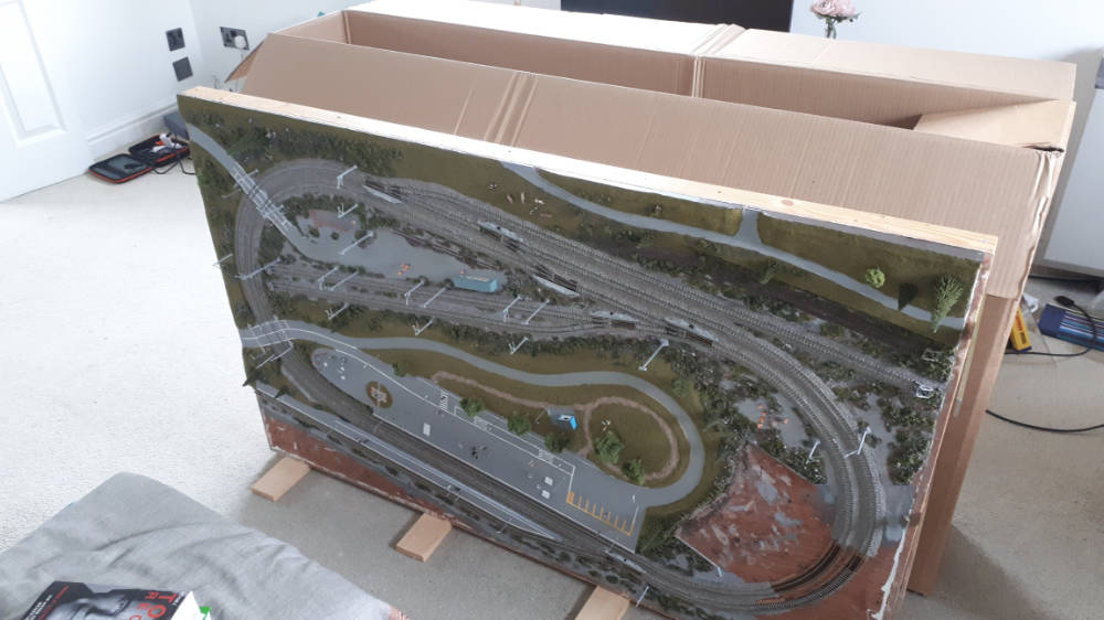

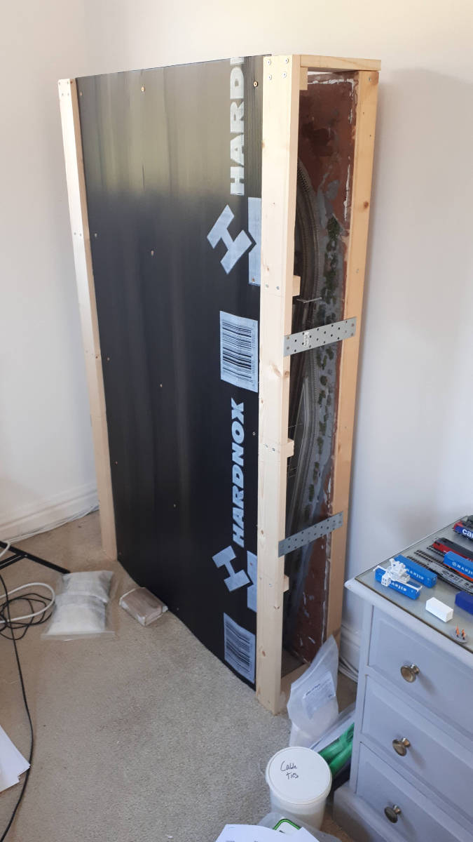

Globibahn is finally in it's box ready for storage!
The final look of the layout converted into a crate, so-to-speak.

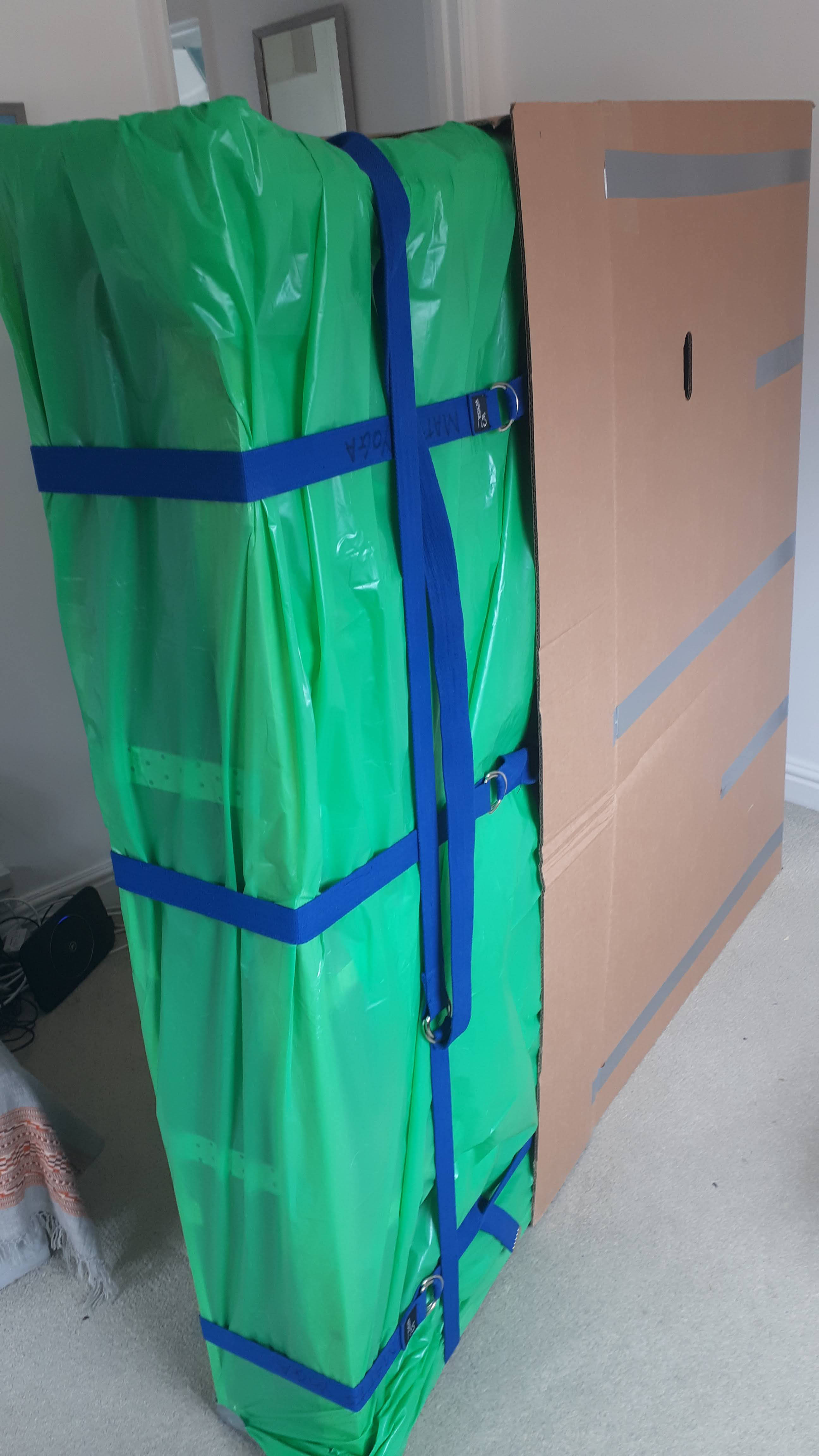

Bagged up. The belts help to squash the air out, otherewise puttting in the box very difficult.

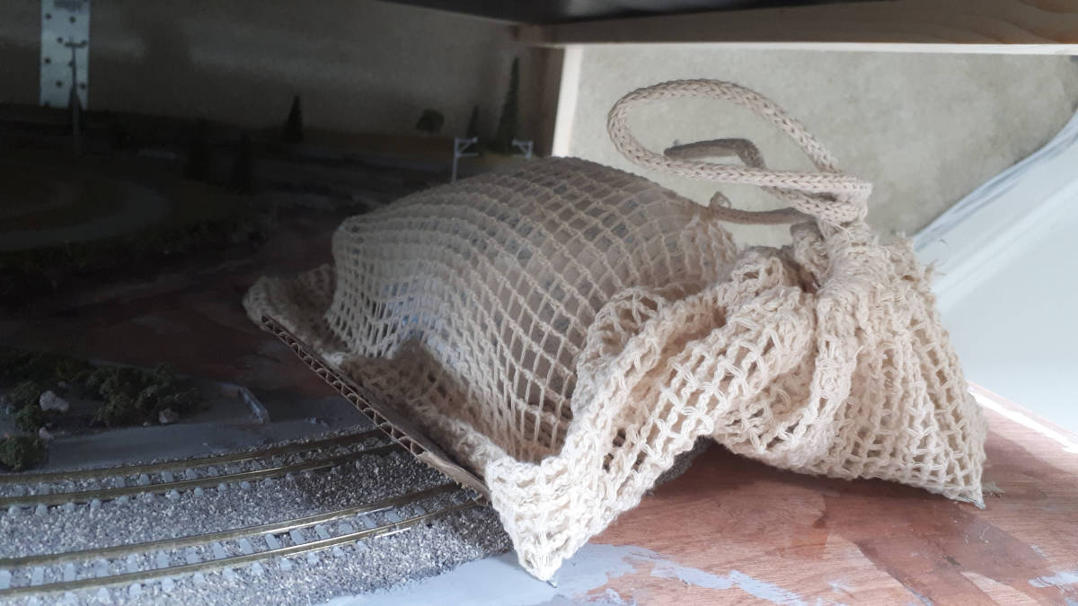

There's 2 x 500gr bags of silica gel, held within string bags, placed in there to keep it's microclimate dry.
Slotting into the box. Easy!
