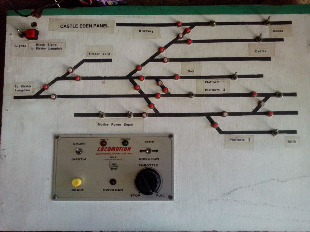

This is the control panel for the terminus on my layout, which shows the run around loop.

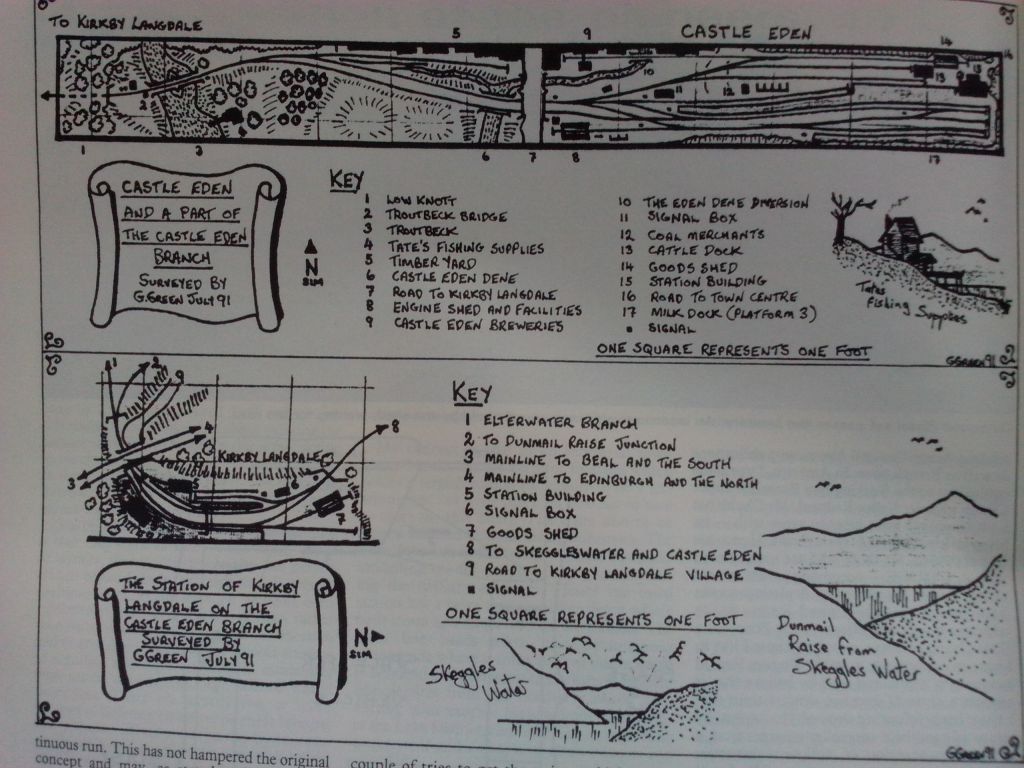

And a track plan (not very good photo of a plan I had published in the British Railway Modeller magazine)

So, Bealman, from your pics it looks like you can run a train in with brewery traffic up next to the loco and shunt the brewery first with its trailing turnout.  Next run around the train and shunt anything else since the loco is off to the left side of the train.
What about taking on water and fuel?  Are there always seperate facilities such as you have or could it be on one leg around the platform or combined on one of the lower sidings?  I could always have them off-stage to the right and just say the servicing was done.  I would rather have the moves though to keep the interest up.
Basically an arriving train would simply enter the top most siding of the goods yard, (the one with the goods shed at the end), then simply push the beer wagons back into the brewery siding. The loco was then free to head off where ever it pleased.
To run the beer wagons out, it was a matter of hauling them out of the brewery, then backing them down onto a loop  on the branch and running around them so the loco was at the front of the train, and then heading off to the left, over the river and off to points north!
There are really two loops involved in the plan.
It's a brilliant plan for a country terminus, with lots of operational interest, but not one I can claim credit credit for. It is an unashamed copy of Leighton Buzzard on the late Rev. Peter Denny's Buckingham Branch. Peter Denny was a celebrated British railway modeller for 50 odd-years and had many articles published over those years. Fortunately his layout still survives today.
