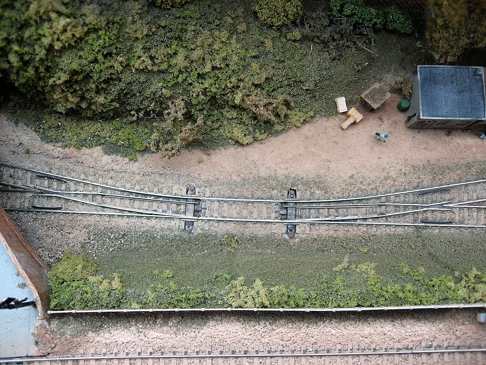

I gave up creating slots decades ago, I just use something like an 8mm-10mm drill.   When ballasting later, you can use a little card to disguise some of the hole if desired, or simply guide the wet ballast around the hole to reduce its apparent size.
I reckon the holes for the point motor rod are not very visible in this photo?  (holes are top side of the points)
