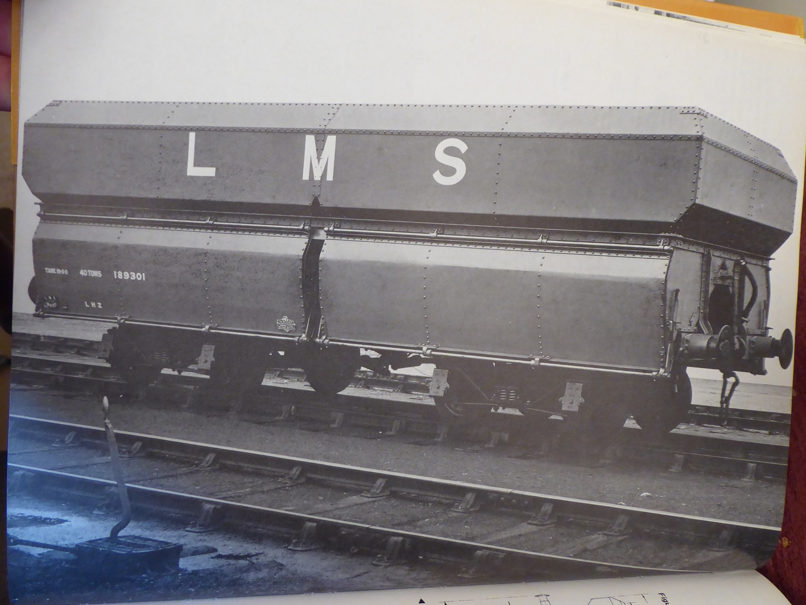

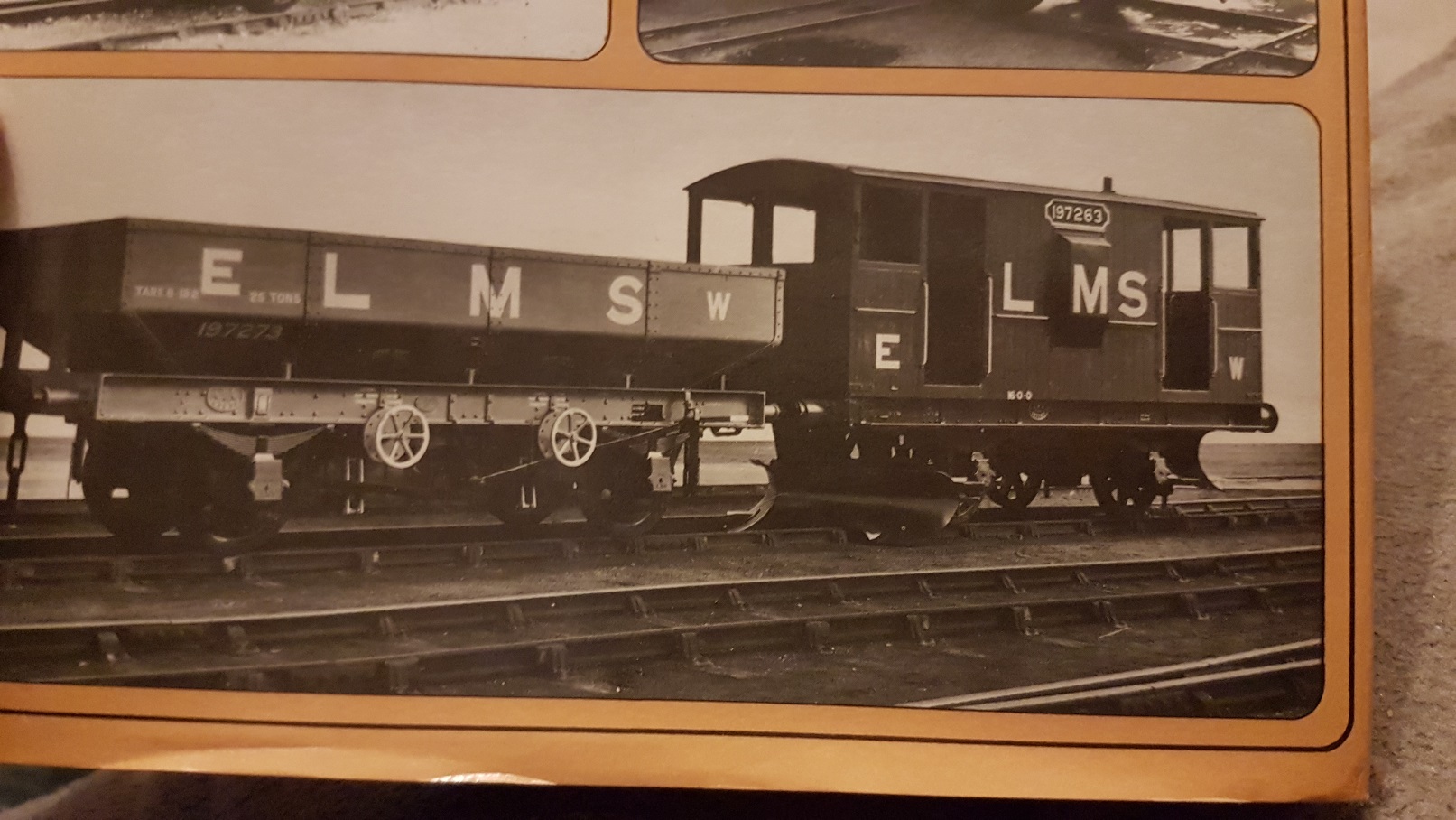

For clarity, I've attached a couple of pics and a list of exactly what I requested from Fox and Railtec.
I thought it would be quite a straightforward and easy request, but am I overlooking something?
Below is the exact list that I sent to Fox and Railtec.
Decals for 40ton bogie hopper wagons
All white lettering in LMS font.
* ALL SCALED TO 'N' GAUGE *
Eighteen of each, 18inch high LMS wagon font
L
M
S
Two of each, 4inch high LMS wagon font
189301
189302
189304
189316
189319
189321
189329
189330
Sixteen of these, 4inch high LMS wagon font
TARE 19 - 0 - 0
Twenty of these, 4inch high LMS wagon font
40 TONS
In addition:
Ten of each, 12inch high LMS wagon font
Ten of each, 14inch high LM wagon font
E
W

FYI emjaybee, I have already sent the two photos you posted and specs to Ian via IM on RMWeb. I will let you know what he thinks. Should be a straightforward job once you have the fonts worked out.
Doc Pye
@emjaybee
Ask and you shall receive! After sending your photos and specs to Ian he has responded as follows:
QuoteOh I see. If he can also photograph, flat, the drawing of the lettering on the inside pages, (if its the same style as the SR books there will be one in the first 15 pages), then I could do it without too much problem. I need the details, better than the slightly off flat photos here.
Cheers Ian
