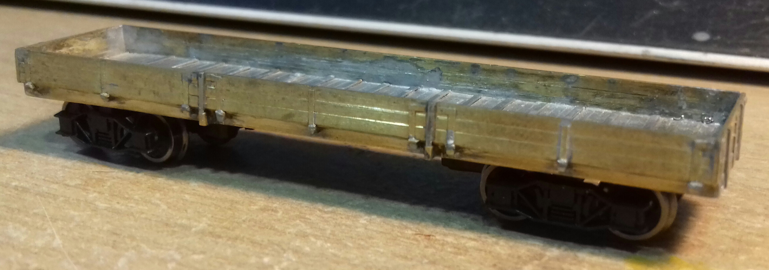

For my (in progress) Boplate B wagon, I scribed the planking using a Tamiya panel line scriber. It took several passes to get sufficient depth in the metal (0.35mm thick brass) for the lines to stand out - quite a time consuming process for the deck. I also use this process to score the metal sufficiently to snap it out which is much easier to do using 0.25mm sheet than it is with 0.35mm!
Here is the result.

@Stevie DC looks absolutely fantastic steve, I was hoping that someone like you who knows and does so much scratchbuilding you would know of a sheet of planking for wagon chassis or something.
Looks like I'm going to have to try to be creative
