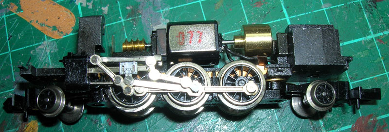

The other option is to print in bronzed steel.  At £15 from Shapewys the extra weight might be worth it on a DCC 0-6-0 but the screw fixing would need to be insulated with a plastic tophat.
The only deciding factor here is how hot will the motor get, I confess I have not much dealings with small coreless motors. But if they do get warm then the bronze steel option could act as an heat sink.
Snowwolflair
#16
After 3 hours running no heat at all.

Had another thought, could you fit a double ended motor and include a flywheel?  A bit like the small motor I used in a Minitrix ivatt tank a few years back
Snowwolflair
Quote from: ntpntpntp on February 26, 2020, 04:11:21 PM
How's the torque?
The motor I'm using is double ended (the bearings are better) and there is a 7mm by 6mm flywheel available.  The mount has enough clearance to fit one.

That's a very tidy looking mod. :thumbsup:

There are about 12 different types and most can be replaced with a simple motor shape block with a hole down the middle, and they are available.

Very interesting, does it bring the height of the chassis down from the Farish original. I'm thinking of smaller loco classes as I currently have to glue the motors to the chassis block.

This is an interesting idea, and particularly useful if need low profile motor in a kitbuild (I can think of one I have that'd probably make use of this).
However, those considering replacing their Farish armatures - do bear in mind you are replacing a 5 pole unit (generally) with a 3 pole, and the coreless motors rev higher, so super creep needs proven - a properly overhauled Farish 5 pole will do a very good creep.
Moreover, they clearly have much shorter lifespan (commutation/brushgear) and as such, several (myself, @Fredastaire ) have seen extensive numbers of failures of these already - something the old Farish armatures won't do (many 25-35 years old still going). Another post went up only today on this on yet another coreless failure.
Tramfabriek's motors may be different, but they have not carried out tests requested of longevity yet as far as I know, so jury is out. If they are similar then for me they are too expensive to be replacing every couple of years I'm afraid.
