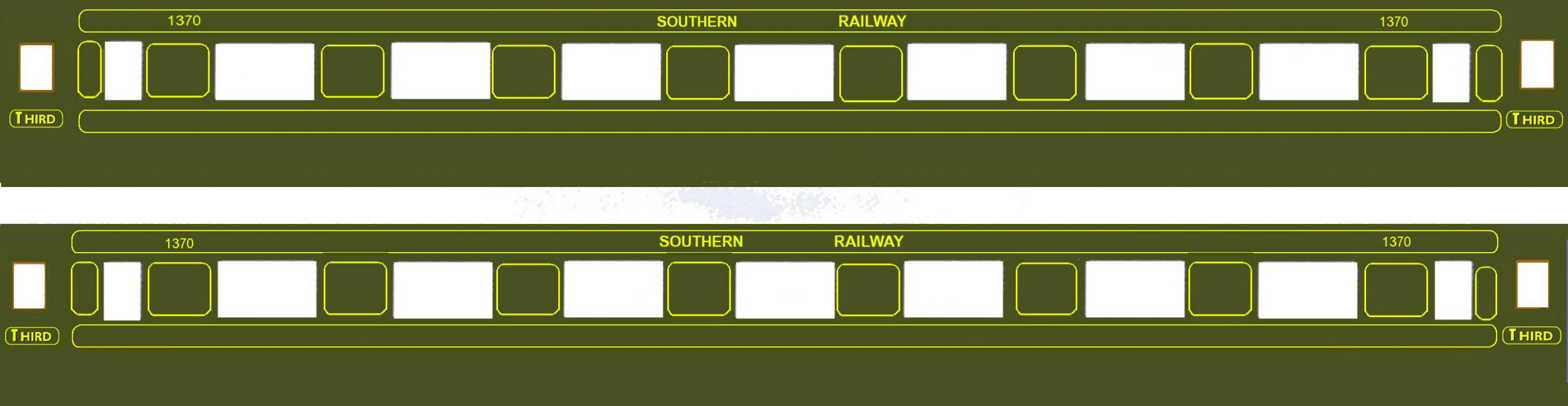

Has anybody tried hacking any of these to make either open thirds or restaurant cars; alternatives I've thought of are using Worsley Works etched sides either cutting out the Dapol sides or filing them down otherwise finnding someone to 3D print sides or complete bodies.
Worsley do the open thirds but the restaurant/kitchen are still listed as TBA however the LSWR IRonclad restaurant is listed, these are all currently in 2mm finescale so I've emailed Allen asking if they can be done in N gauge.
Next thing will be to find some cheap suitable Dapol Maunsells, made an offer on some on Ebay, fingers crossed.
Cheers MIKE

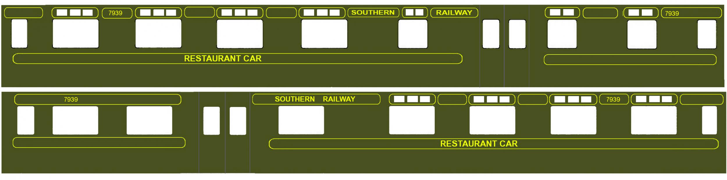

I did the artwork for the sides  a while ago hopefully at that time to fit the older Farish main line coaches, I'll probably need to resize that by a few mm and print onto self adhesive clear plastic.
Cheers MIKE
[smg id=6583]
Dorsetmike
Would anybody be interested in etched brass sides for Maunsell open 3rds and/or Ironside restaurant cars? The ironclad restaurants did run in trains with Maunsell coaches. The sides should fit over the older Farish "main line" coaches, the difference in length between the Dapol and Farish is less tha 1mm, just the Dapols have better roof, ends and bogies etc
The reason I've chosen Ironside restaurants in preference to Maunsell ones is that the Maunsells had recessed double doors to the kitchen which would be a PITA to fit self adhesive sides - plastic or paper. The recessed doors on the ends of the open 3rds are much less a problem.
Cheers MIKE
[smg id=6583]
