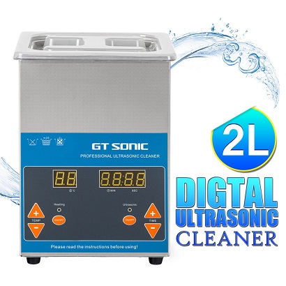

I have a GT Sonic 2L stainless steel one from ebay. It has a 60 minute timer and heater. The temp readout is very useful, as even with the heater off the tank and contents will rise in temp - Physics 101: energy cannot be destroyed, only converted and in this case the untrasonic energy is converted to heat.
emjaybee
Quote from: RailGooner on December 12, 2019, 02:04:03 PM
Is it this one?
What sort of vehicles can it hold? i.e. can it take a coach for example?
Ta muchly.

That's the one. It comes with a wire basket that sits in the bath. I can fit a Mk3 coach or Class 66 body in the basket diagonally on the level. Obviously, if I don't use the basket they still fit and with the bonus that you'll need less fluid. I tend to place my bodies in coffee filters rather than the basket - when small details like window wipers fall off, they're easier to recover.

Thanks for that, that's exactly the kind of info I was looking for.
Do you find it cleans well?

It does the job well enough for me. I use IPA almost exclusively in mine - the yellow warning panels on a Dapol Class 66 take some shifting. Here's one I prepared earlier.
They are very good for removing/loosening fine details part too.
