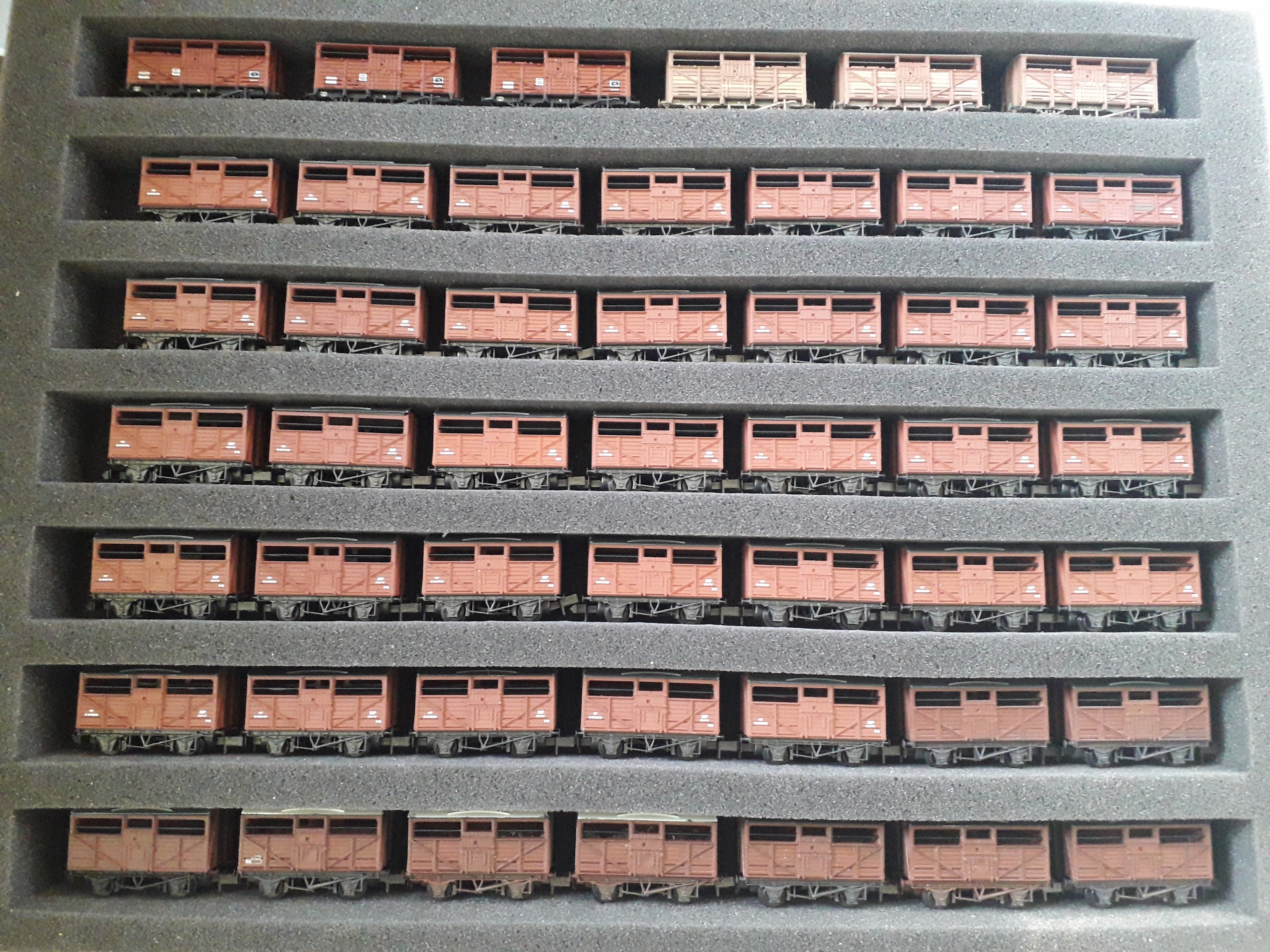

I've had 3 sets of graham farish cattle wagons (triple packs) and a good 40 Peco versions for a while, with far too many bits and pieces cluttering up the bench it was time to start working through the backlog.
The peco ones I needed to paint the insides of a few as they were white, the quite obvious over scale bar in the open section needed to be painted black and rather then renumbering all of them I'll cheat and give a good dusting of weathering to save me a ton of hard work.
But as far as I know these wagons were built as 8T and 12T examples but the only difference was the roof profile. Theres probably lots more to it but that's as far as my knowledge goes.
So.....
Why on earth is the GF wagon SO much bigger than the Peco one??
It's not a problem because I wont ever run all 51 together but when the GF ones are in the box it just stands out so are the GF ones correct and Peco have just done the usual and made them fit???

The recent Farish version is an accurate model of the BR design (itself based on the later LMS design with a few GW bits thrown in). The Peco model is 'adjusted' to fit their standard 10ft wheelbase chassis and most closely resembles earlier GW or NER designs.

I thought the peco ones would be the same story as their Fish Van's but at 1/3 of the price of GF I could never afford to put 50 of theirs on the layout.
Whilst looking into weathering these, obviously being fully fitted and XP rated they had vacuum pipes, the GF has them from the factory as its 3x the price so I've raided my parts box and managed to collect 16 pairs from some NGS kits BUT short of making another 30 pairs from wire is there anywhere I can buy plastic versions (like the NGS kits) ?????
Idont feel they warrant brass vacuum pipes but will at least make them look a bit more prototypical. I guess the cylinder part sits in the same position under the chassis as NGS recommend on the kit instructions????

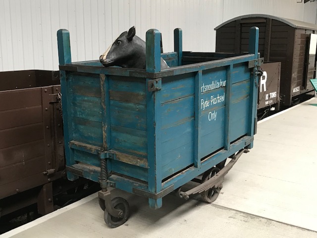

I think the calf floats would be a quality addition to the station scene.
Thanks @RailGooner I need some bits from DCC supplies so will have a gander

The Peco cattle wagon most closely resembles a GWR W12 Mex B (see the copious tome by Tourret et al for details). If you've got any in GW livery then they should all be vacuum fitted and have tie bars on the axles. Same for BR livery. Any other livery is Peco being economical with the truth shall I say  :D
The 2mmFS fraternity have a greater selection in plastic on brass chassis and also in etched brass; but of course you have to be a member.
Then there's those already mentioned; but you've got to find them first (good luck with that!). Hope this helps a little.
Twinklekev
exmouthcraig
Thanks Kev, I've started fitting vacuum pipes and seen tie bars in some pictures and on some models but not on others.
I'm not unhappy with the peco ones so will compromise and fit vacuum pipes and tie bars, they are all in BR bauxite so that will be good enough for me.
