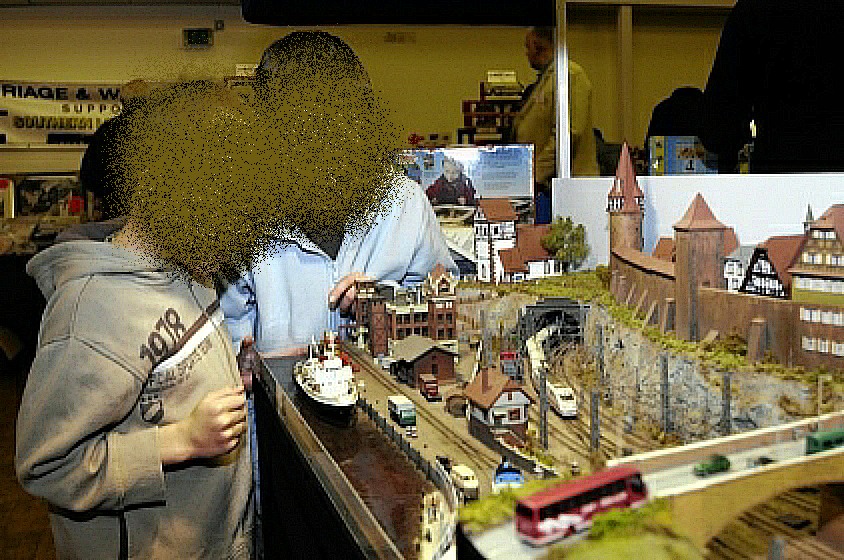

Quote from: ntpntpntp on September 11, 2019, 01:30:10 PM
You could also consider putting perspex or similar clear sheet around the edge, but it does tend to affect the view of the trains!
Not sure I agree with that. Check out my 'temporary' edging using a product called 'Liteglaze' but it's the 2nd pass of the class 26 that shows best.

Quote from: Newportnobby on September 11, 2019, 08:22:55 PM
Dapol class 26 on Kimbolted by Mick Hollyoake, on Flickr
Nah, I'm afraid that would really irritate me - the obvious line at the cut edge plus all the reflections.
I've only ever used it in one place, where the "water" of my harbour meets the edge of the baseboard, to keep little fingers off the surface at shows, and then only an inch or so high so as not to obstruct the view of the trains.
