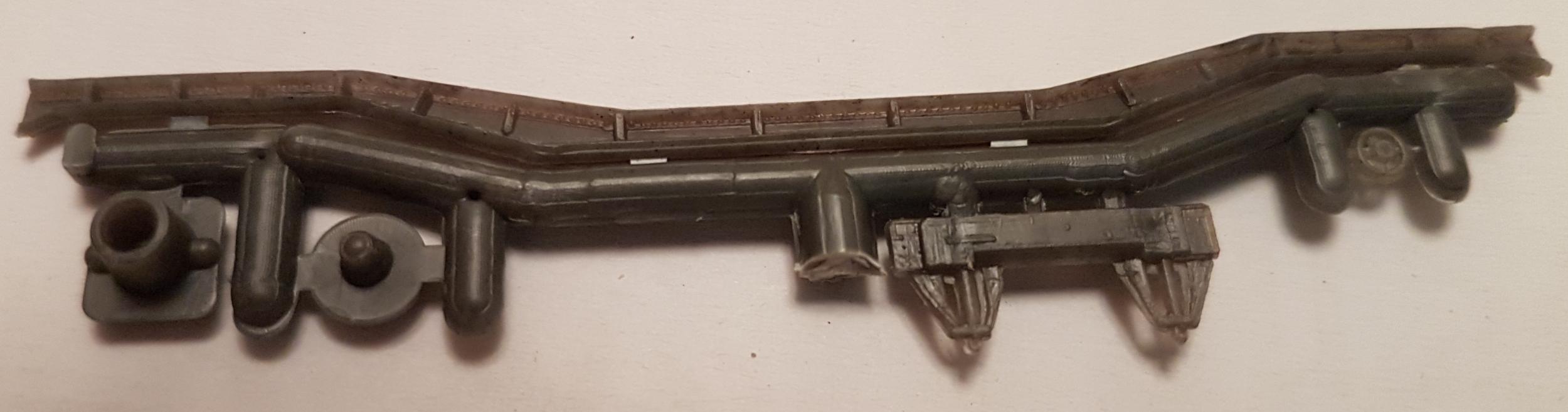

I think there's a little misunderstanding.
My thought was, say for instance, Kit ABC consists of three sprues, one has wagon sides, one has wagon ends, one has detail parts and bogie bosses.
The third (imaginary) sprue could be made available separately for sale to scratchbuilders.
In my (distant) youth, many plastic kits I built had 3, 4, 5, 6, 7 different sprues, and sometimes half the bits on a sprue weren't used on that particular kit.
I just wondered if by any chance there happened to be an existing 'additional' sprue in one of the NGS kits that had the bogie boss which could be run off for separate purchase?
This is one example in the Warwell kit.
I want suggesting for one minute that someone went around snipping them out of kits for me (or others).
Brookline build thread:

Generally, you try to get as many parts on one tool as you can to save money.  The only reason you'd use another tool is if either it's a complex part that requires a collapsible tool or you want to use a different material like say slippery plastic for bogies and couplers.
I am not aware of any sprue that just has some bogie bosses on it, however as I said, the new Warflat mouldings - which are very similar to your Warwell moulding - have two bosses included, and since every kit requires two sprues to complete the kit there'll be a full pair left over.
cheers
Ben A.
(NGS VP)
