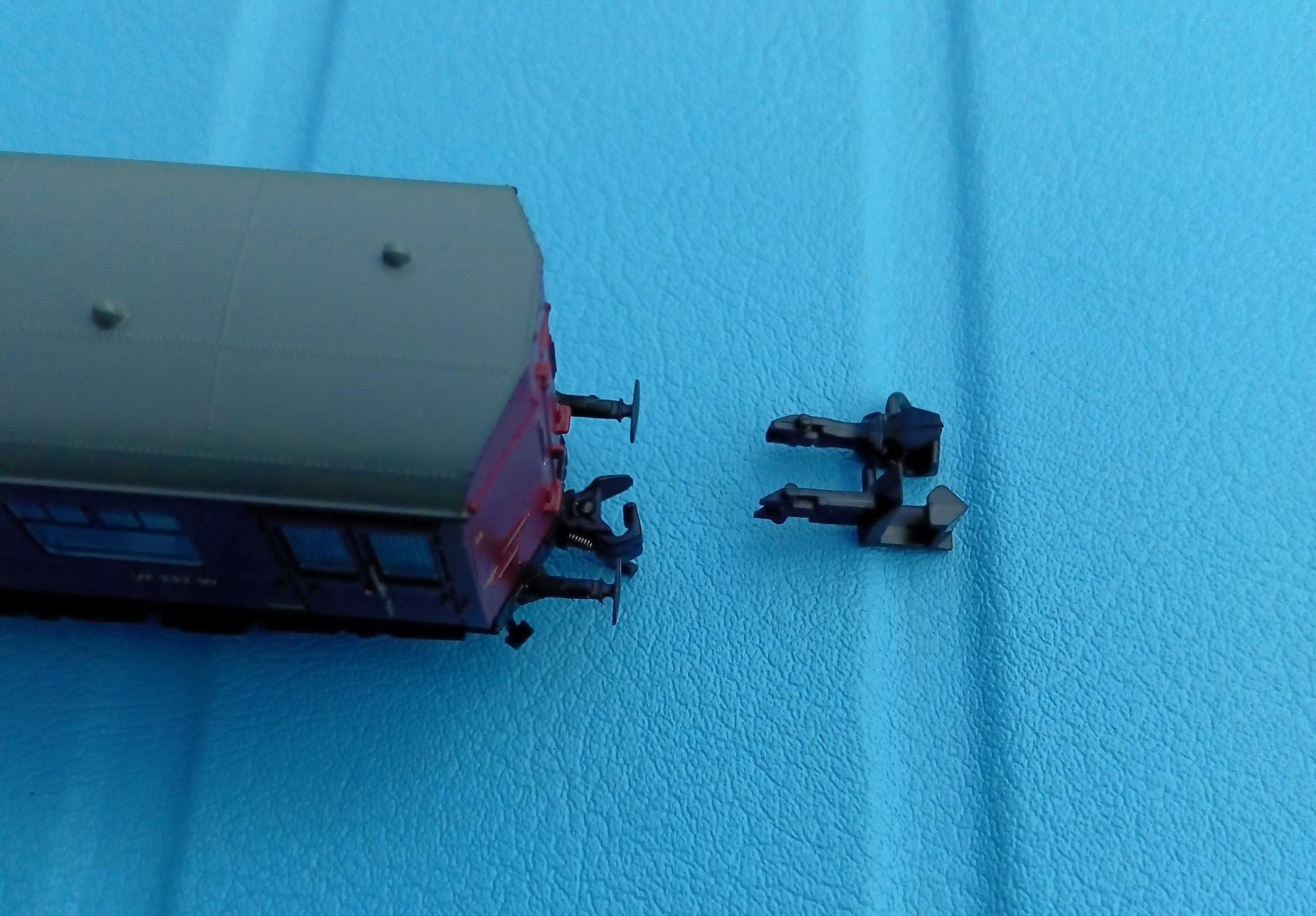

Quote from: D9020 Nimbus on April 26, 2019, 02:33:19 PM
....but I haven't yet managed to fit one to Farish stock with an NEM pocket.
This puzzled me, why would a standardized coupling not fit a standardized pocket??
Of course I believe you but I wanted to find out.
So, out with the boxes, found some Dapol easy shunts and a Farish autocoach.
Fits perfectly.
But the pocket of the Farish coach is open at the back and perhaps that is why it fits.
The back of the shaft of the Dapol coupling extends just a little longer than that of the Farish rapido coupling. Perhaps the pockets on Farish loco's and goods stock are not deep enough to accept the Dapol shafts?
Maybe you could try to file a little bit off the end of de Dapol Shaft and try if it fits your Farish stock? I use different couplings and chop all coupling boxes off my stock so I can't try. The autocoach is still new and hasn't been abused yet  ;)
@WM183  it seems the Dapol couplings are the answer to your question!
I made a photo of the coach and the two couplings, I hope it is clear.
