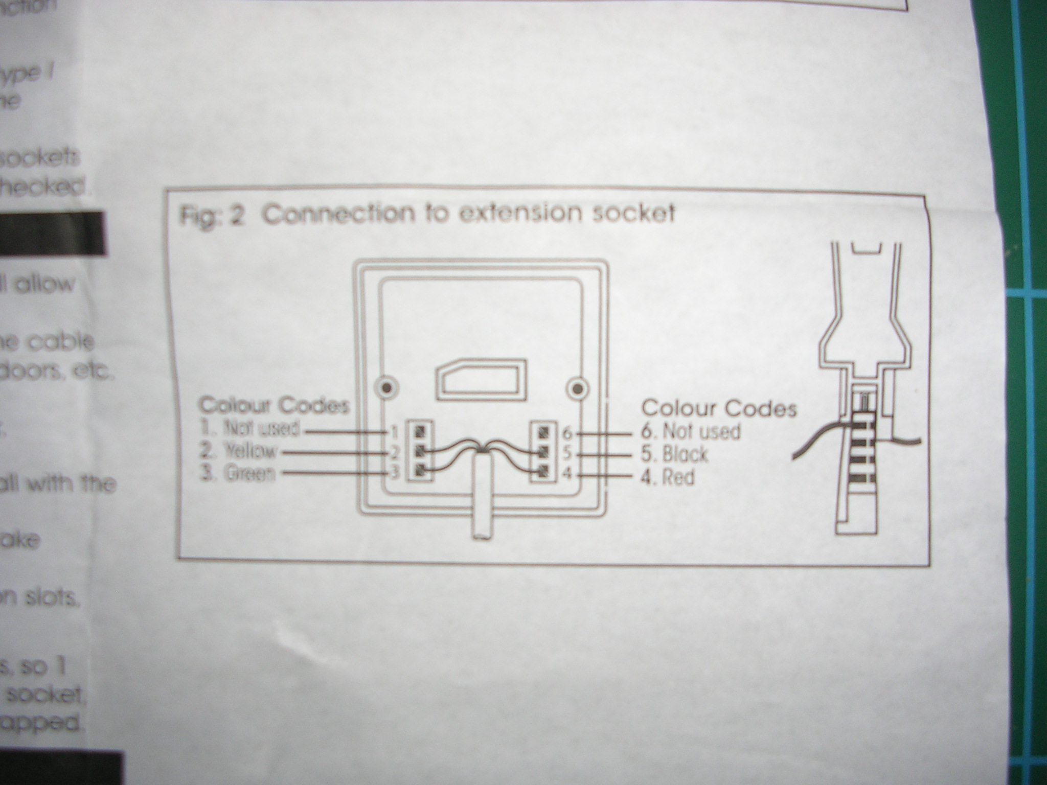

Next you mention a diagram, but we can't see it, that describes the 4 wire cable you have acquired. Standard off the shelf telephone wiring and accessories come with 4 wires, 2 sets of twisted pairs. We'll need to see the diagram to figure out why it's not working.

#2
Your wish is my command,  What's DSL?
In the original socket, only the the green (3) and red (4) are connected.
Cheers, Trev.

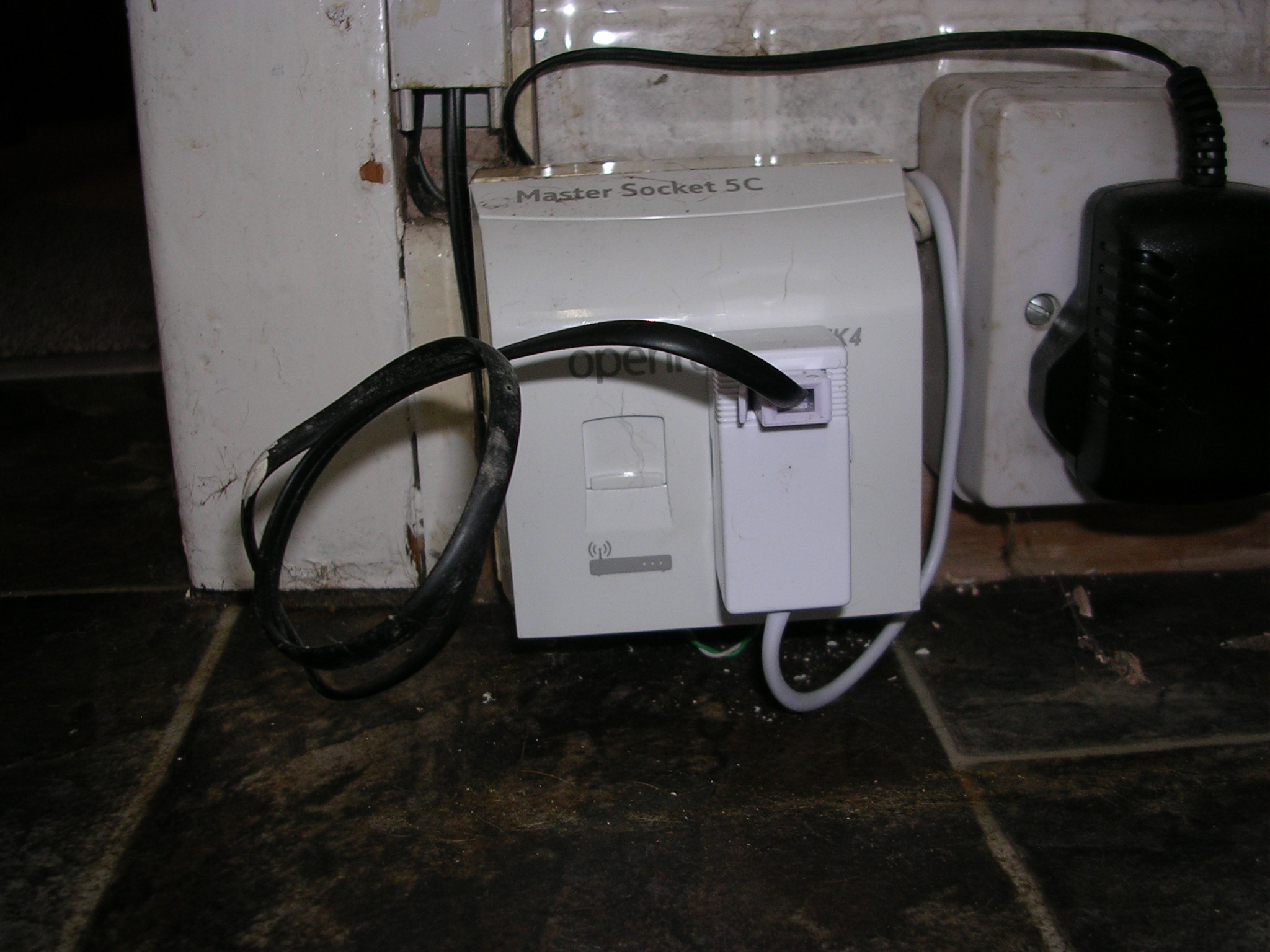

TrevL
This is the master socket. The black lead is the 'phone, plugged into the new extension. The old extension is hard wired into the back of the master socket at the top right.

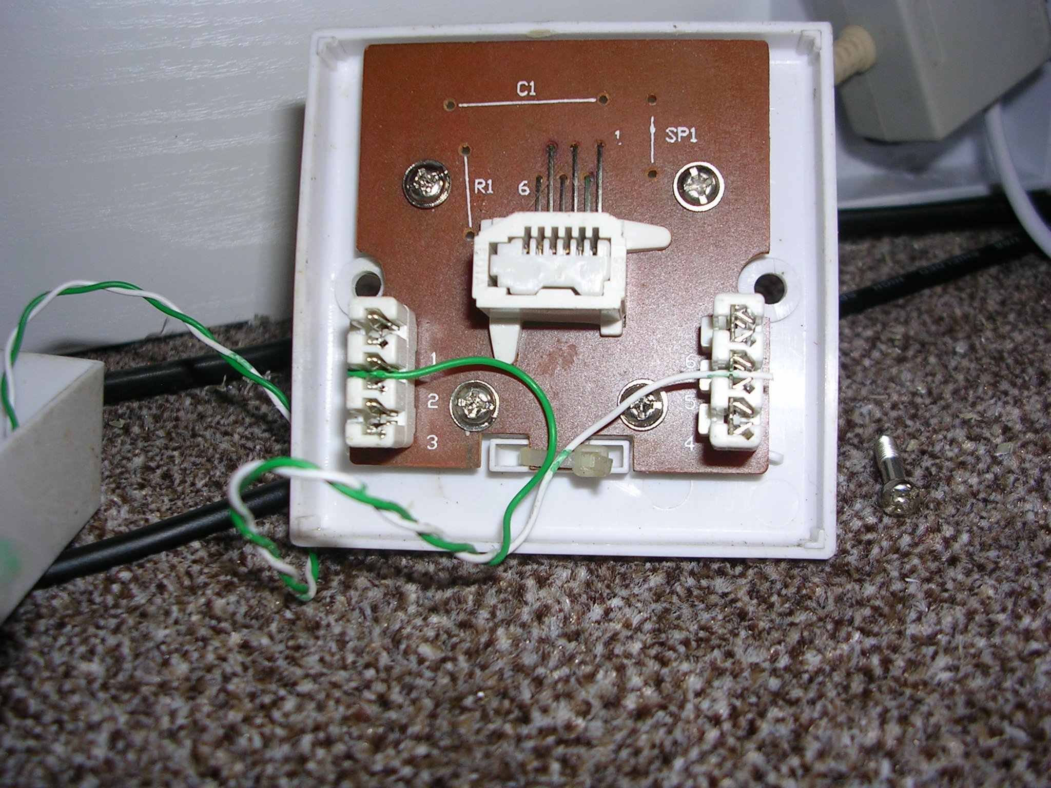

TrevL
This is the old extension socket, which works flawlessly, this is how I'm posting on here.

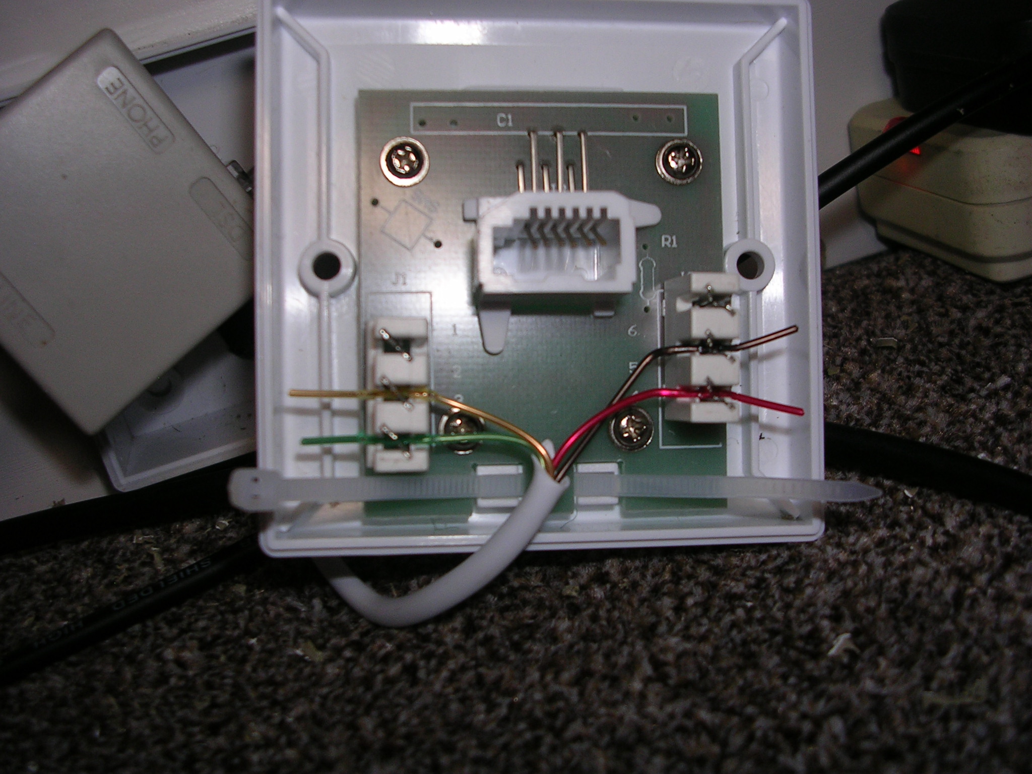

TrevL
This is the new socket, wired exactly as the previous daigram directs. This does not work at all with the router, and I don't have another phone to try it with.

TrevL
#9
I believe (according to YouTube????) ,  that the phone socket in these new master sockets, does not transmit broadband,  and that I must plug the router into the dedicated socket on the left of the master.  This is probably why the new socket doesn't work.   Can anyone confirm whether this is fact or fiction please?

jpendle
Zooming in on the master socket it clearly shows that you need to connect the Router to the connector on the left hand side, but I'm not sure what cable you would need. I would hazard a guess that you would need an RJ45 phone cable to connect from there to the Router.

nookfield
Yes, the master socket will have a built in filter. Your original extension is bypassing that, but anything you plug into the phone socket on the front of the master socket will be after the filter so your router isn't going to get a signal from that socket.
You need to plug the router into the provided broadband socket. Goes back to what I wrote earlier in that the router is best placed next to the master socket.  That's pretty much what you're expected to do these days.
stevewalker
#13
Right, we are getting somewhere. You have an NTE5C Mk4.
If you remove the front cover, you will find a blue connector on the section that remains on the wall. The bottom edge of the blue connector pivots upwards, allowing you to insert cores into it and as you push it down again, it forces the cores between the metal connections, which cut through the insulation and contact and grip the cores. That blue connector is for PHONE extensions only, NOT data ones. If you want to connect phone extensions to it, you need to put whichever pair you are using in 2 & 5, plus one of the other cores in 3 if you need the ringer wire - look in your extensions to see which cores are connected to 2, 5 & 3).
For the data extension, take a look at the back of the front cover that you removed from the master socket. There is a red connector. This works like the blue one, but you only need to connect a single pair. Use whichever pair is connected to terminals 2 & 5 on your data extension socket (yellow and black in your case), the other pair is not required.
You currently have the data connection plugged into the phone outlet (the filtering will prevent it working as a data connection), you need to cut the connector off the end of the extension lead and connect it to the red connector instead.

stevewalker
Quote from: jpendle on April 24, 2019, 06:31:06 PM
Regards,
John P
The standard connector is an RJ11 I think, although many sockets actually have the extra width and pins to allow an RJ45 to be used instead. In this case, the extension can be terminated directly to the back of the faceplate though - as presumably the old extension was done.
