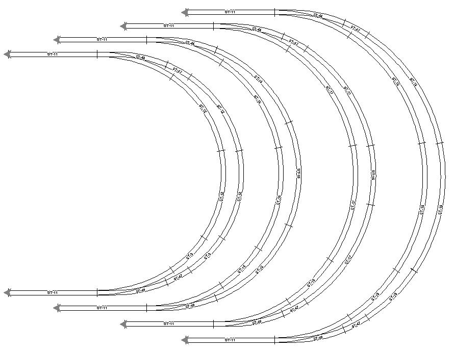

Here is how to fit ST44 and ST45 points into 1, 2, 3, and 4th radius curves using setrack.
You may need to zoom in to see the track section part numbers.
Staggy1970
Cheers John, I purchased an ST-44 today, so I think I'll solve the problem. Thanks again all
