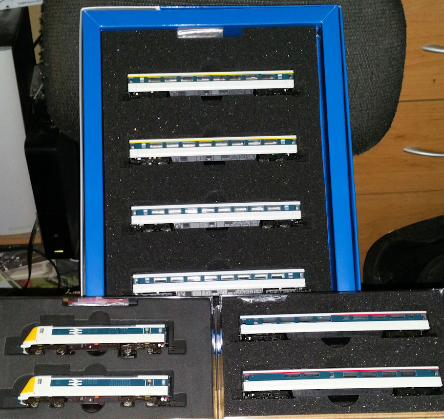

Ditape
The Postie delivered my HST-P set today, I have the Next 18 chips for it so will be fitting them later after running in on the temporary test loop set up for the Class 17.
Diane Tape
Ditape
After running in the power car I could not resist running the full set.
Diane Tape
