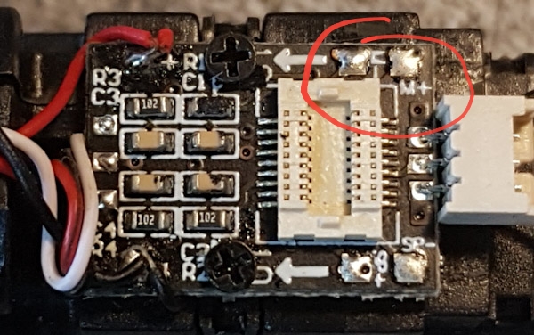

Some DCC help please:
I will be adding sound later this week and want to get the prepararions done before the decoders arrive. I will have to remove a few mm of plastic from the top of the mounting to make space for the longer decoder however I cant find any information wrt the mounting PCB connections.  The speaker connections are marked, so that's not a problem, but would I be correct in thinking the other solder pads (circled in red) are for a stay alive circuit? Unfortunately I don't have a multimeter to check output/polarity/etc myself.
Many thanks in advance

Quote from: Dizz on September 06, 2020, 11:00:44 AM
Pete
You just need to unscrew the PCB and slide it along a bit.  See my notes earlier in the thread about mounting the speaker.
the circled pads are the motor + and -
Dizz
 :thankyousign:
Thank you very much for replying so quickly.
I will move the pcb after lunch.
Have decided to invest in a multimeter to help with wiring in a stay alive.... should have bought one ages ago really.
