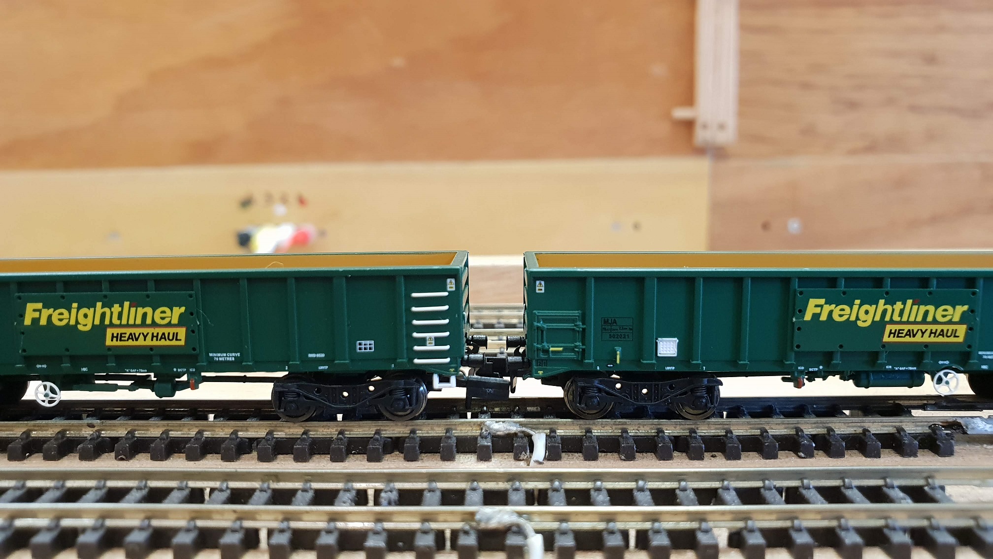

While putting the wagons on the layout, I noticed a few issues with the coupling heights and found one Freightliner set with a pronounced droop, which seemed to get a bit better when I removed the coupling and re-inserted it, but was still a bit droopy. I normally fit the Dapol dummy knuckles to my wagons and the shorter shanks do seem to improve this allot, so when I get around to this I expect that it won't really be an issue.
One thing to note, when you look at a prototype rake of these wagons, there is the same distance between the wagon pairs as there seems to be between the pairs themselves. It seemed to me that the visual distance between the pairs was pretty even, but when I swap out the Rapido couplers this will look more pronounced so I think I will definitely have to shorten or replace the drawbars.

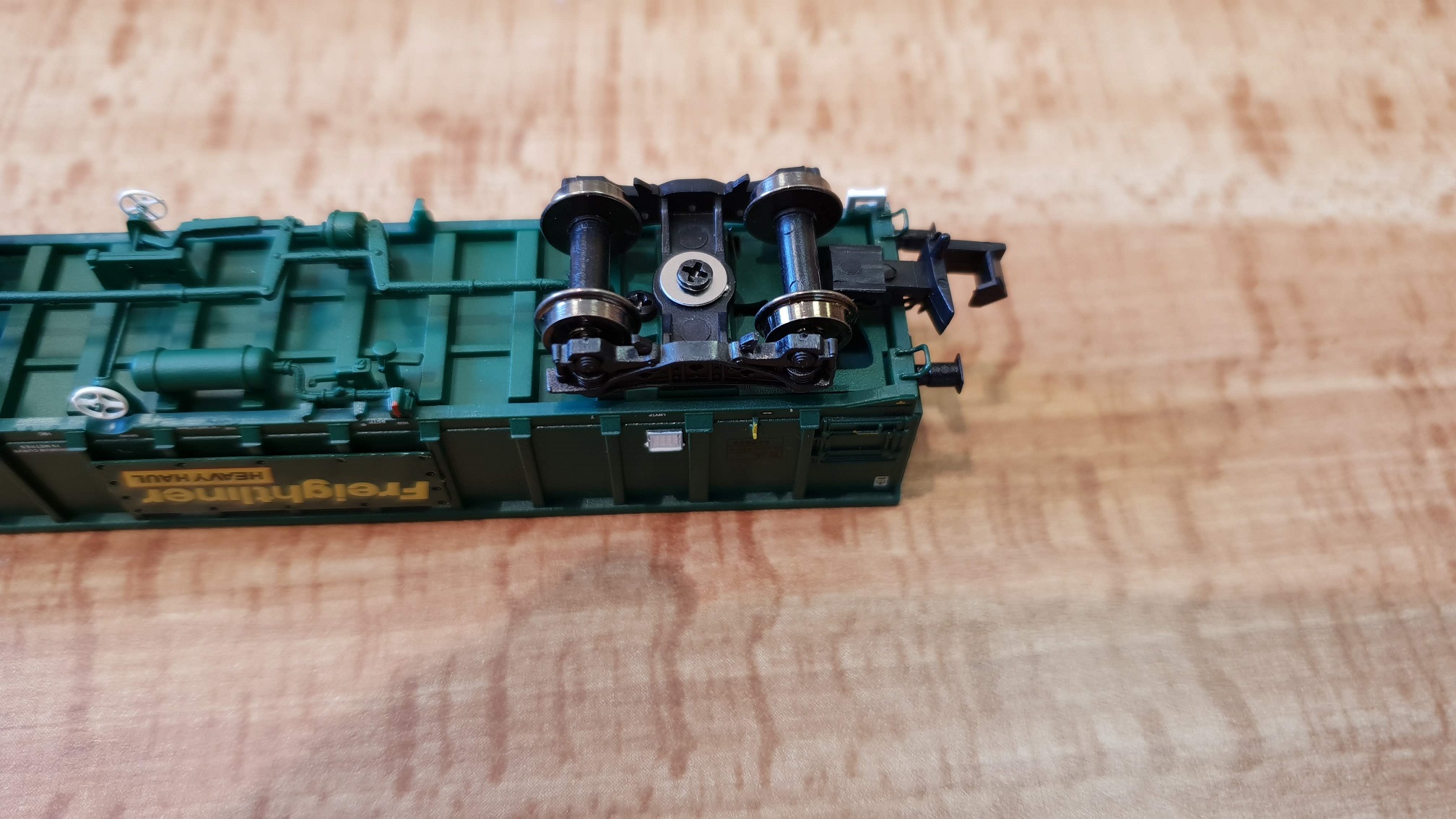

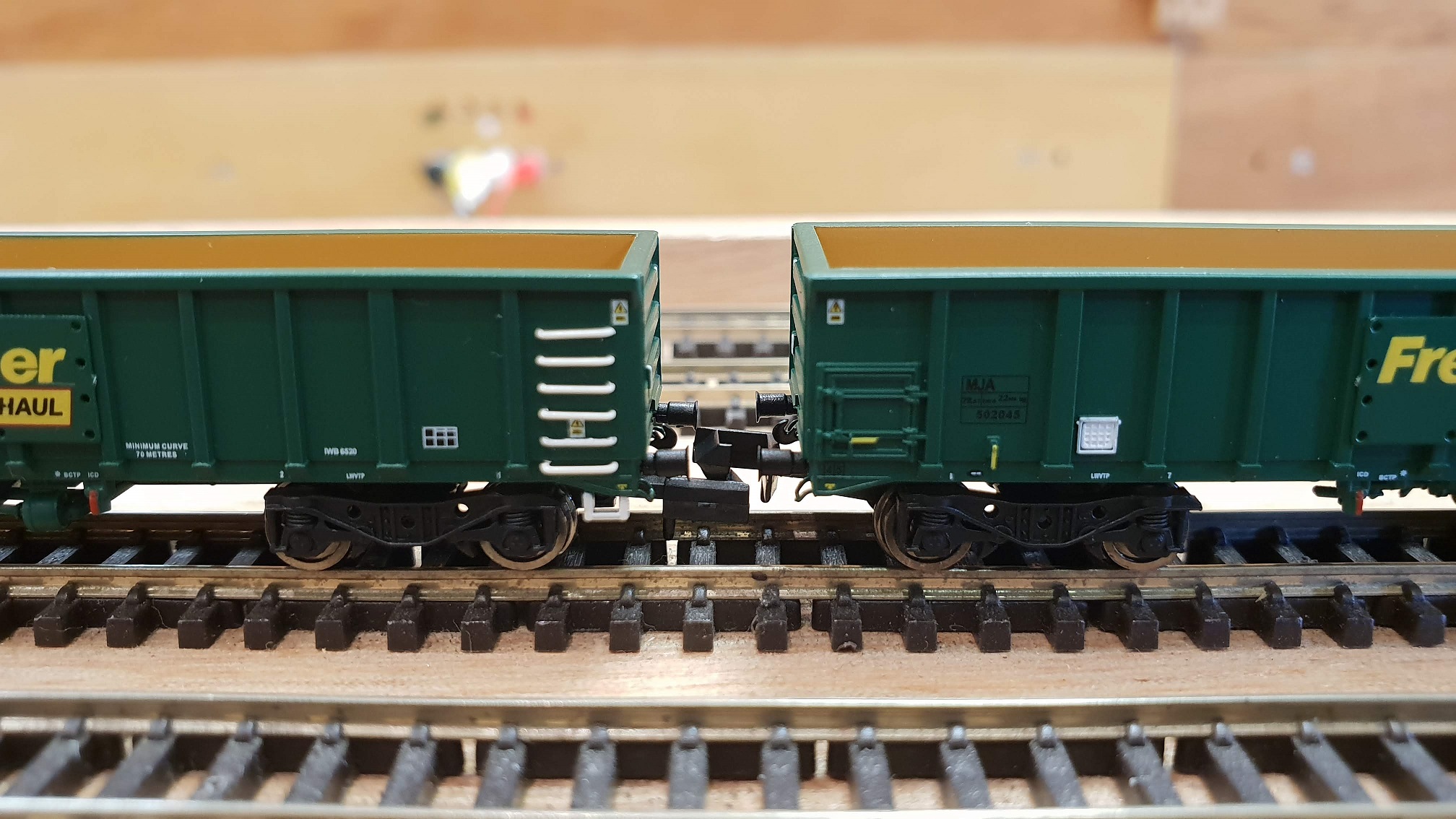

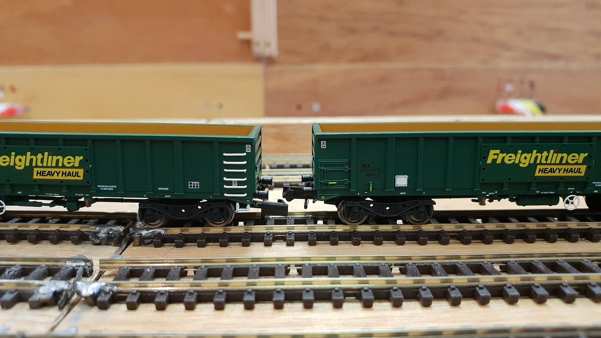

This picture highlights the issue, if you look at the brake pipes running towards the bogies, you can see the one on the left sits higher off the chassis than the one on the right. This makes the pipe rub against the wheelset as it rotates and because the axles seem to have a bit of moulding flash in the centre, it can catch making the wagon wobble.
All you have to do to adjust the pipe, is gently push it down with some long nose pliers. Here are some closeups:
Before:
After:
I've also included some video to show the affect on the wagon before and after the adjustment.
https://youtu.be/tn8Ohn2WMxo

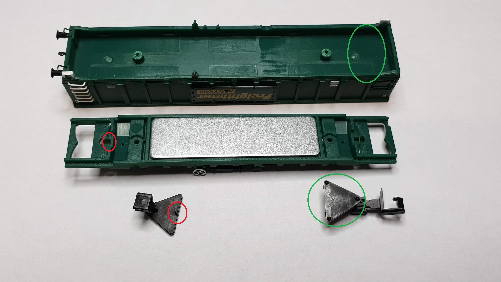

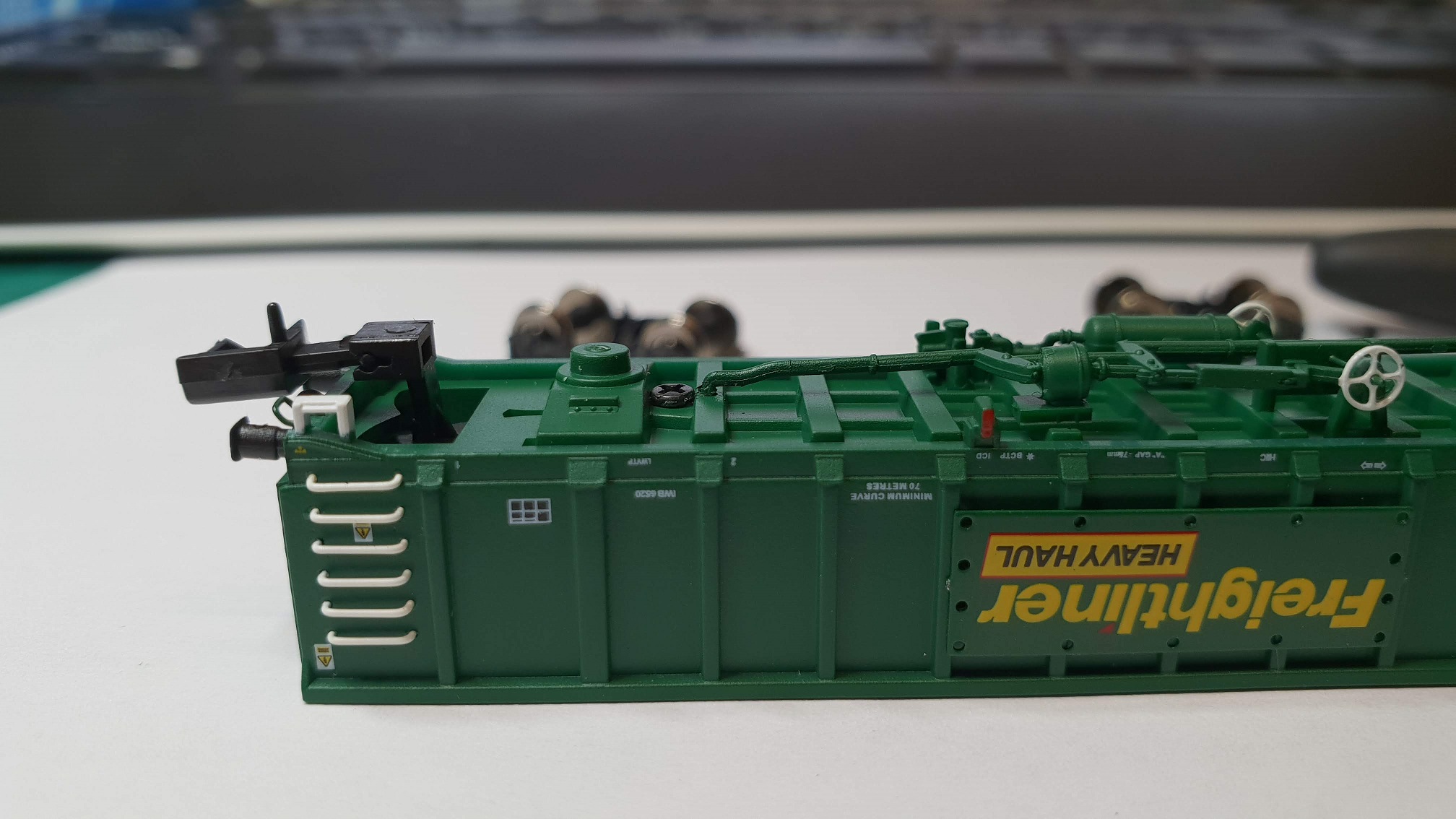

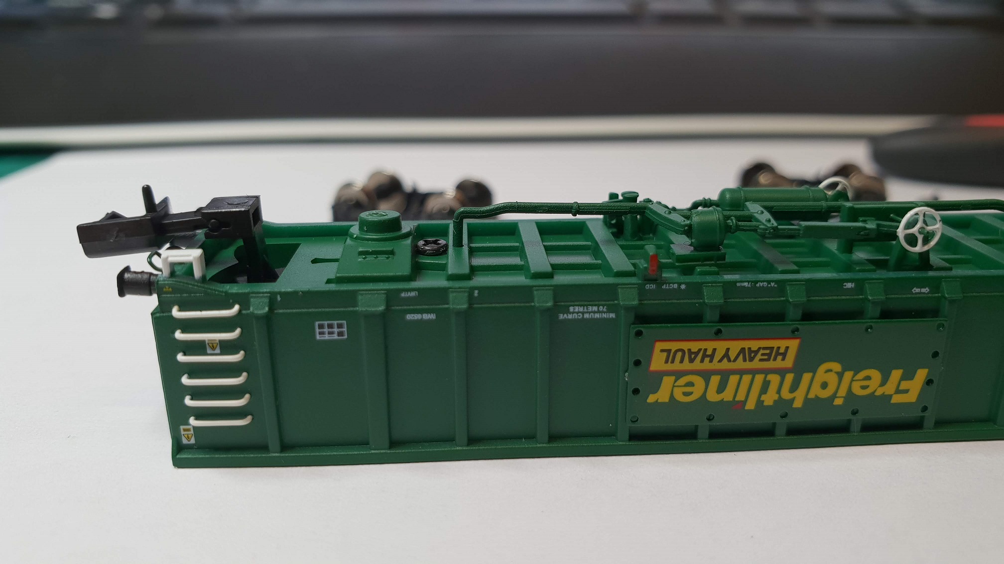

For anybody wanting to know what the wagon looks like dis-assembled here's a few picture
I was expecting to see a spring attached to the couplers, but there just seems to be a bit of flexible wire, the red circles show a pip on the coupler arm which locates behind the wire and this centres the coupling. The green circles show how the upper side of the arm sits flush with the bottom of the wagon top. There isn't much to go wrong here, so if a coupling is droopy, then it might just be a simple case that the underside of the wagon hasn't been screwed down enough, or something is misaligned inside. Either way, they are easy enough to get into and investigate.
Cheers, Mark.

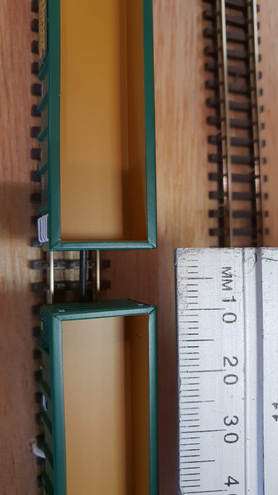

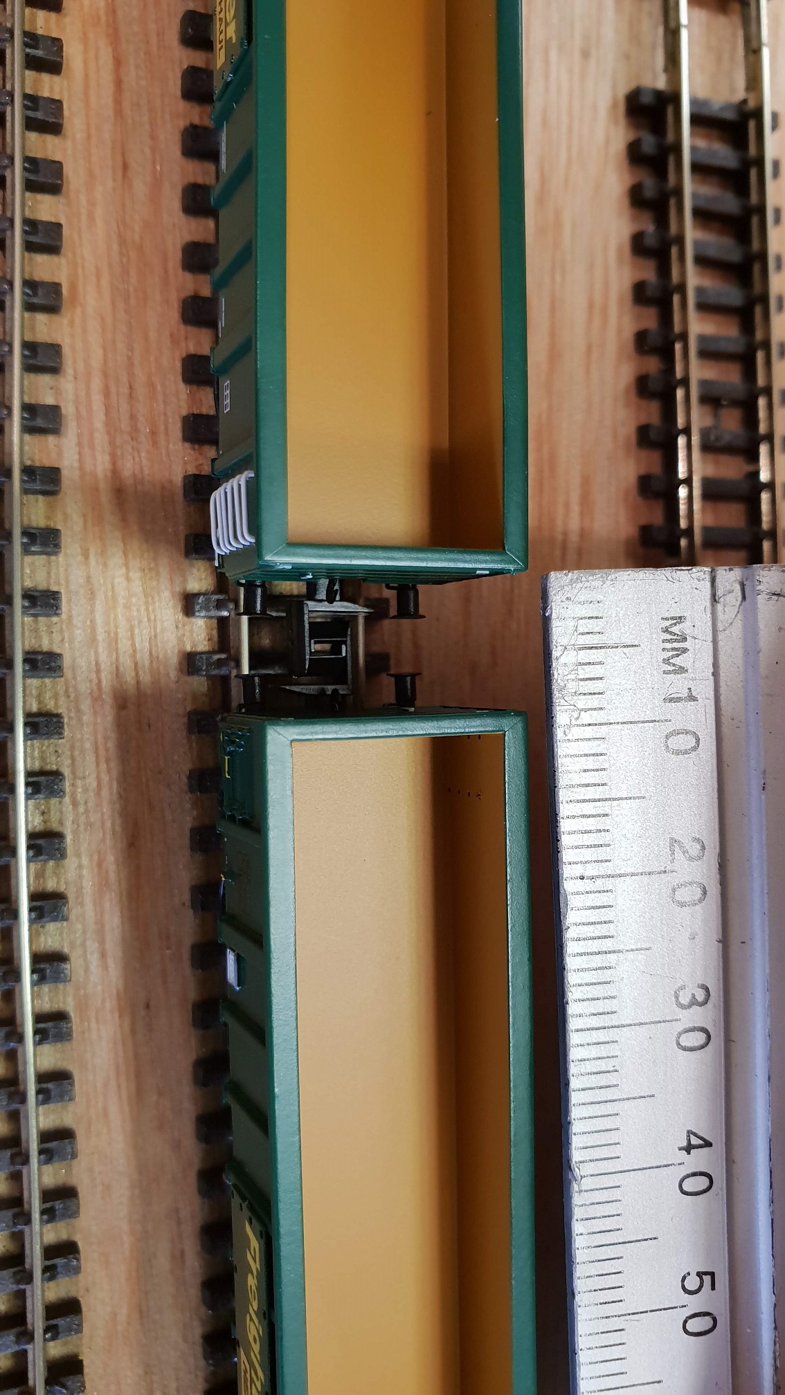

thanks @Vonzack for the tip re the screws, have checked mine and a couple were loose.
Have also tried @njee20 tip re the long and short knuckle couplers and to be honest whilst they look good, it makes the bar between the wagons look way too long, so have returned to long knuckle couplers on both ends of the wagon pair.
Have run them for another hour today with no issues. they are a lovely looking model.
That's a shame - and exactly what Vonzack feared would happen. Shame they've not provided shorter drawbars, like they do with the IKA/FEA pairs. I guess it all helps keep the cost down, which they've done a great job of.
Vonzack
At the moment, I've swapped the drawbars for a combination of long / short knuckles so the gaps match. I usually store wagons in foam trays, so it's a bit better for me to have them like that.
