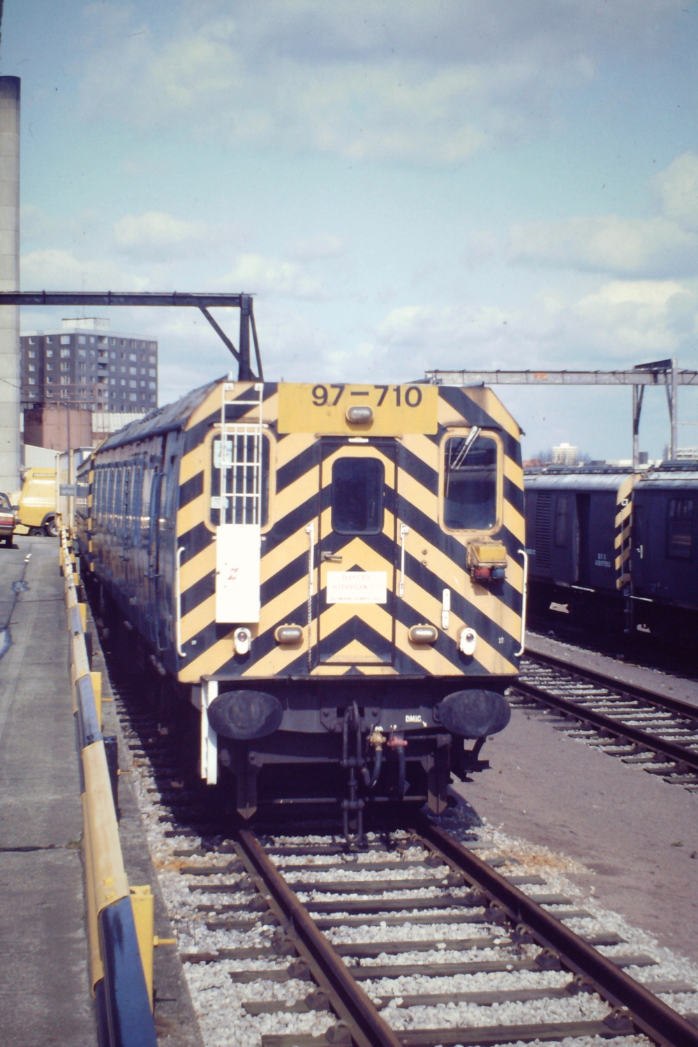

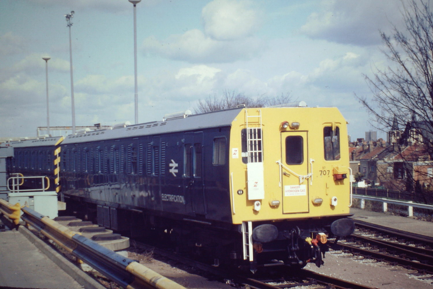

70000
A couple of photos I took of them in April 1983 - I think they were at Hornsey......
it is hornsey

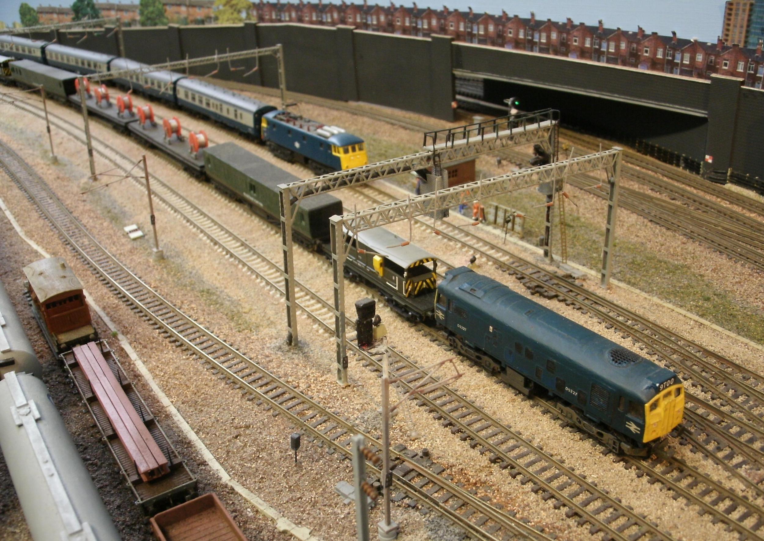

Hi
Keir Hardy has a pair on his layout Hornsey Broadway.
http://www.emgauge70s.co.uk/model_omwb145.html
Paul
